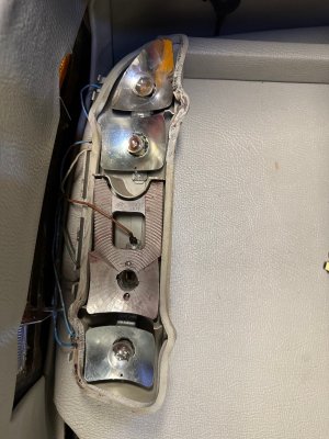

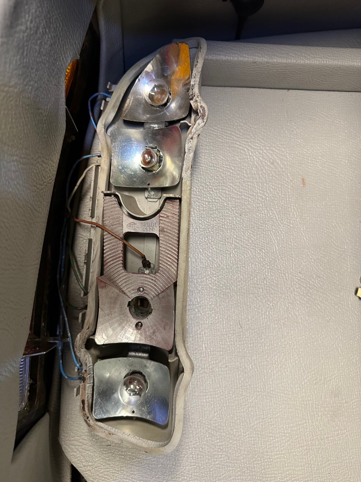

However this did lead me to discover that my lamp housing on my passenger side (US) appears to be bad. My right brake light is intermittent working only as I wiggle the housing. I even ran a fresh cable form left light to right and still no go unless I wiggled the lamp side spade.

If you look at the housing you’ll note that the ground path only connects to one half of the lamp housing (the inner two sockets). The brass strip on the trunk side of the housing connects the two halves together. If you notice how that strip is attached, you can see how there can be a failure. Cleanest solution is to connect the two halves together inside the lamp housing essentially eliminating the reliance on the brass strip.

Update for future searches. Problem fixed now. The spade connectors are almost like a Z with the connector side on the outside of housing and the bulb terminal side on the inside. Then plastic housing had worn down causing the spring fit of the bulb to just push the terminal away from the bulb. I did small layers of crazy glue over two hrs to seal the connector back in the housing. Not sure how to crazy glue will hold up in the heat but for now the fix is working.
