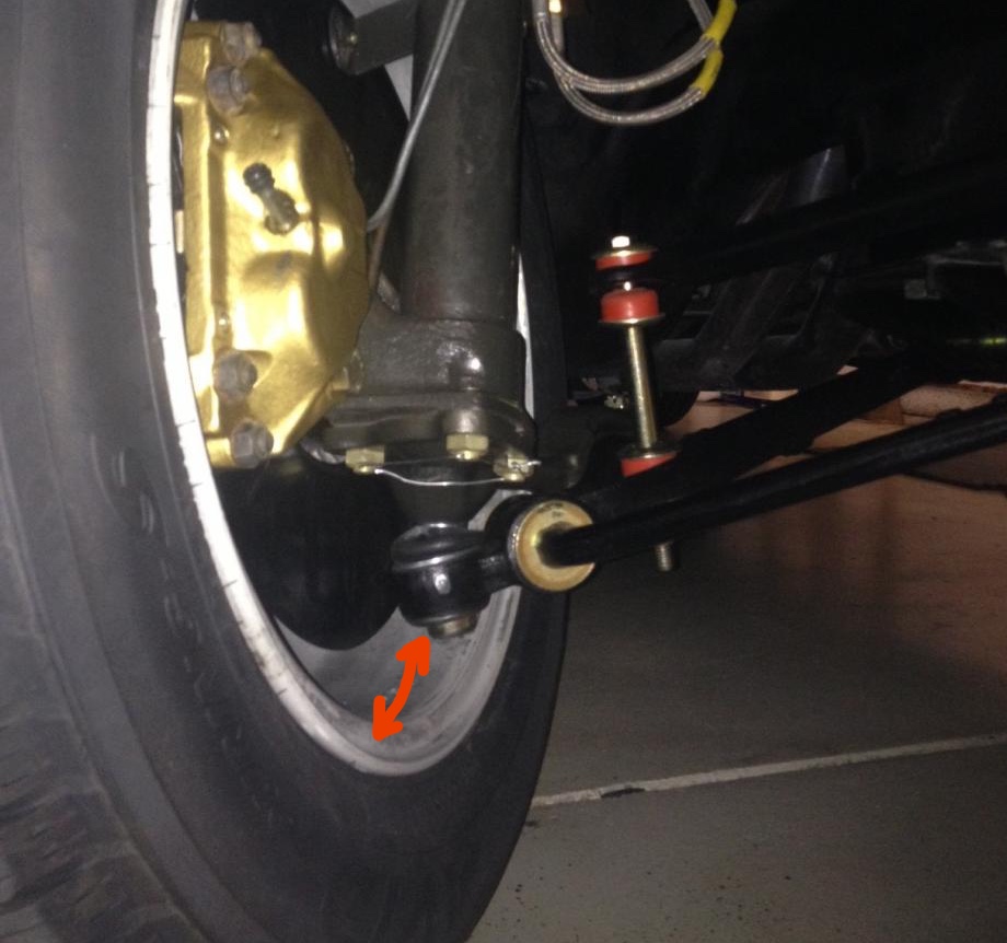

I realized recently that the 1/2 inch spacers I have from AKG came with M10 bolts, but my struts are M8. I'll have to work out a sleeve to continue using my M8 bolts through the M10 hole in the spacer
Does anyone know when the change from M8 to M10 at the bottom of the strut occurred? Assuming my struts are original, it's an early US 2800CS.
Regarding the max size of spacer it's dependent on the wheel diameter. With my 14's I don't have nearly the space Gransin shows above, I am assuming those are 16's.
With 14's I could possibly get a full inch spacer in there but no more.

I was looking at RealOEM in connection with the possibility of selling an extra tension strut I have laying around the garage and I noticed that BMW made two different tension strut/wishbone combinations for our cars. When I saw this, I was reminded about Barry's discussion with Ground Control (above). I'm no expert on suspension geometry, but based on the Ground Control guy's comments, it seems to me that one of these combinations should be preferable for a lowered e9 in terms of the bump steer problem that is the subject of this thread.
I'm not chasing this particular issue right now (I have other stuff I need to fix), but thought I would post this in case folks here want to consider an alternative sized setup and see if it addresses the problem.
