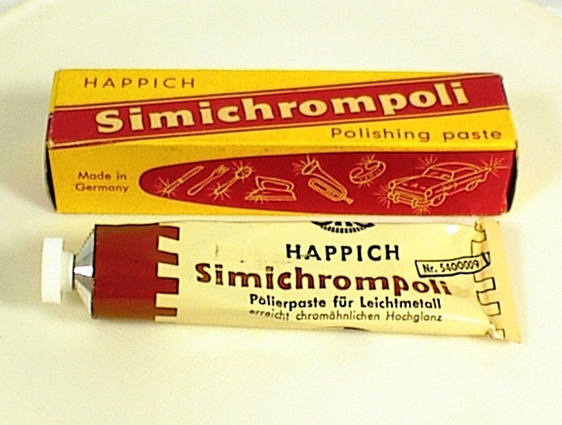

Mostly, I use Simichrome
I've also used Simichrome for decades.
Made by Happich in Germany, btw.
