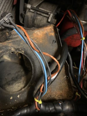

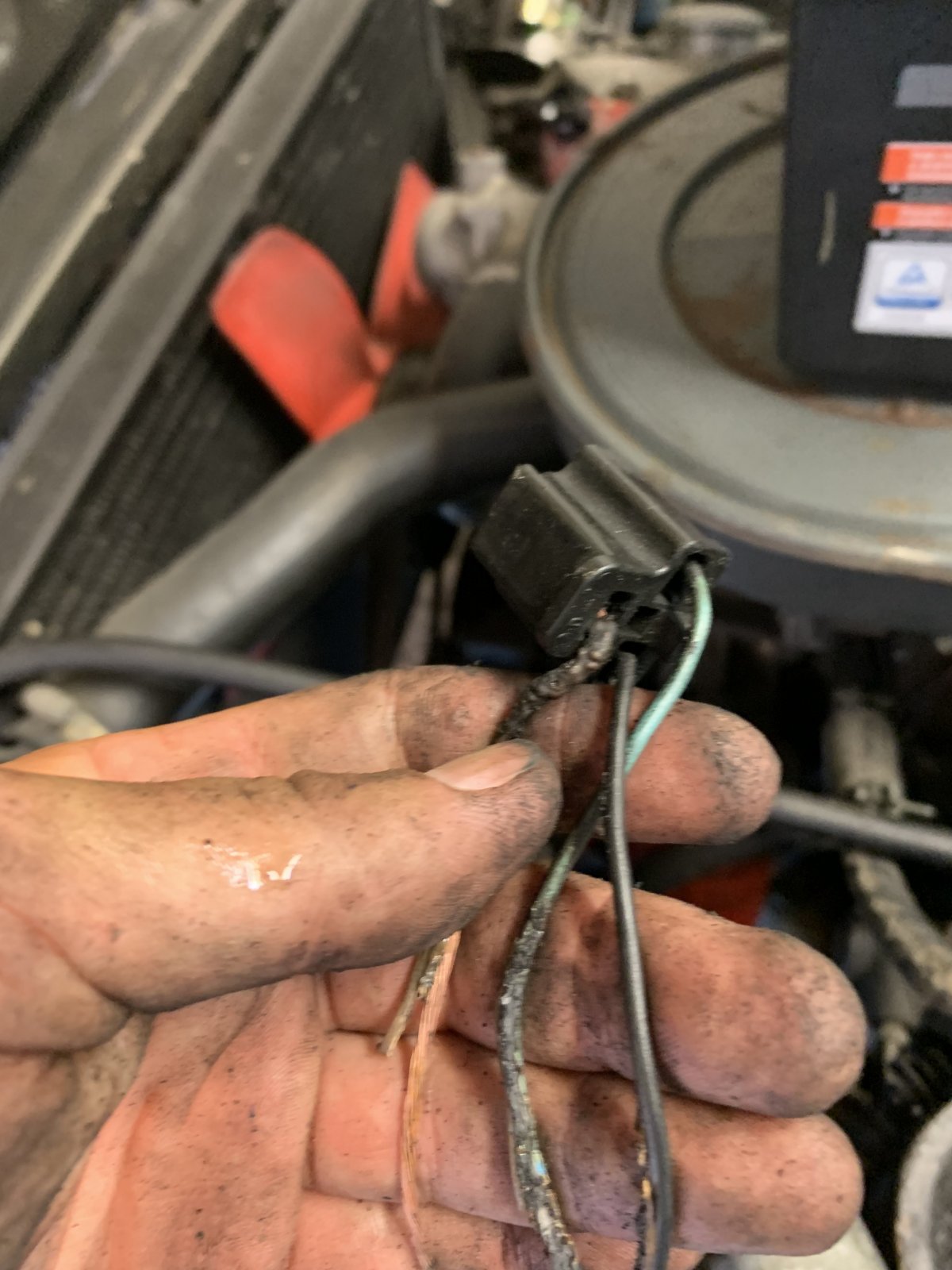

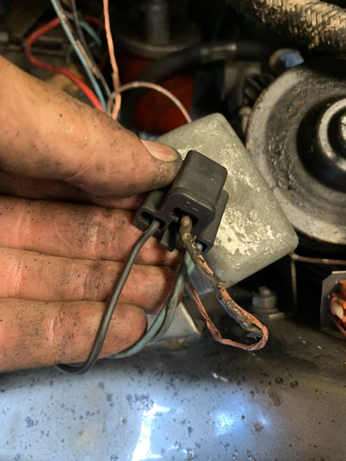

After two weeks with my 2800 cs 1970 stopped. The other day I tried to start it and even having the new battery recently changed it seemed that the starter motorcycle had a hard time turning, after several attempts smoke began to come out under the hood.

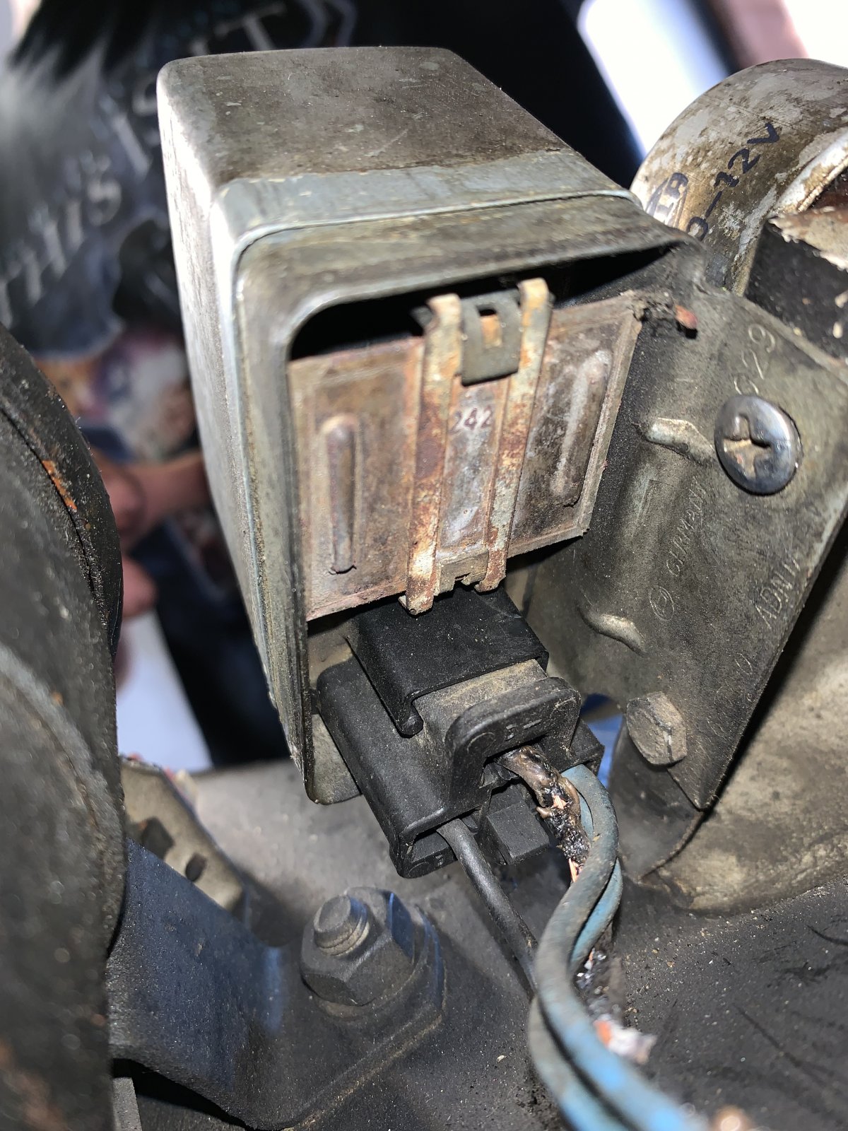

The ground wire connecting the alternator to the voltage regulator (the little silver BOSCH box to the right of the two round relays on the right under the hood) was completely melted.
The car won't start and I thought the wires had come together and created a bad contact.
This morning I have dismantled all the wiring in that area and I have replaced the ground cable with a new one with a slightly larger section (it was the only one I had on hand).
After trying again to start the car (already with the cables changed) they have melted again, specifically the cable that connects the alternator with the voltage regulator.

What do you think could be happening?

Maybe the voltage regulator is wrong, I could start there, the problem is that the car doesn't start and I can't make voltage measurements with the engine running, it's as if the spark plugs don't get current, at least that's what it seems.

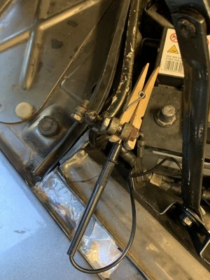

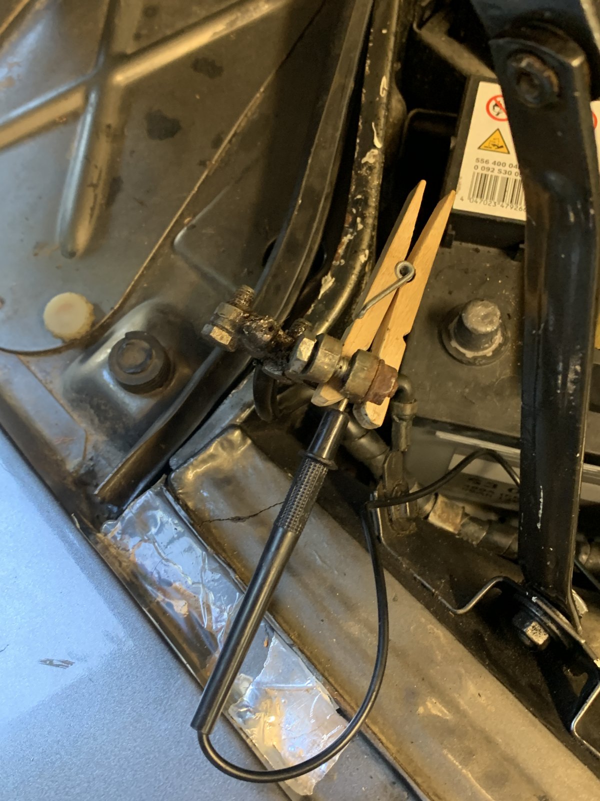

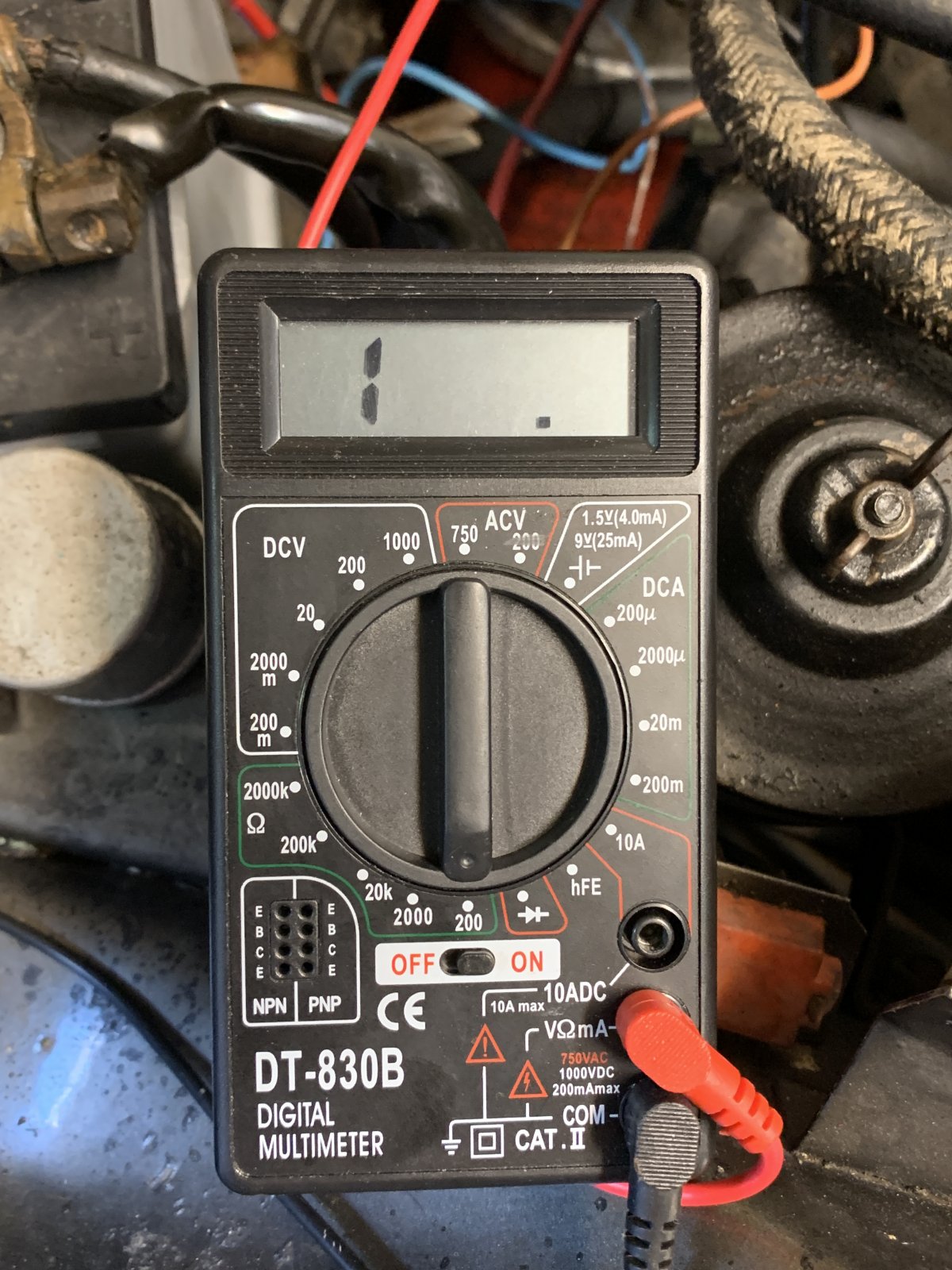

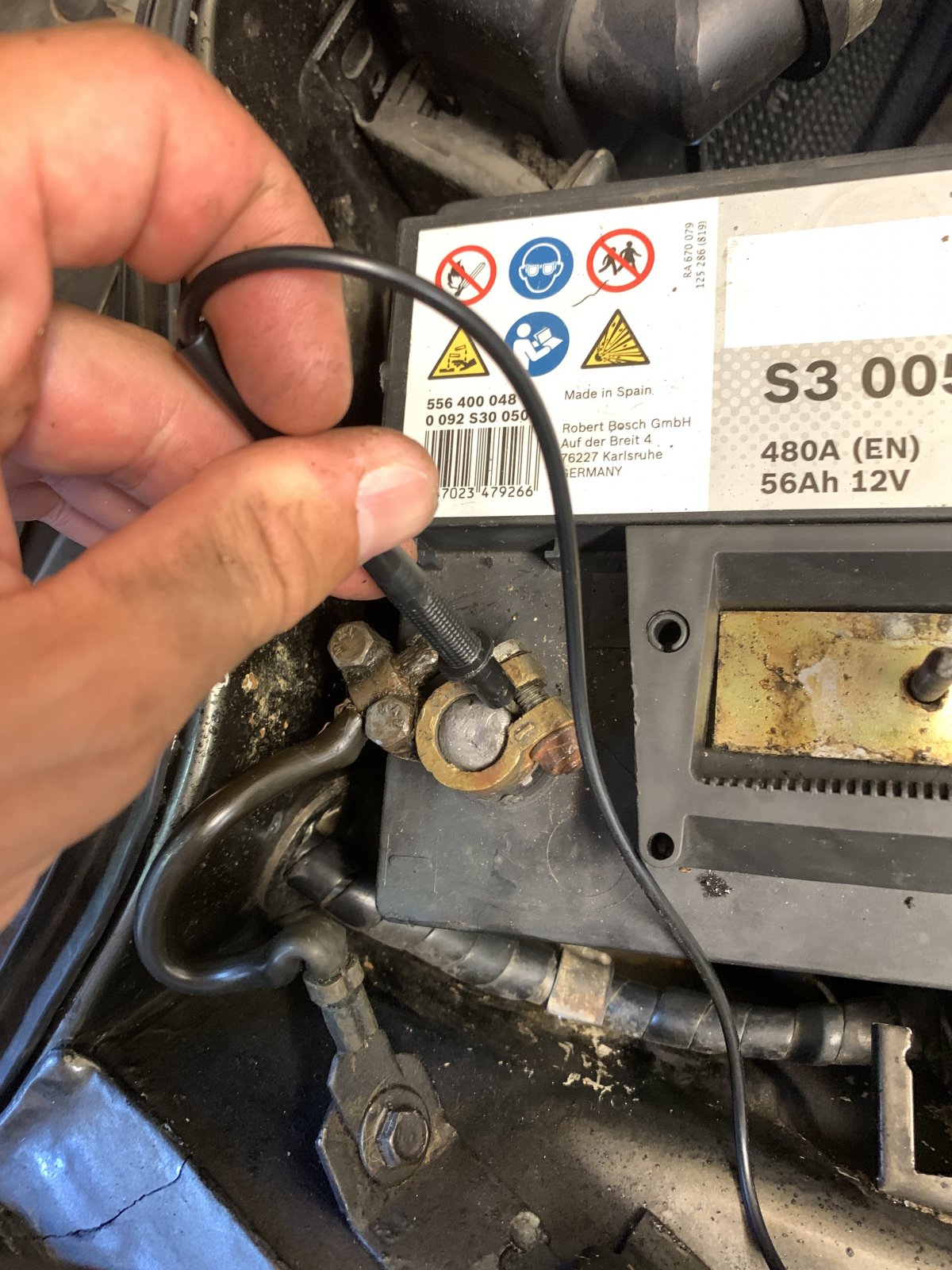

I suspect your alternator has a shorted out diode. If you disconnect the big red wire that goes to the alternator bolt (the one covered by the black rubber boot) and then take a resistance reading from that bolt on the alternator to ground with your voltmeter, it should read infinite ohms (open circuit). See what you find out.

I will do so this afternon....
Few questions:
1.- How to disconnect the big red? do you simple remove the black rubber boot and unbolt...
2.- When yoy say "to ground" do you mean to the chasis, for example?
3.- If the voltmeter read infinite ohms, What does it means?
4.- What other options could the voltmeter read and what would it mean then?
Thnak you in advance
Disconnect the ground pole/cable from the battery before you do this or anything electrical.
1. Yes remove rubber and take the nut off and remove the wire from the alternator.
2 chassis yes. Or the metal case of the alternator. The case of the alternator should be grounded so they both should give you the same result.
3. Infinite resistance (ohms) means that the positive and the negative ( ground ) are not connected together which is what you want. You don’t want the negative and the positive connect that together…
4. Anything other than open circuit (infinite ohms) is not good. It could be zero or very close to zero.

It seems to be an open circuit.
These are the pictures with the result of the test:
Now what should I do? What could I try new?..
