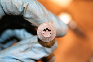

I replaced those bolts and nuts that were available new from BMW or Walloth, but on the rear calipers, either the short or the long ones, I forget, are impossible to find so I reused them. They are an extremely odd size, either 7 or 9 mm. In the E3 at least, the rear caliper bolts have a Ribe style head which is like Torx but not exactly. You need to watch for damage or buy a Ribe bit if you plan on re-using them. They look like this;
I also have had several conversations with Eric at PMB and as long as the bolts are not rusted and there was never any evidence of other damage, they can and are reused. The manual says the fronts are torqued to 33-40 ft-lbs, rears 16. Eric recommends staying right at 33-35 as I spoke with him about these specific CS front calipers.
Also my fronts (2800cs non vented) have the Ribe style heads as do a set of front calipers I have from as 72CS (vented).
