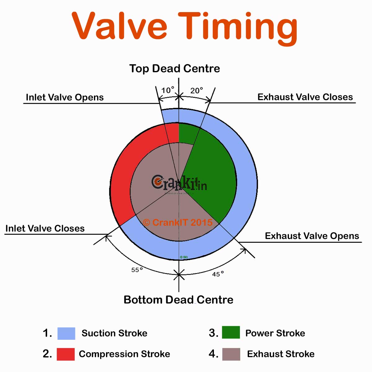

There are effects in a running engine that can greatly affect the amount of mixture in the cylinder, pressure waves in the intake manifold and exhaust scavenging that take place in certain rpm ranges while the engine is running. The intake valve opens before TDC, and at that point there is no suction due to the motion of the piston. All motion of the mixture is caused by the suction of the exhaust wave at the open exhaust port (scavenging), and the pressure wave present at the now opening intake due to the design of the intake manifold. None of these effects are present when you are testing for compression, and the gains in compression due to the early closing of the intake valve will far outweigh the loss at the start of the cycle. If you look at the valve timing cycle picture here, if you had a tappet loose enough to cause a 20° delay in opening and 20 ° early closing, there is much greater displacement of the piston on the end of the intake cycle than on the beginning. If you were to calculate the motion of the piston from 10° BTDC to 10° ATDC it moves about 0.8mm up and 0.8mm down. The same 20° at the end of the cycle has a piston motion difference of about 11.9mm. The piston moves about 15 times as far on the compression stroke due to the delayed valve opening, and this effect will be very noticeable.
