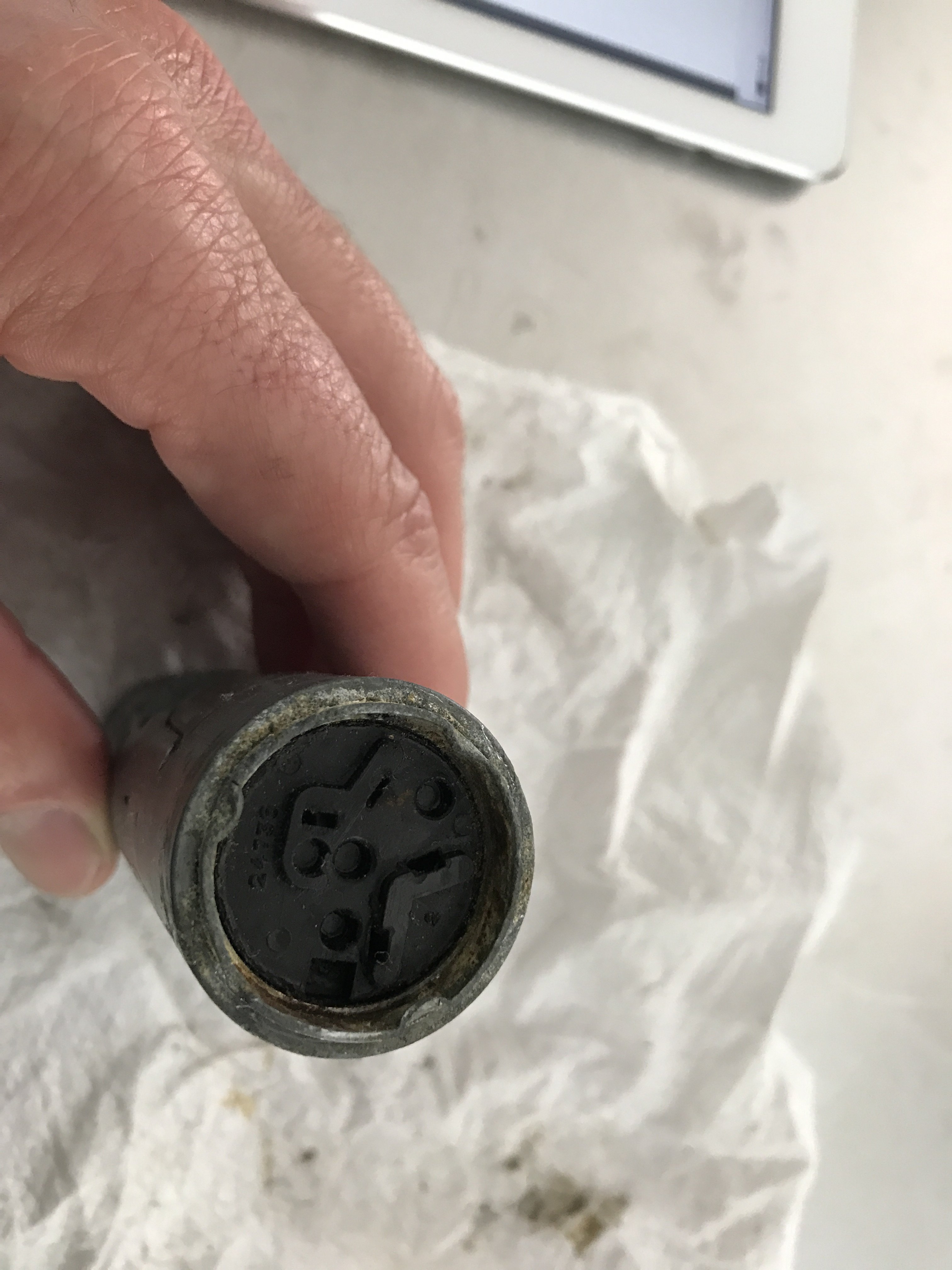

Ok, so i was able to remove the ignition assembly, "the tube" as a couple of people referred to it. I want to remove the ignition switch and the key cylinder. I have a feeling the internals of the cylinder are damaged (intuition), and since I don't have keys to begin with, do you replace the intire assembly and en up with 2 different set of keys? One that comes with the new ignition, and one for the doors from re cut using the code on the locks.
Thoughts???

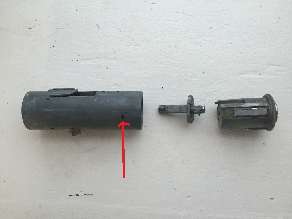

No need of the key
Just push thin rod in hole as shown on photo below, pull lock outside and it will come off. On photo it is shown broken ignition, in your's if it is all ok you will only have two parts (ignition housing & key lock).
p.s. you will probably have some mess with assembly your ignition back, because rear part with cables, little springs & little metal balls left inside.

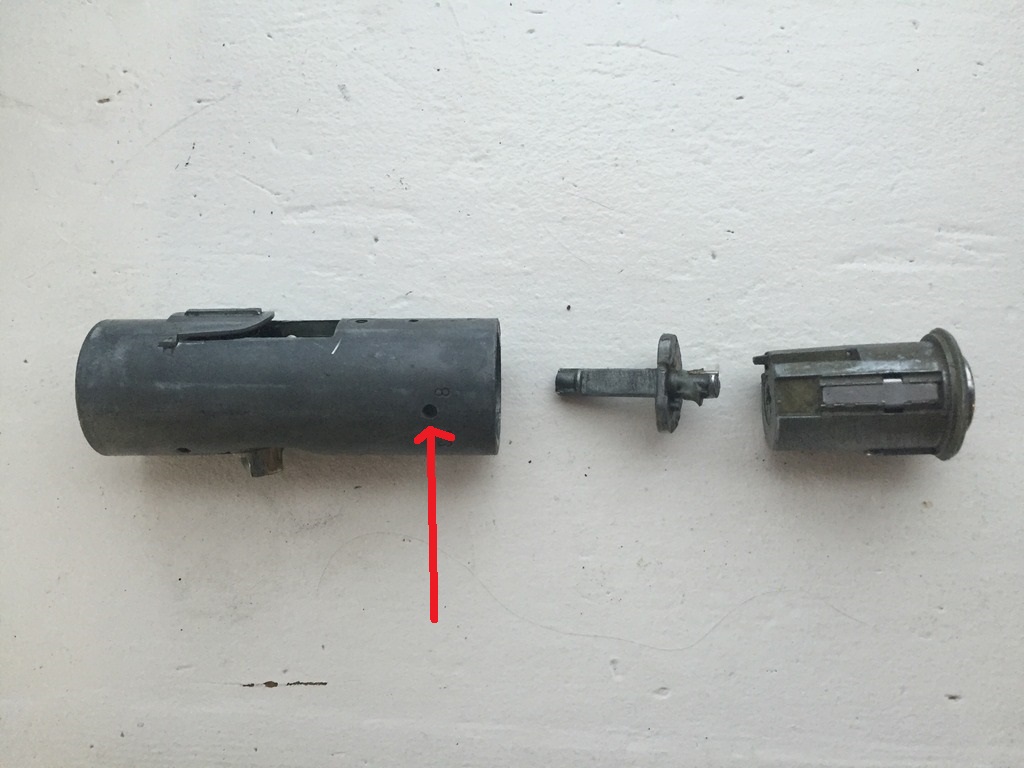

No need of the key
I will give that a try today.

Looks like someone got there before me, and the cylinder possibly turned, as there's nothing to push through the witness hole. And the fact that the witness hole is chipped off.
