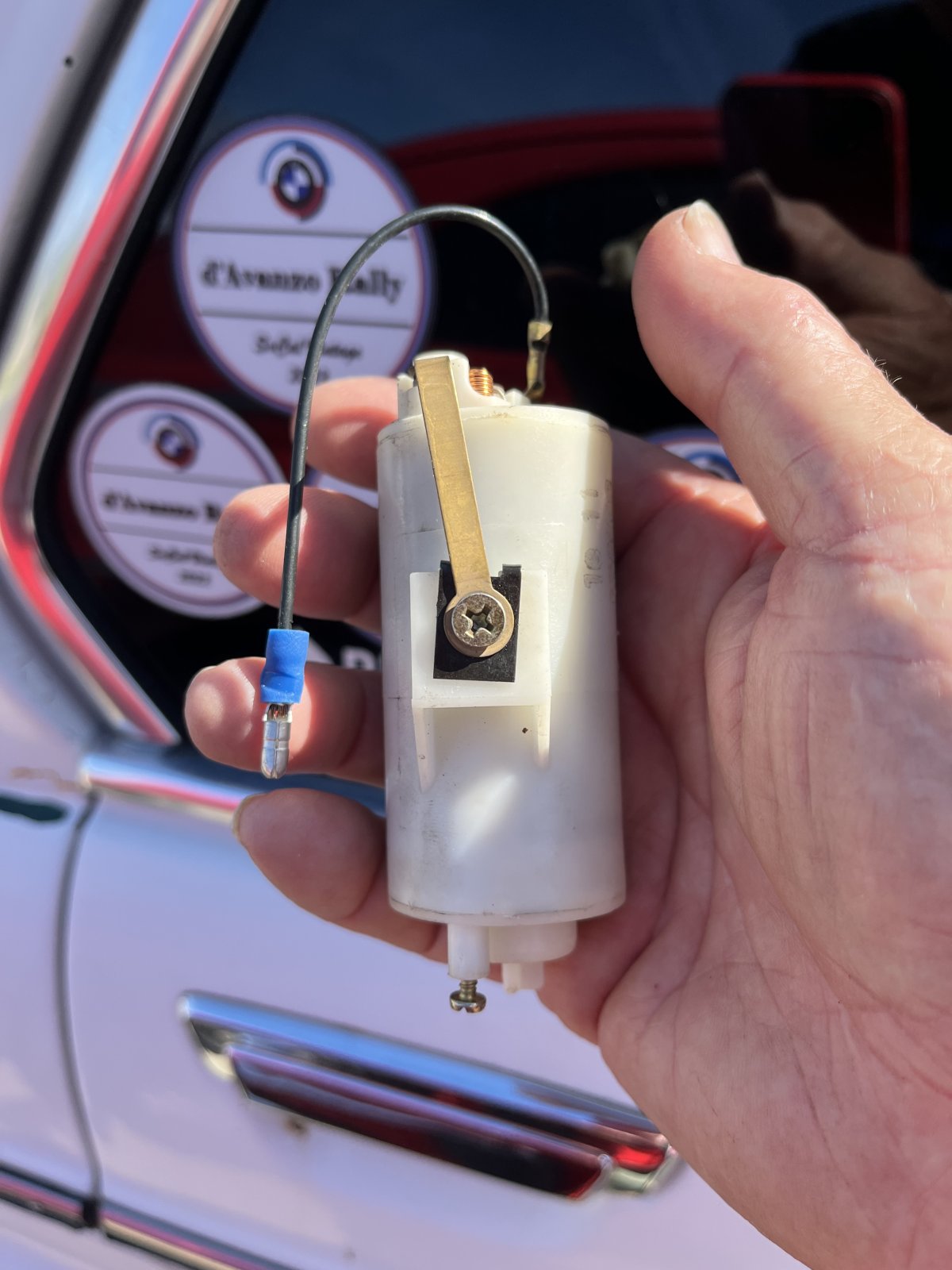

after 6 months of sleep I charged the battery and took the 73 for a ride it rode fine plenty of pep put a smile on my face. As I was leaving the grocery store at the light the car choked and cut off. Some young guys helped me pushed the car back off the street into a parking spot. By coincidence a car meetup was going on around me. The young guys were excited for me to open the hood of this 2002 or whatever it is. Now come class time I opened the hood and pulled off the air filter with just two nuts and viola two carbs. They all leaned in as I showed the car's simplicity. We took a hose a loose and I cranked no fuel came out. I showed were the fuel pump was and took the output side hose a loose and cranked the car again no gas.. My daughter picked me up and took me home and I took the fuel pump off of my 71 with a 3.3. I put it on my 73 at the parking lot and after some cranking the car started and ran well. By the way the bad fuel pump was only 2 years old.

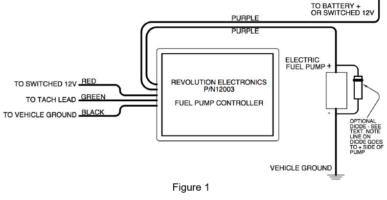

I changed to a Pierburg electrical pump, and I carry a spare fuel pump with me. I also installed the pump where I can access it laying on the ground and installed a set of pigtails so the electrical part of it is easy.
I ran a completely separate wiring circuit, but I had installed a distribution block under the rear seat for my Schrott Harness inertial reels. I also installed a Revolution Electronics fuel pump controller, which is wired like a relay (with a safety circuit that shuts off the pump if the engine is not running).
