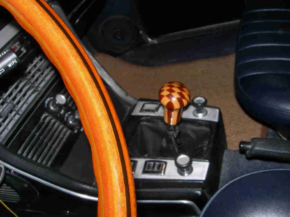

I can't be sure about the the fuel savings with a 5 speed but it seems reasonable. I have a Getrag 265 5 speed and around town I get 17-19 but 18mpg but on the highway I get 26-27. My E3 with a 4 speed never got above 24mpg but the CS is a bit lighter, more streamlined, and I have weber 34/38's. I also tend to be a tamer driver these days. However, I tend to attribute my good fuel economy strictly to my shift knob. :twisted:
