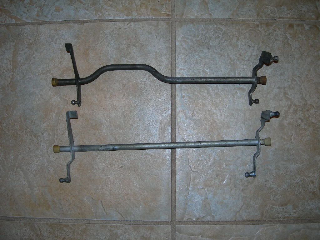

linkage
Can Mr. Jacobs be more specific about "Weber linkage?" Only thing different from the Zenith linkage I use with my Webers is the straight shaft between the carbs. Seems to work OK, but it is very hard to open the secondaries, and it is even harder to go over center just by pushing the pedal...
Can Mr. Jacobs be more specific about "Weber linkage?" Seems to work OK, but it is very hard to open the secondaries, and it is even harder to go over center just by pushing the pedal...
I am hardly an expert on this, or much of anything else for that matter, but I know that the linkages on my Webers (removed) were not compatible with my Zeniths. In the photo below, the straight linkage was used with my Webers and the bent linkage is from a set of Zeniths. Perhaps the Weber linkage I had was incorrect - it would open the secondaries and then keep going so that it would lock in the open position - a great way to test the rev limited rotor!
The distance between the carb link points is not the same and more importantly, the carb throttle lifting arm is much longer for the Webers.
Note: I have no use for my old Weber linkage or Webers for that matter. I think I even have a second set of parts Webers, maybe a pair of rebuild kits, and even a Weber repair manual... PM if interested.
