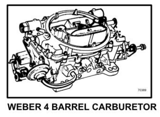

I went the other way - ditched the Webers for a Quadrajet. It works like a trained pig. Here are some pics and a description.

I recall an available conversion kit to install Weber 4 barrel in place of 4A for Euro models, similar to this M20 adapter.
May have used the Weber/Edelbrock 4 barrel commonly available for marine engines, possibly for BMW marine 6 cylinder.

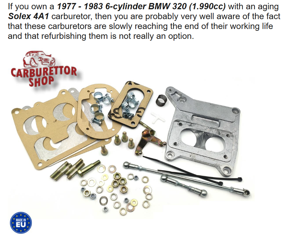

On your first picture I think there is a kit to make a single Weber 38 fit the 4 barrel manifold.
