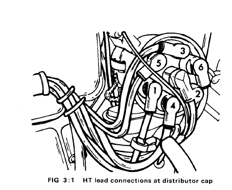

Then check to see where your distributor rotor is pointed. If at something other than post where the #1 (short) wire is attached, then pull the distributor and turn the rotor to ensure it lines up with #1 when fully seated. The diagram below shows the typical position of the #1 terminal on the distributor cap (source).

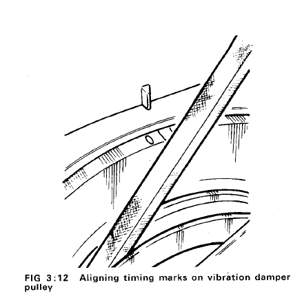

The Autobooks Manual that Lance references above makes one more suggestion if you have to remove the distributor. You need to align the rotor as shown below. The segment A in the illustration is about 35mm. If you don't do this, the rotor will be advanced well past the cylinder 1 mark because the gears make the rotor advance as you insert the distributor. All of this information is found on pages 47 - 49 of the Autobooks PDF.

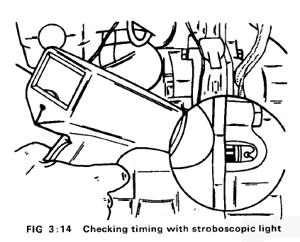

“Z” ball is for timing with a light, it’s 22 degrees ahead of the “0” ball. The “0” ball will be in the bellhousing view hole at TDC and the crank balancer line will line up with the notch in the lower timing chain cover. Best to mark these with different color paint.

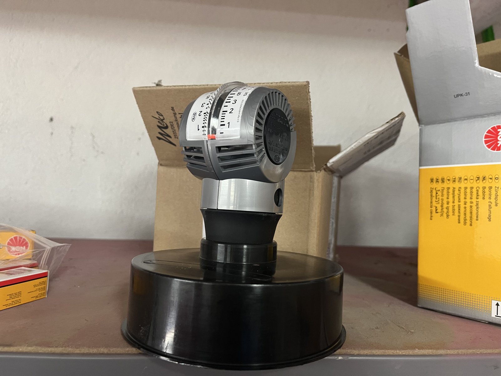

I got this syncrometer
There is an adapter designed for dgv/dgs carbs with two holes that can be used with this syncrometer (that I probably should have gotten instead of the one I have). Maybe this adapter could be used to measure the difference in flow through each barrel and then calculate the turns?
