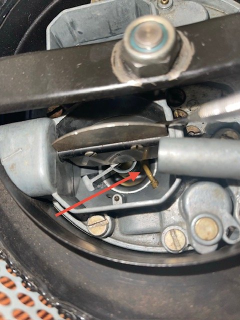

Fellow Members, i checked both Carbs. With the engine off, when pressing on the accelerator linkage, the brass nozzle (see attached pic with the red arrow), one carb had a nice stream of fuel, but on the second carb, it was dripping slowly.
With the engine running, both carbs seemed to have a spray type flow, hard to compare between the 2 carbs if one had a higher spray flow.

The key is to do it not running. When running and you crack the throttle you can see fuel flowing through the venturis, but you are looking for the shot that you get from the pump jet that overcomes the lean stumble that happens as you transition from the idle circuit.
From your description the pump jet in one carb needs replacing.
