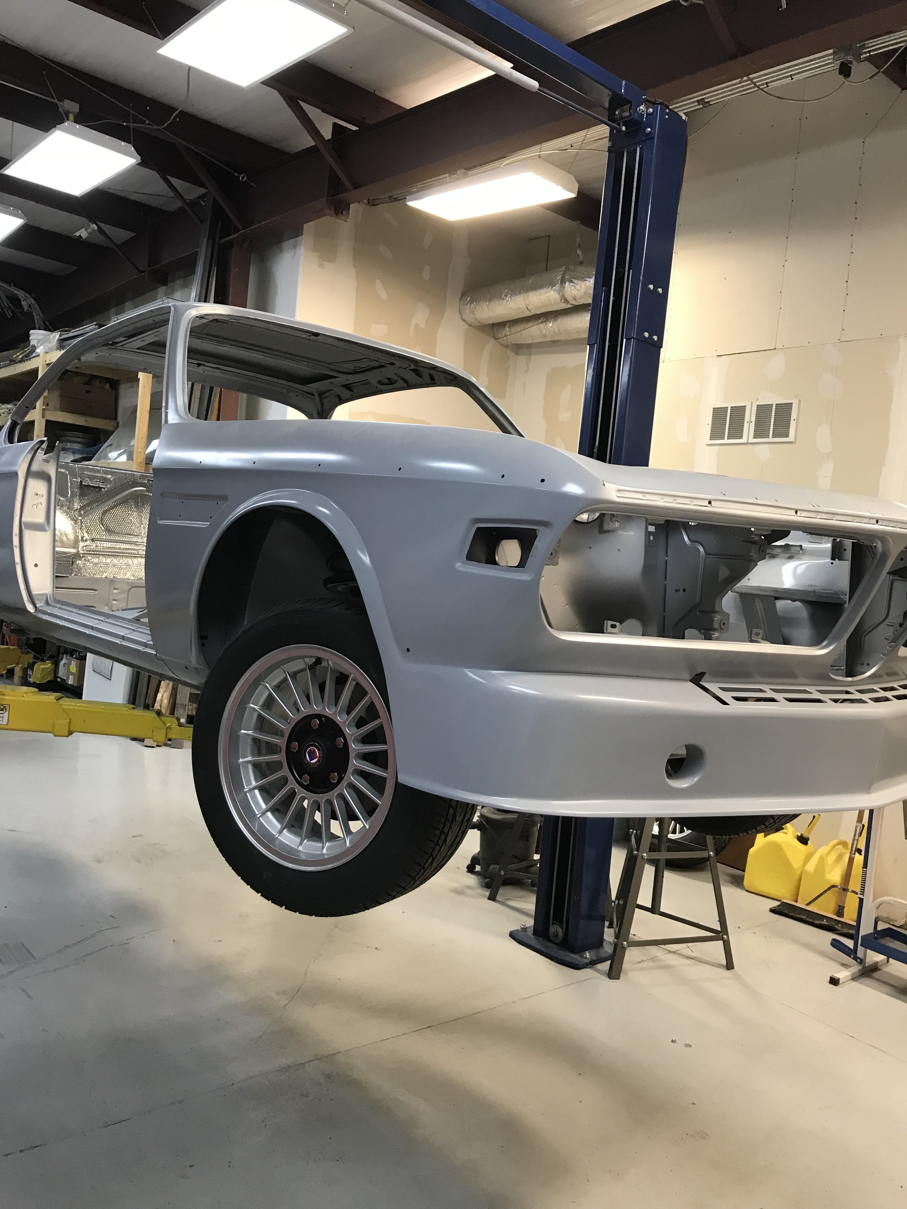

Here is picture of mine which look great but I have to use sand bags for the weight since nothing is installed in the Engine bay yet?
