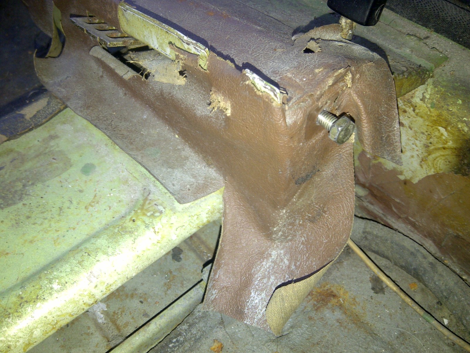

I have what I think are original parts for the piece circled, it is glued to the outer sill next to the back seat floor
It ends at the forward edge with a vertical termination
The area just in front of that piece doesn't seem to be covered with anything
The vinyl parts that wrap the seat support don't seem to cover this area
But I will just make the carpet part circled a little longer

Thanks, Pickman! that was what I was looking for, the aft side part does have a tab on it that goes under the seat support

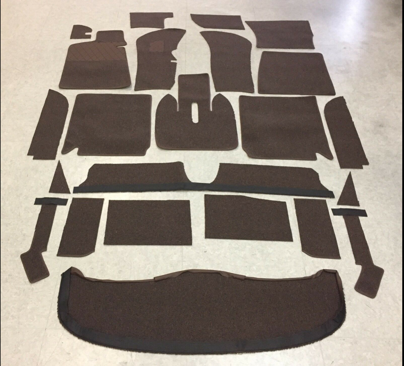

Might this pic help....
sort of, but they are not laid out in the right locations

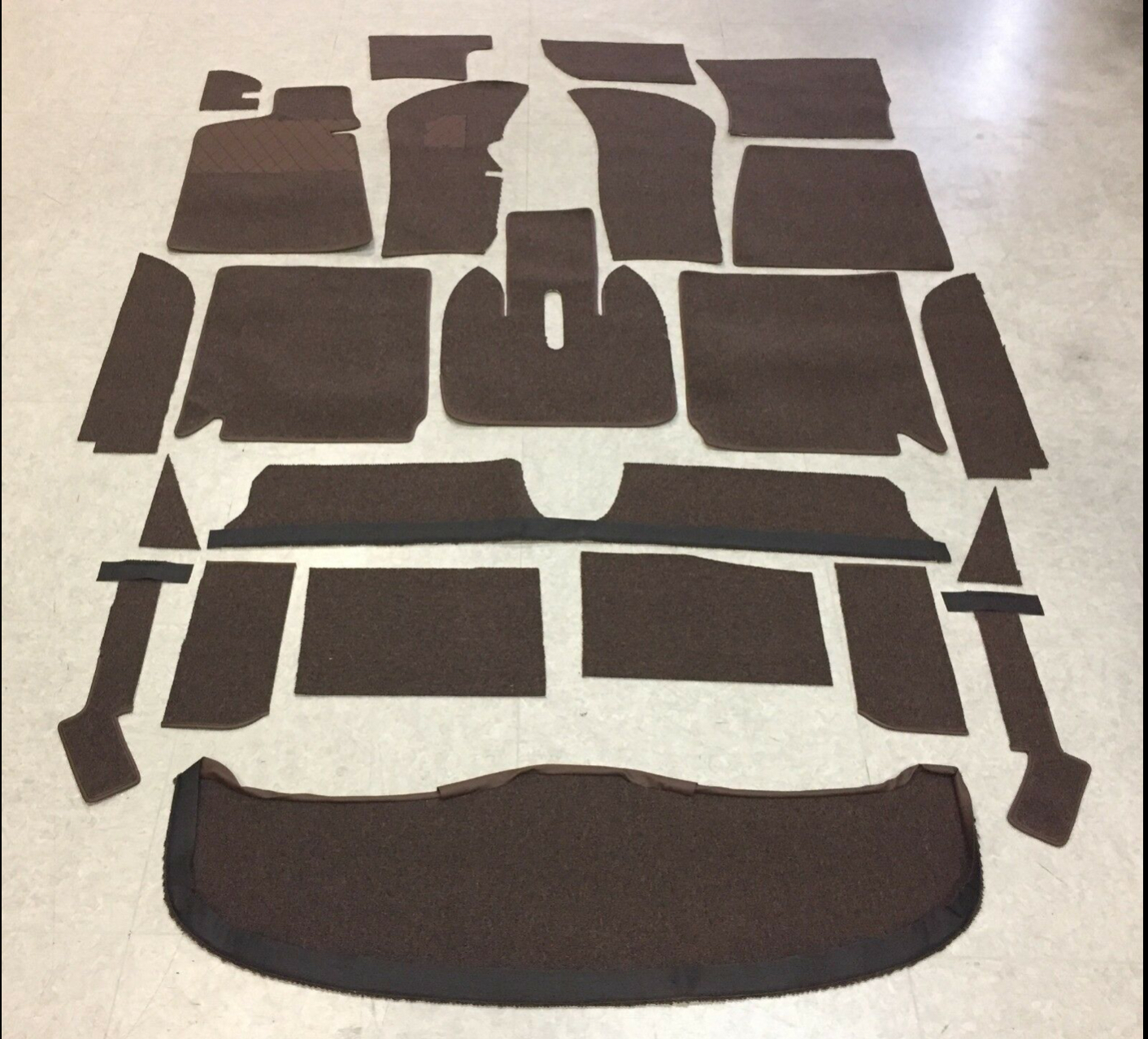

Is this the set you are using?
What are the triangular parts, far left and right about 1/2 vertical?
And the small part upper left, round top with a notch out of it?
Interesting they give you a piece for the rear shelf
And it looks like that piece I have been asking about, near the bottom, far left and right, just inside the outer frame covers, don't have the tab under the support

Im not using this set, I saw it for sale on eBay and thought it might help in identifying the missing piece.
Here’s another schematic from KHM who are about the best for classic cars in Germany.
For copyright reasons, they have distorted the pic somewhat
