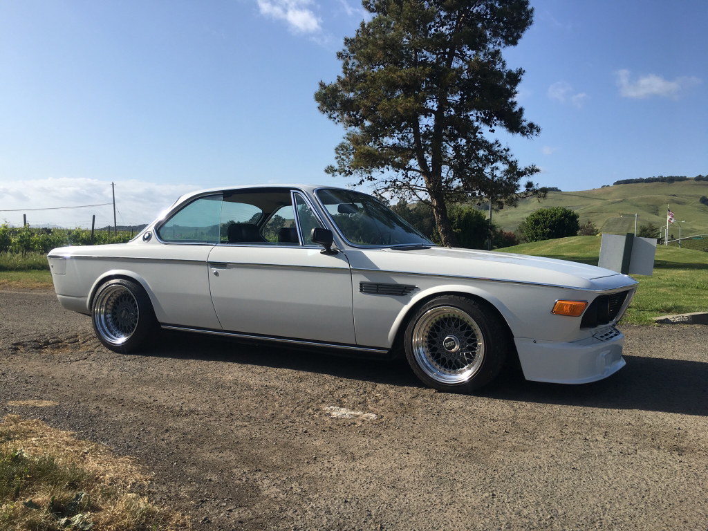

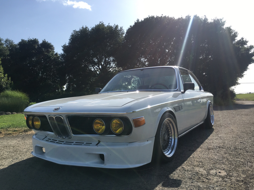

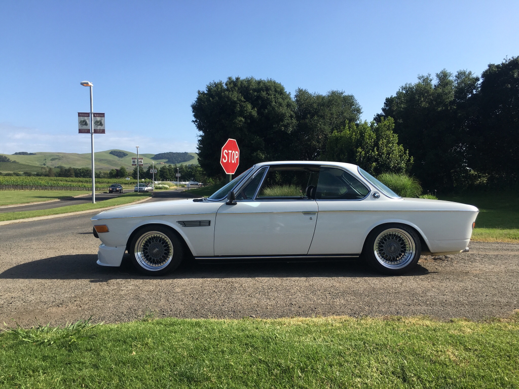

@BarryG is that your E9? I love the stance of that car and am interested to hear back on what you hear from Ground Control. I have sent you a PM about your wheel setup as I don't want to hijack this thread which I would rather stay focused on the Coil Over Group buy.
BarryG turned me onto Ground Control and I haven't regretted it one bit, and to be honest with you I like the ride better than the lowering springs I have on my other coupe.
