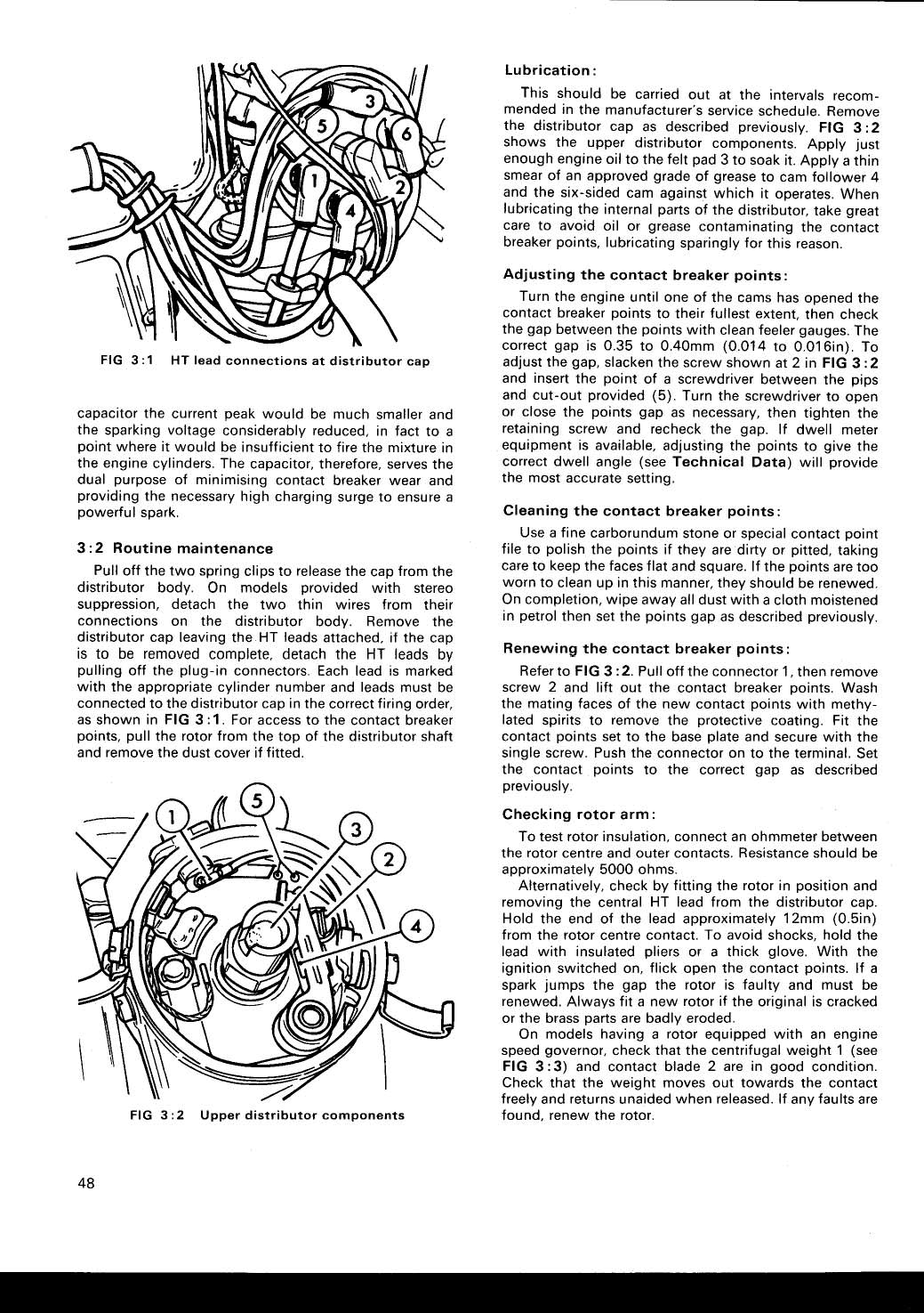

Thanks for the replies chaps, there's a good info there to me to unpack. MMercury, thanks for posting those pics, very useful.
I've already bought the points so I really should install them. Regarding Pertronix, I hear what you're saying. I'll have to do my homework to get a handle on that concept. If there's a 'for dummies' introduction and walk-through for such a set-up, please feel free to post a link. (I always do a search for info before posting but the results can be overwhelming and posts are often written with an assumption of knowledge).
Hi MMercury. Apologies for not being clear in my last post. I meant a walk-through for setting up a Pertronix system or similar as I will go down that road at some point in the future as I like the maintenance-free aspect of such a set up.
In the meantime I'll be installing the points and using the write up you attached in your other post as a guide.
