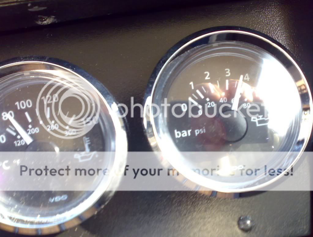

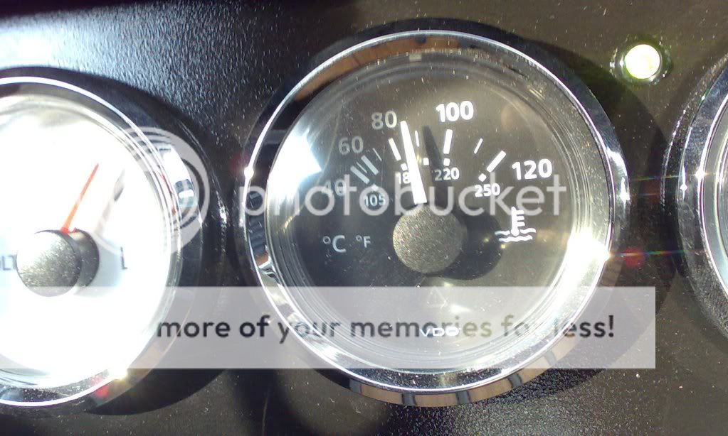

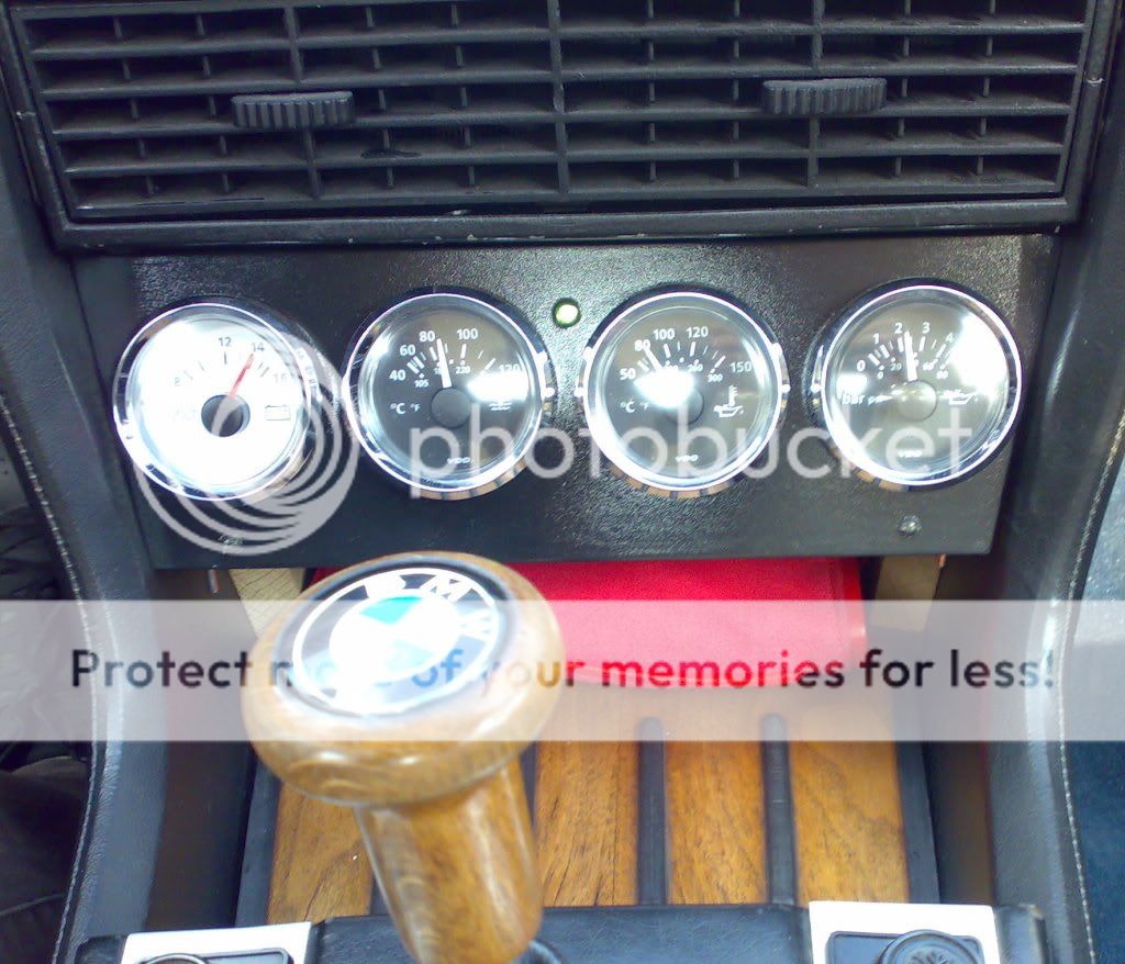

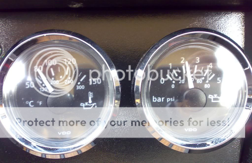

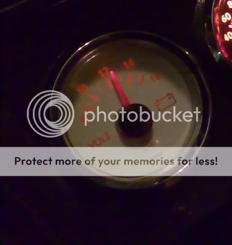

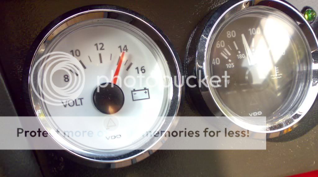

I have finished a long project to install some additional gauges in my car to cross-check some key parametres of the engine, and the results are here, can you please tell me if the values are correct:
volts at contact: 12v
volts engine on: 14v
water temp: 85ºC (200ºF aprox)
oil temp 80ºC
oil press at iddle = 2,2 bar
oil press at 3000rpm`s = 3,5 bar
see pics:
volts contact only
engine warmed up
general view of gauges at iddle
volts iddle
wsater temp iddle
oil temp and press at iddle
oil temp and press at 3000rpm`s
Engine variables
Looks right.

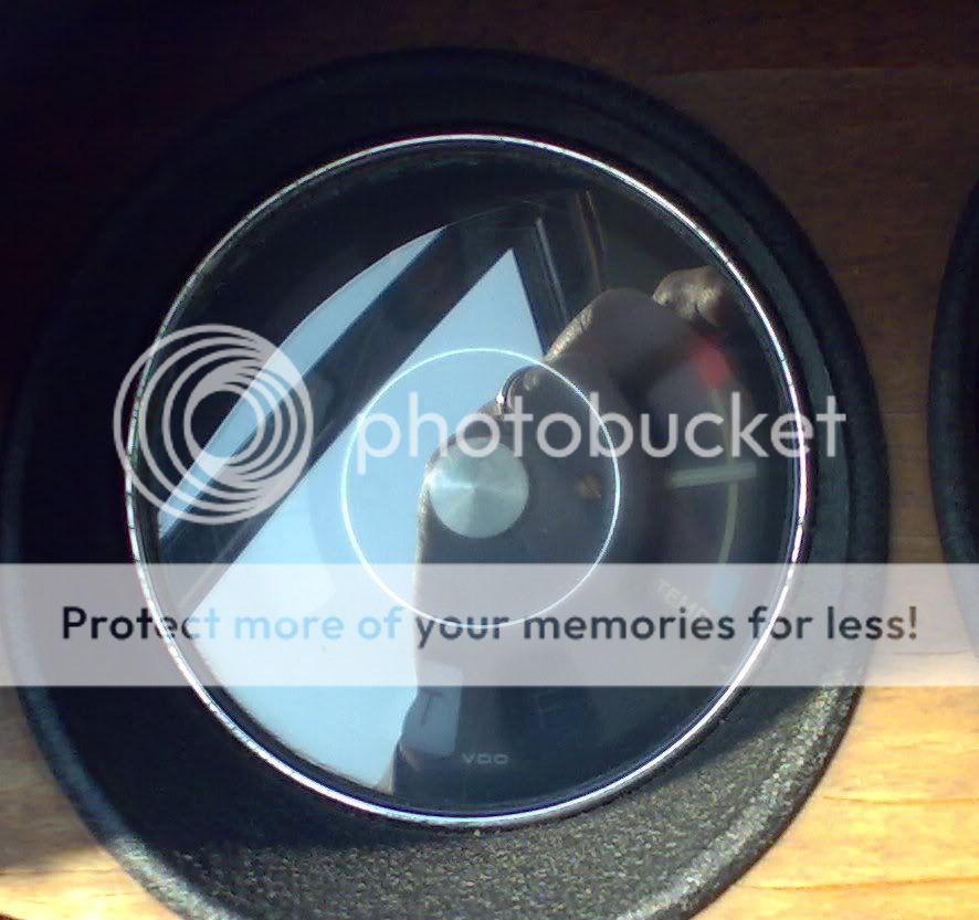

Voltage at rest- 12.7. Should be the same as the battery. Anything below 12.5 - check your battery. So the guage could be off just a little?
Looks right.
well if i look carefully to that pic, probably i was not very accurate in my description, its more like 12,5 volts, the view angle of the pic is not helping
regards and thanks
