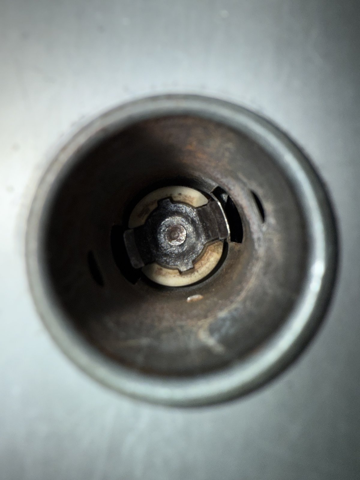

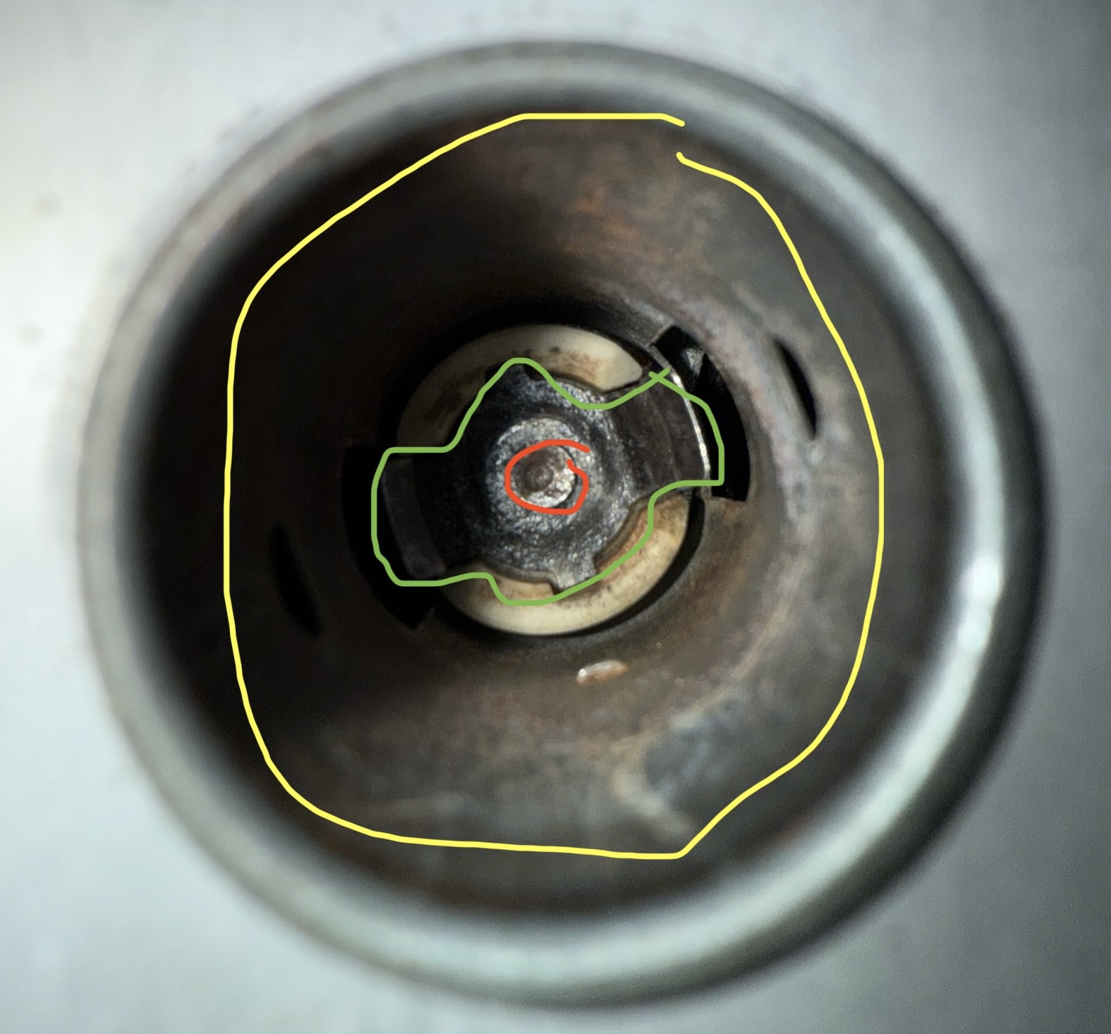

Hi Stan,
I'm about to look into this as well. My lighter does supply power, but it isn't consisitent. Any slight little road bump disengages whatever I have plugged in and I lose power.
It appears that the circumference of the lighter was never meant to supply power to modern adapters....

Before you do anything to extreme, buy a cheap replacement 12v cigarette lighter from NAPA or any other car part place and strip out the sleeve. This happens to be the same outside diameter as the inside diameter of the original lighter (which I think is labeled as a cigar lighter in the owners manual). I don't know if they all are this size but it is a perfect fit and stayed in place for the 1800 miles trip I just did.
I use it to recharge my camera batteries and run the iPod. The cell phone stays at home.

No, just slide the sleeve (the chrome collar in the photo) that you get with a repalcement lighter unit into the existing lighter socket and then plug in your charger. No need to alter the original this way.

But my OEM cigar lighter is not operating. I will not stay down and it does not get hot even if held down. I think it might be dead...
Can I swap the whole unit out?

Oops, I missed that part (dead OEM unit). Now the question is, will a modern unit be too small for the hole in the shifter console? Because the OEM is definitely a larger diameter. Sorry can't help with that one.
