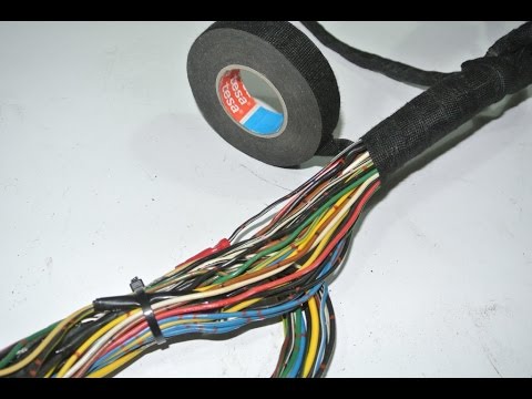

I agree with Chris - Summit's split sleeving won't fit tightly - you'll need to add tie wraps to make it hold on - and it will look all wrong. Wrapping your harness with non-adhesive "tape" is easy and will give the proper look.
The correct product is readily available - even Amazon sells it: https://www.amazon.com/Tesa-Wire-Loom-Harness-Mercedes/dp/B00EH6IZ6Y
That Tesa tape is remarkable stuff.
Really tough and good looking too.
