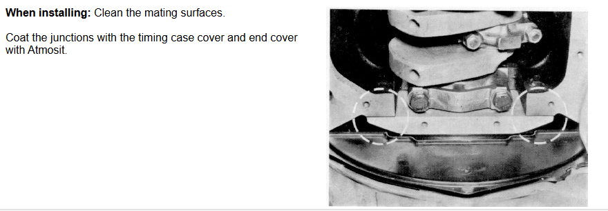

It worked for me on this cover and the tricky oil pan.
Also, the repair manual advises a drop of sealent in the corner. Here's the pic of the lower oil pan cover:
