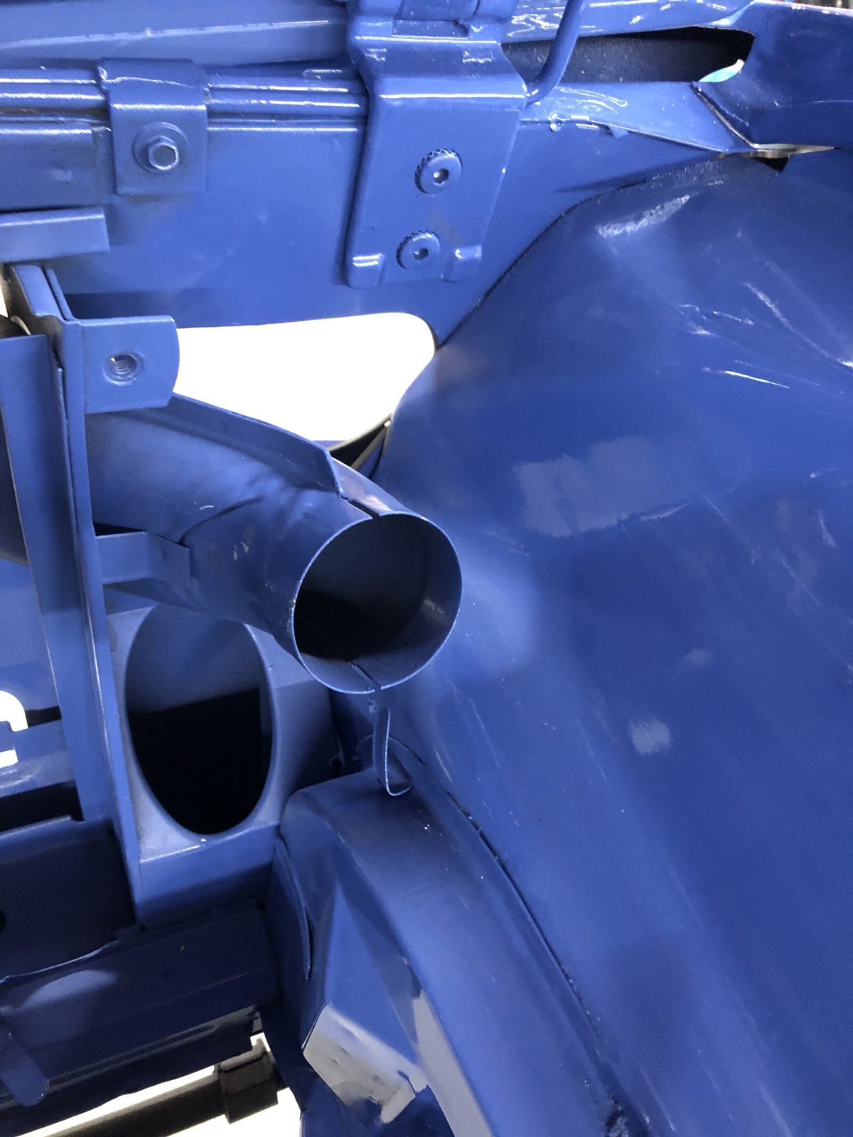

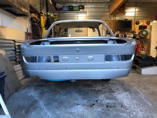

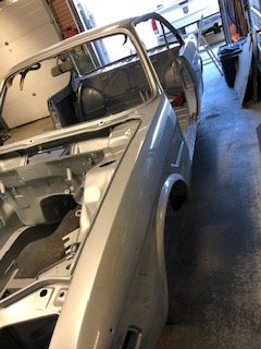

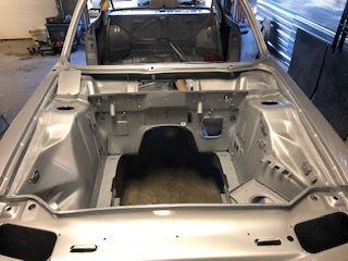

Hello Everyone,
Thank you very much for the considered responses. This weekend I went to the shop where the car will be undergoing its final assembly and wanted to take more pictures but due to certain limitations I could not. The pictures below were taken by the person managing the project in the new location. As you can see some areas are shinier than others. To me, since I have between 800 - 1000 hours into the body/paint I am going to ask the person managing project to apply the same level of clearcoat to all exposed areas. As Dang noted, since I am in the process, and have been for a long time, I say why not. Sometime in June I will be going back to the shop to take more pictures.
Andrew
It's tough to tell from the small pics you posted if there is any sheen difference.
I think you might be disappointed if the areas that get more clear don't end up with the same sheen as those that have been cut and buffed. In addition, it is a pretty major job to apply more clear now. Those areas will all have to be scuffed well in order to get adhesion. Then there is masking and the possibility of a visible break line where the new clear meets the old clear.
The painter probably should have explained to you more carefully what his process was and why, so if you didn't like it, you could have explored alternatives.

More clear won’t make it any shinier,
It can if you're not putting enough on and it doesn't have a chance to lay down. Less shiny because it's not as smooth. I'm sure you've dealt with spraying into boxy areas or areas where the air coming back out fights the material going in. The clear can go on quite a bit thinner in those areas.

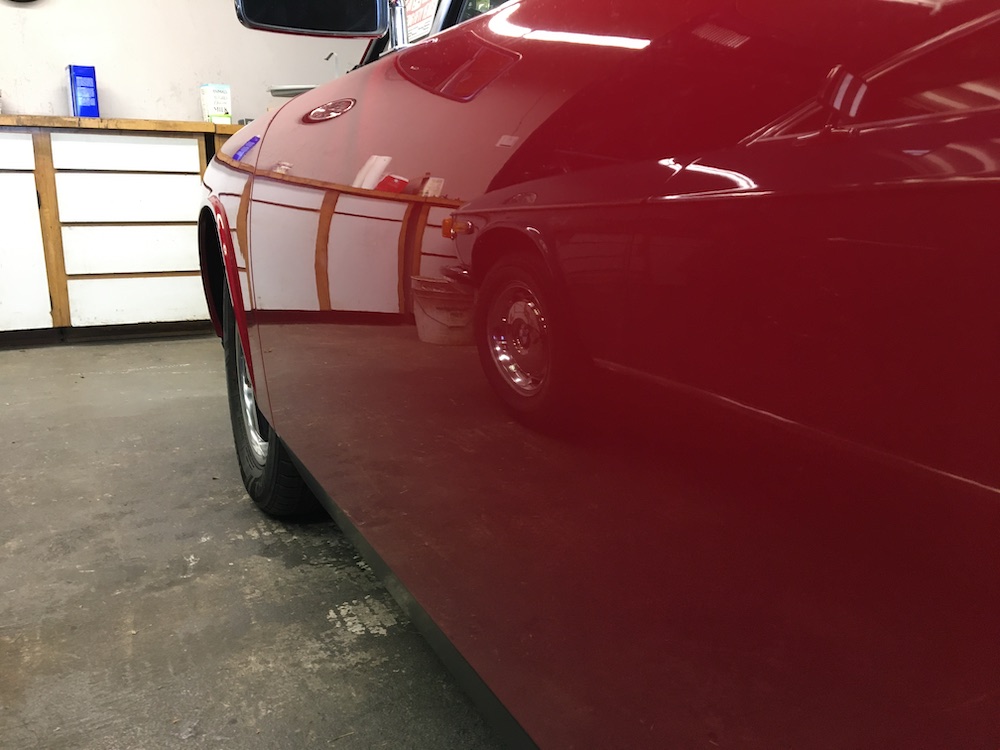

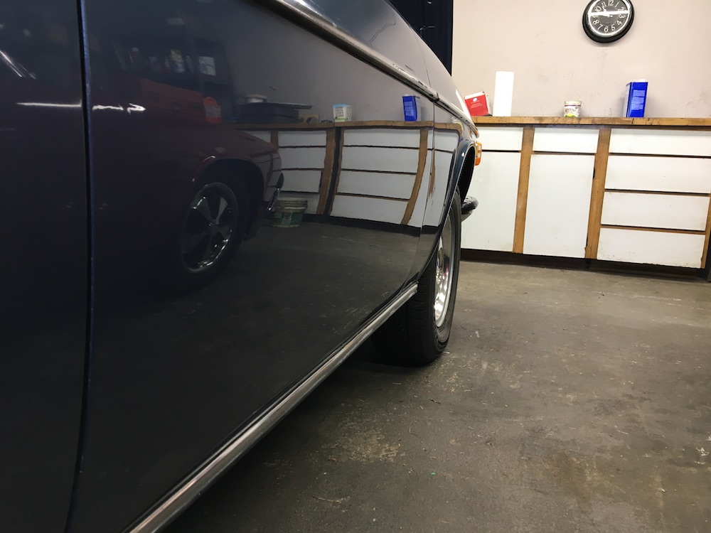

Here is my Baikal E3 (metallic...base clear) compared to my recently sold Malaga 914 (solid color single stage)...
Mine was repainted 15 years ago in base/clear and my new paint job is also base/clear even though Malaga was originally single stage. With the clear coat you can color sand and polish out every imperfection, I have no evidence of orange peel which came in the factory paint jobs.
