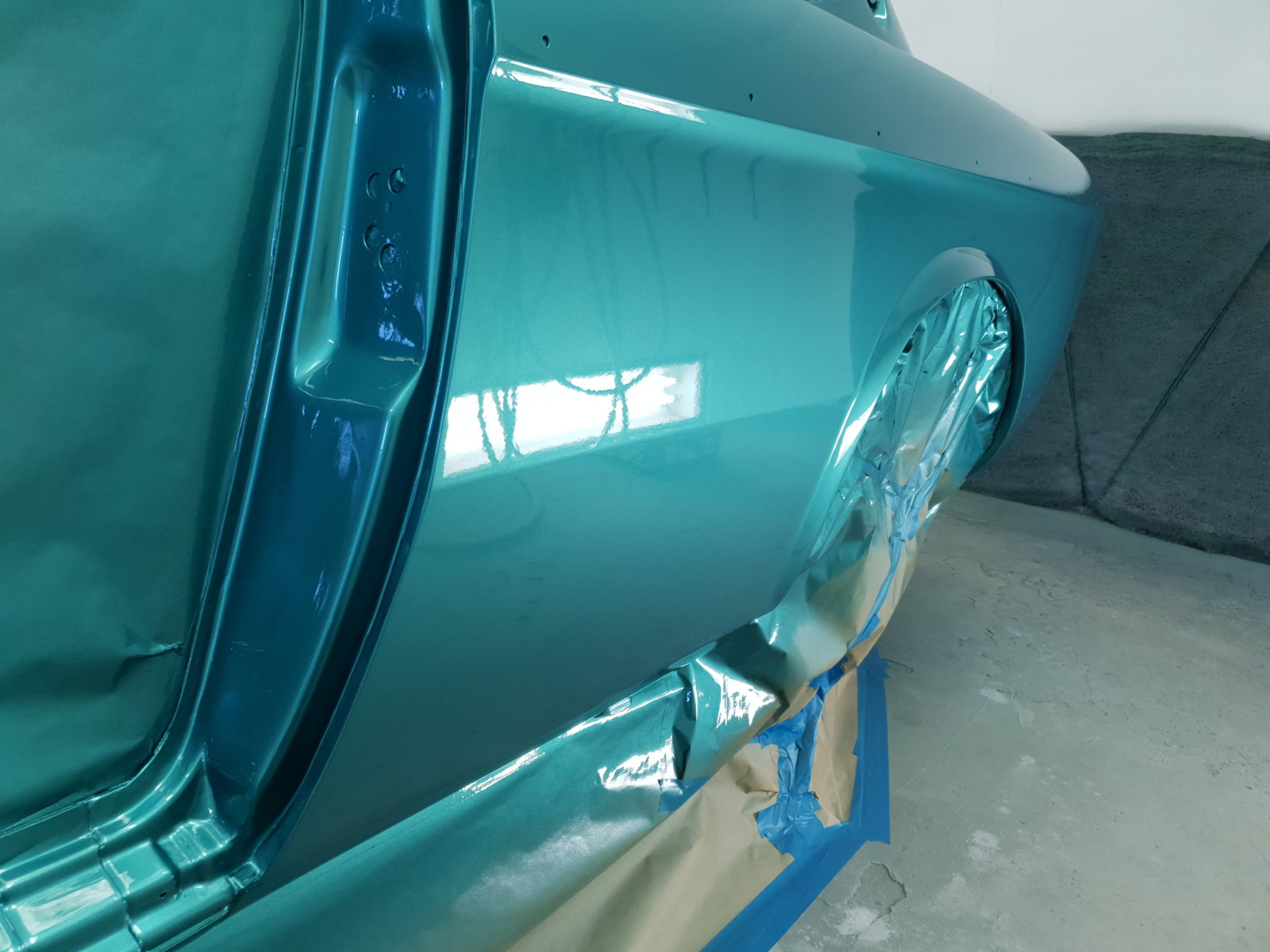

This is straight off the gun with no buffing :cool:

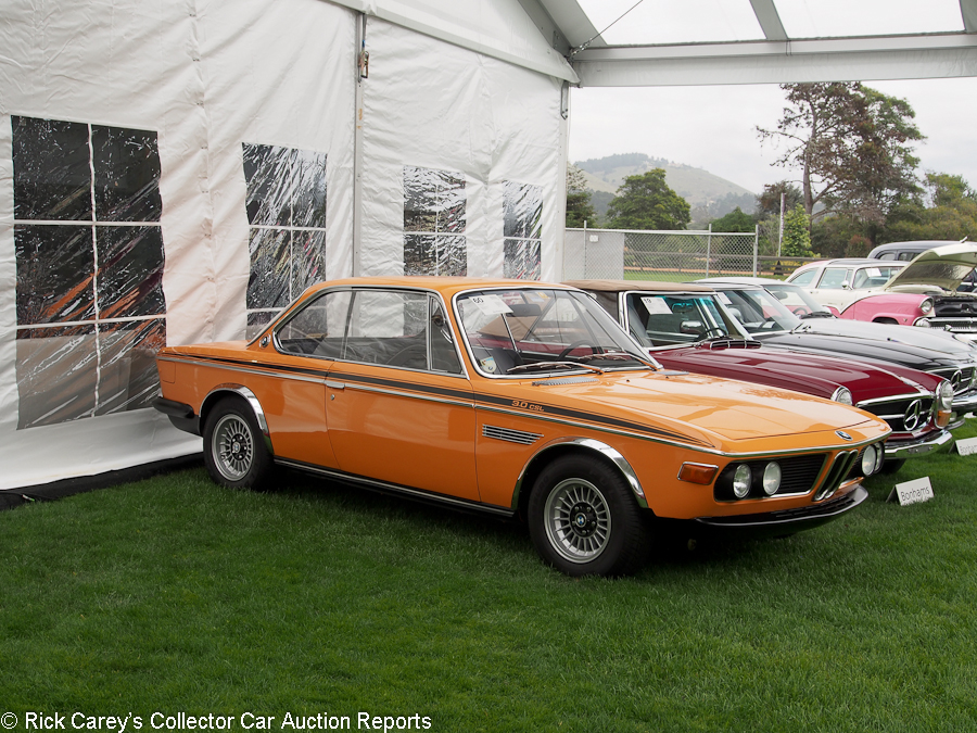

I came to this thread only after watching a video recently. The owner of this golf e12 repainted it in single stage glasurit. He has an eye for nice BMW’s both original and modified, and he went with single stage original paint for this highly modified but period looking e12.

Orange peel can be minimized with a pro downdraft booth, carefully controlling the temperature, selecting the proper temp range hardener and reducer, proper mixing ratios, AND having an experienced painter apply the paint....but it can't be eliminated. I can clearly see the peel in this (unenlarged) section of the picture you provided...
...and with the proper lighting, I'm sure the rest of the panel looks the same. I doubt if the paint shop is going to turn the car over to you in this "as shot" condition. There are several days ahead of them to color sand and buff it to an acceptable level for such a special car.

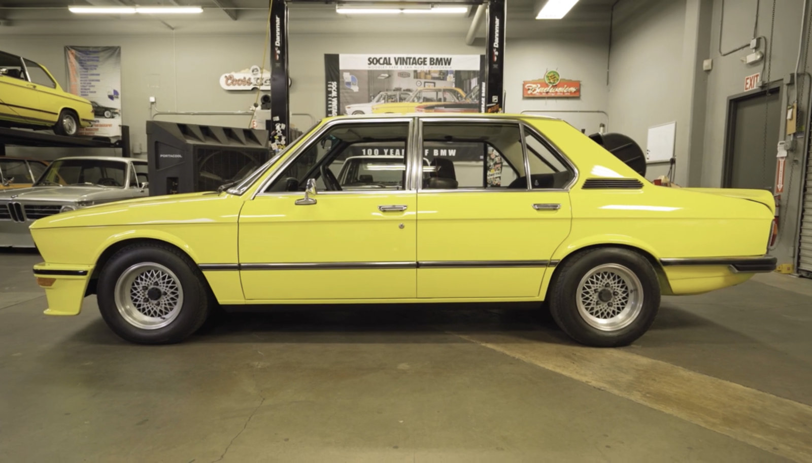

Also, my old eyes aren't the best, and if you can tell the difference in shine or depth of color between the two cars in post #15 (taken at the same time with the same lighting) I can accept the fact that my eyes are even worse than I think. :(
The surface roughness is admirably low, and s sign of a good painter. But in the reflection none of the edges and lines are sharp. That’s due to orange peel. Color sanding and buffing will take that out. But for a non-concours finish I would leave it as is.
