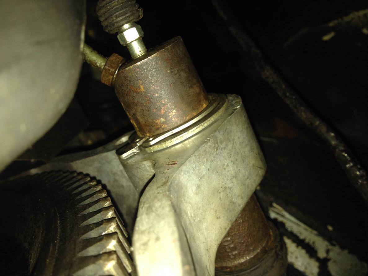

My previous phone died so I lost a ton of pictures while I removed the engine and tranny from the E9.
I'm putting things back together, but sometimes I have a doubt.
I'm wondering if I correctly reinstalled the clutch slave cylinder.
Anybody can check the pics in attachment and confirm?
Thanks in advance!

Yes looks correct but put some grease or antiseize between the bell housing and the cylinder to keep the two different metals from welding together.
