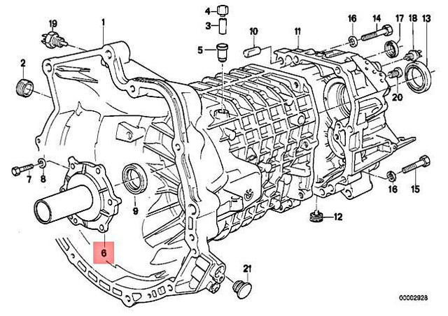

Just thinking this through… is the any difference in the 2800 bell housing and the 3.0 bell housing ( early, late etc) other than the clutch fork and slave? Size difference or anything?

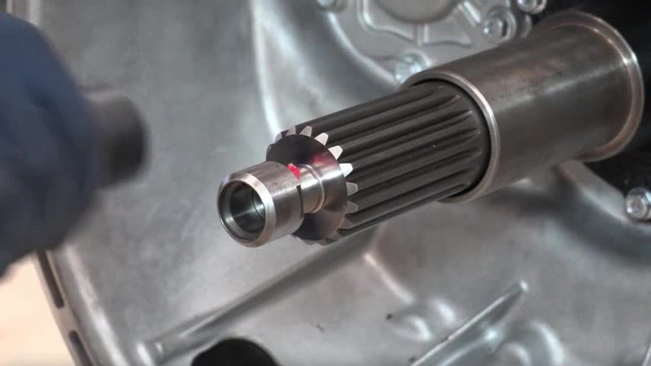

I alluded to this before. Transmissions are often handled by the sleeve upon which that throw out bearing rides. It is unlikely, but if that "stout" sleeve is somehow slightly deformed/out-of-round due to rough handling or poor lubrication and/or rust, that throw out bearing will not move smoothly and result in additional pedal effort as though something is “binding.” Not unlike analyzing piston-to-cylinder wall clearance, it is probably not a bad idea to manually move the throw out bearing on the sleeve to assess roundness, wear patterns and - fit. Even with the best Krytox grease. over time, too much clearance between a throw out bearing and the sleeve can result in more-than-normal friction and “binding.”

The sleeve looked good from a visual standpoint. No major deformation or rough spots. I did test the movement after lubricating with a moly based grease. Seemed to slide just fine.
