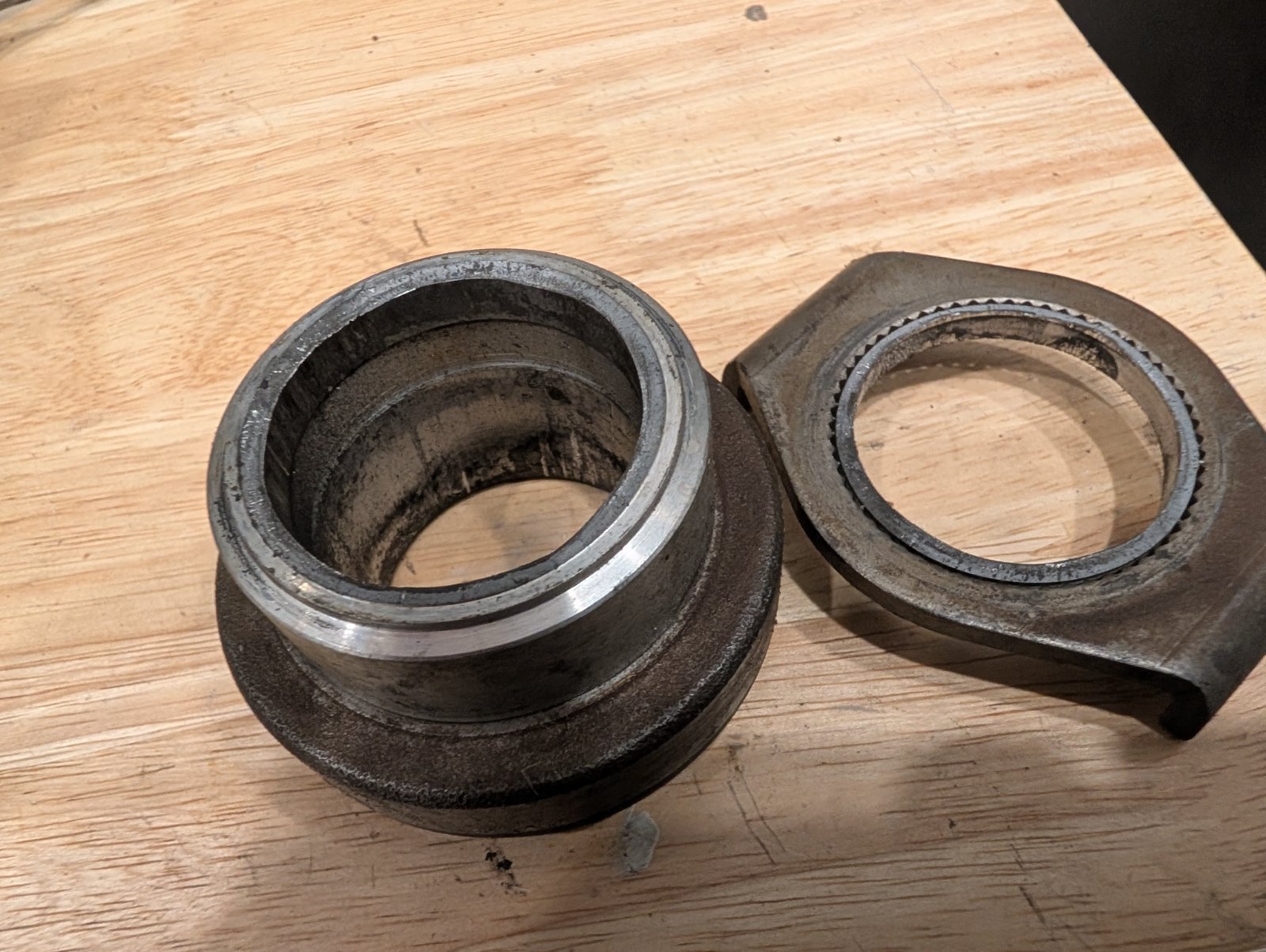

I pulled the slave today and got my inspection camera up there. The throw out bearing separated from it's backing that attaches to the fork.
I have never seen this before... Has anyone else experienced this?
This is the older style throw out...2800 style.
Other than just a bad bearing I am wondering if there is anything that might cause this that I should look for.
I'll start pulling the gearbox... Sheesh.

I lubricated when installed. It’s been in there for less than 200 miles. All parts were brand new. The problems started right off the bat.
I think… think… we just have a defective part here. I’ll know more when I get it out. See if there is any scoring. But there didn’t appear to be anything thus far.
This was a non BMW part… Saks I believe. I’m replacing with the BMW part. Who knows if that will make a difference.
Could be wrong, but Sachs, fka Fichtel & Sachs and now known as ZF Sachs, has been an OE supplier for BMW und other European brands. Manufacturers of mass produced products do not always achieve perfection and although unlikely . . . new parts can fail.
You mentioned that all parts were brand new. Did that also include the transmission input shaft sleeve? Yours may have been and continues to be usable.
Of course the clutch fork and its pivot pin also need to be in good shape and properly greased to ensure smooth clutch engagement/disengagement. But it is hard to imagine how that would cause a throw out bearing to fail, so as you suggest, it could be just a bum throw out bearing.

So I pulled the gearbox etc last week. Installed the new bearing on Friday and buttoned everything up. Greased everything as directed.
Works great so far. Adjusted the clutch and low and behold… it was in the same adjustment on Saturday when I went out again.
