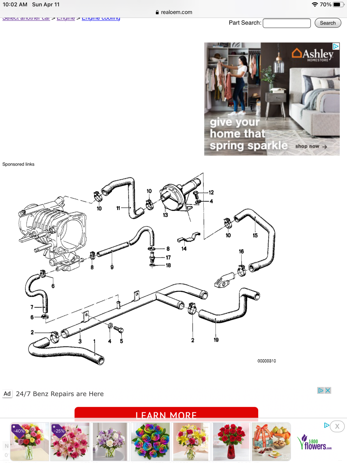

maybe it's an optical effect, but it seems to me that my engine is missing a valve,
the one with 2 sensors right next to the printed number 3.5
strange thing for me ....
can you tell me what it is?
I got that wiring harness under my M90 from a 1979 bmw 728i ....
could it be that the 728i didn't have that sensor ??? and that the 735i foresaw it ???

Do you have this device on your valve cover?
additional Air slide valve
same action as valve under c-tubes
used to warm up engine.
