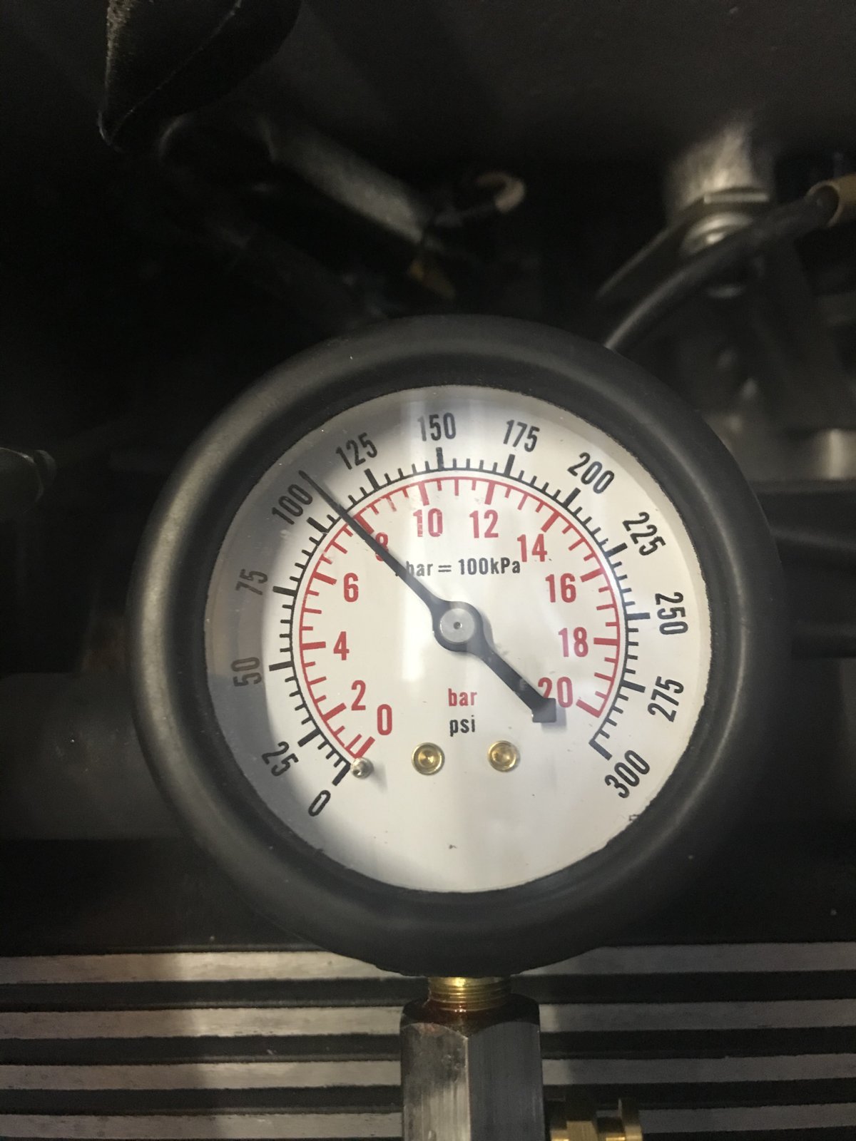

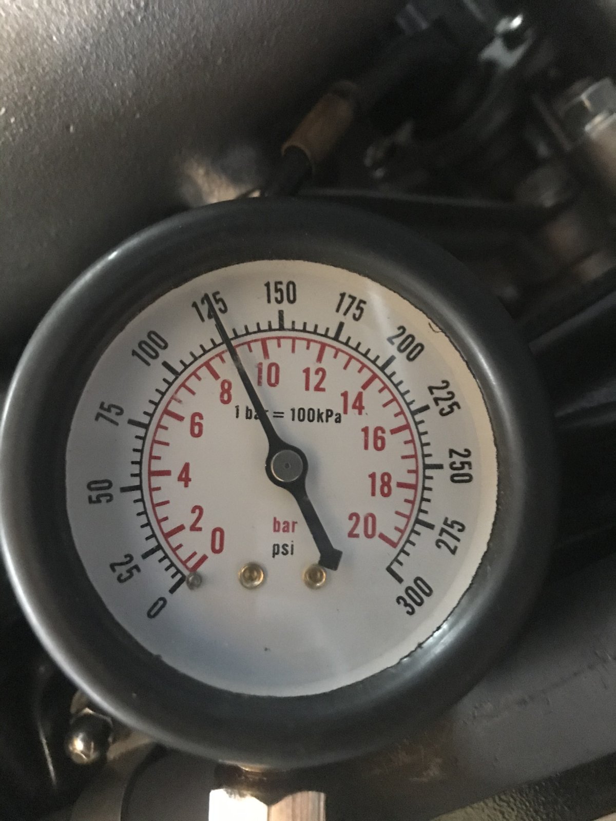

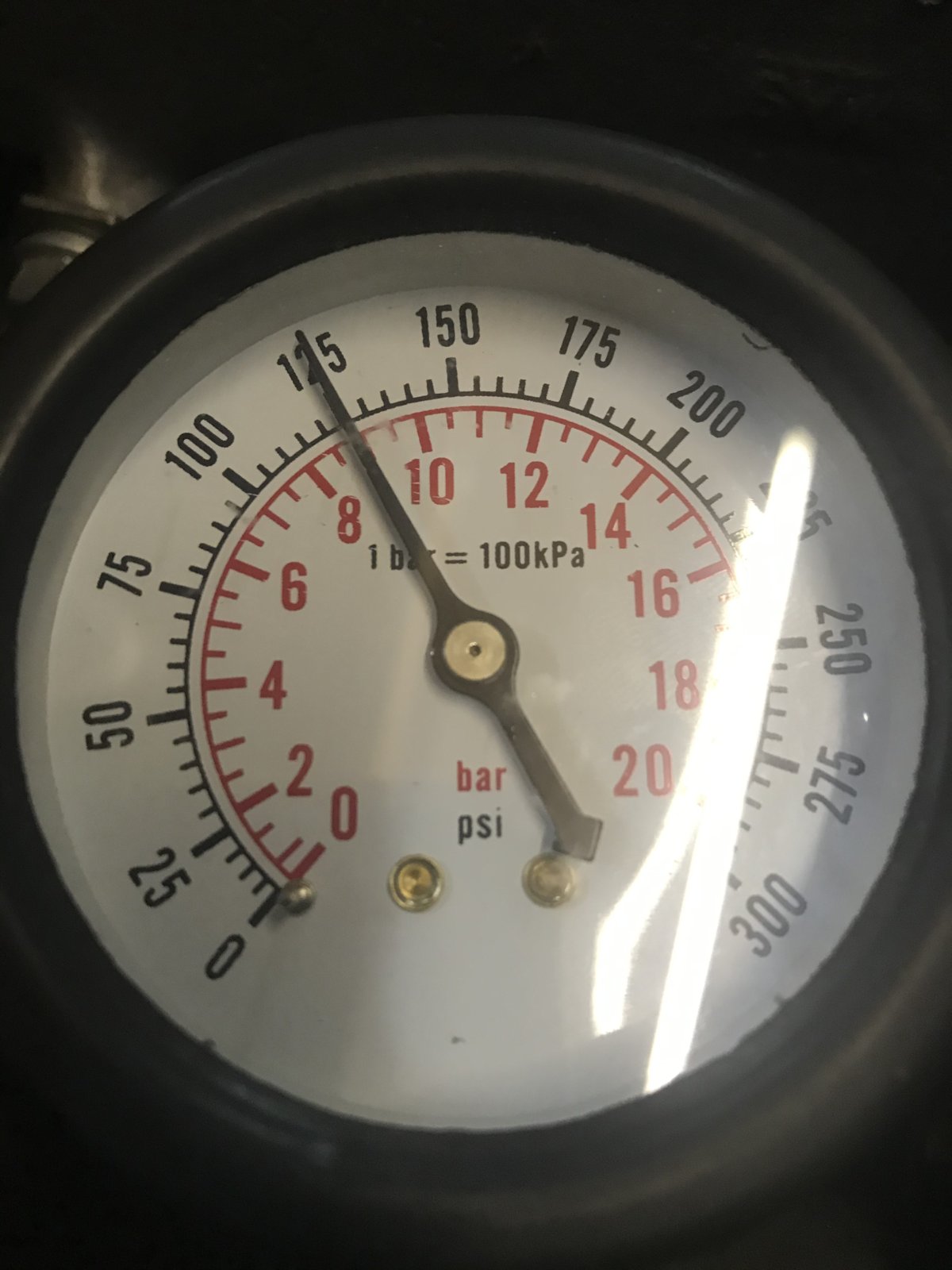

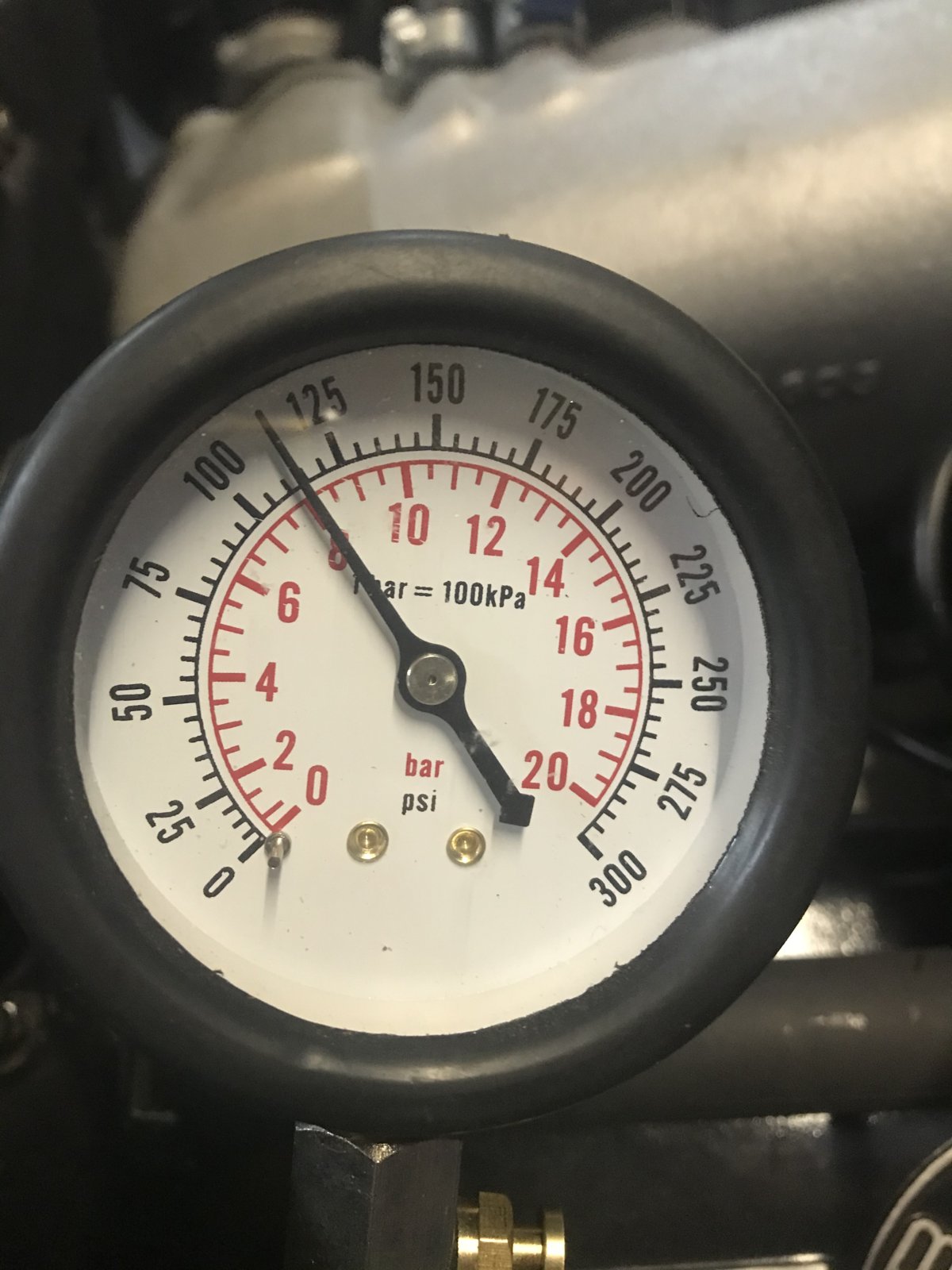

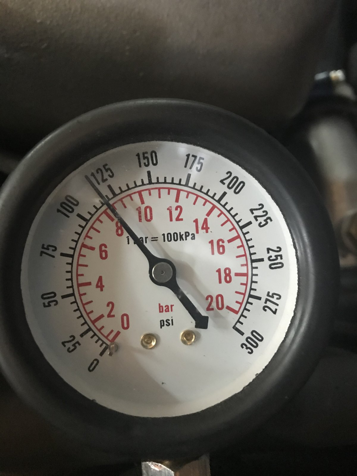

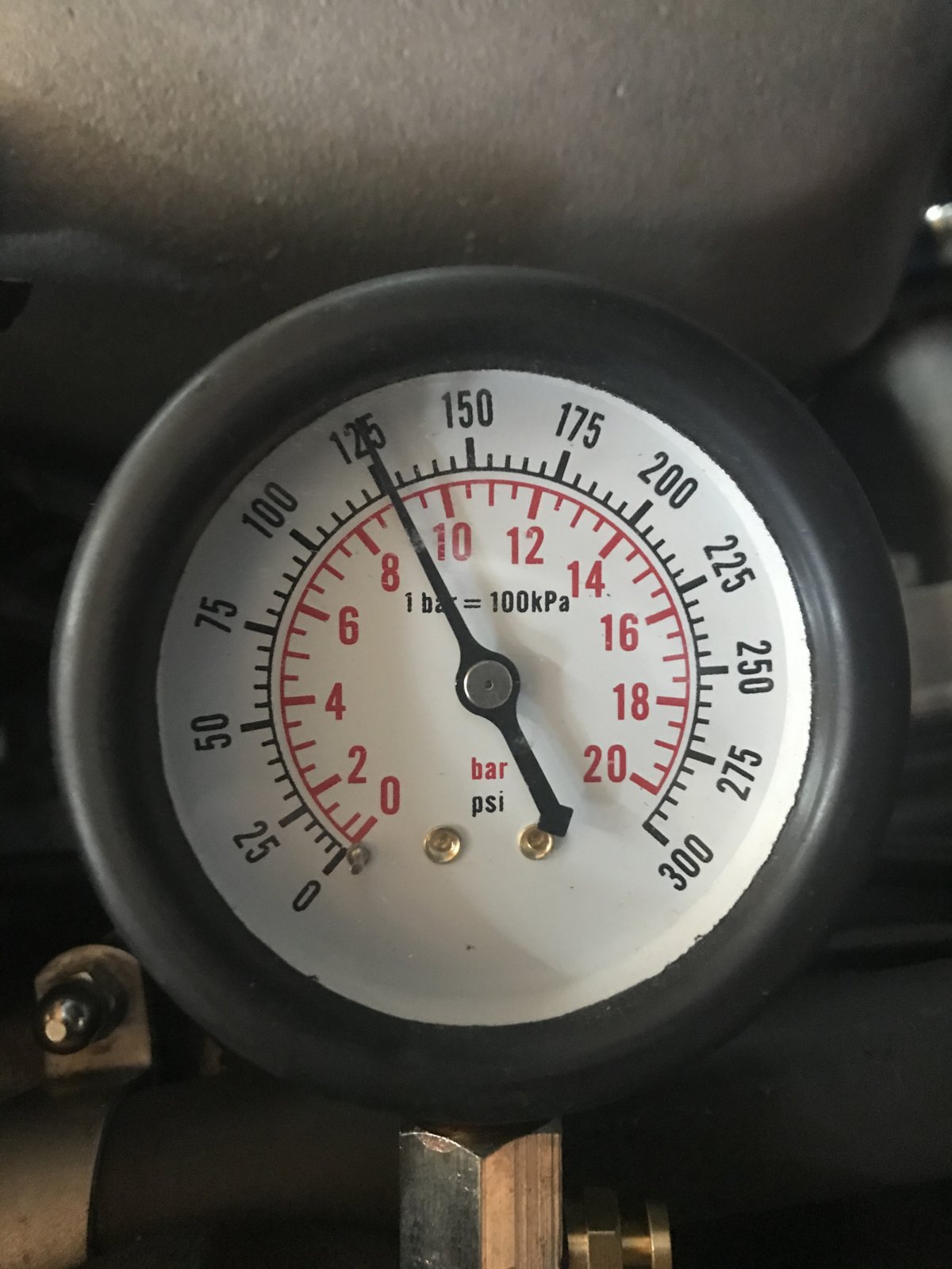

Hi all,
I did a compression test today with my CSi. According to the blue books the compression ratio should be 9.5:1. Would be 9:5x14.7=139.65PSI as a reference if I’m correct.
The value I measured today were between 115-125PSI. Prior before testing i let the car run in idle mode from cold start for 10min. After that I took all 6 spark plugs out and tested them one by one, with full throttle open.
Values look pretty consequent for all 6, but are quit a bit of the reference value if I’m correct?
Would like to hear your opinion on this, thx!

9.5 compression should be around 180

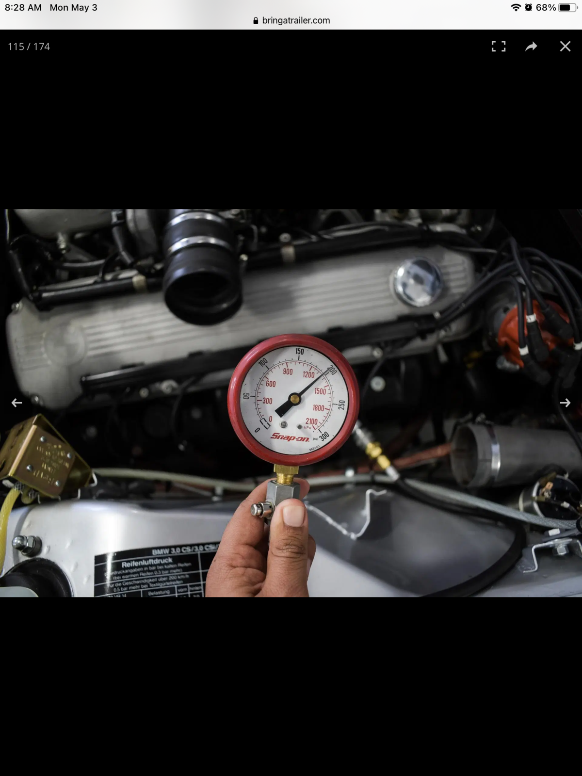

Csi compression pic.....
btw - I have 3 csi’s in the shop.
unless you have a cam in your car (highly unlikely) your numbers are very low.
first try a different gauge or at least a new o ring

That compression pic above is the csi on BAT today...
