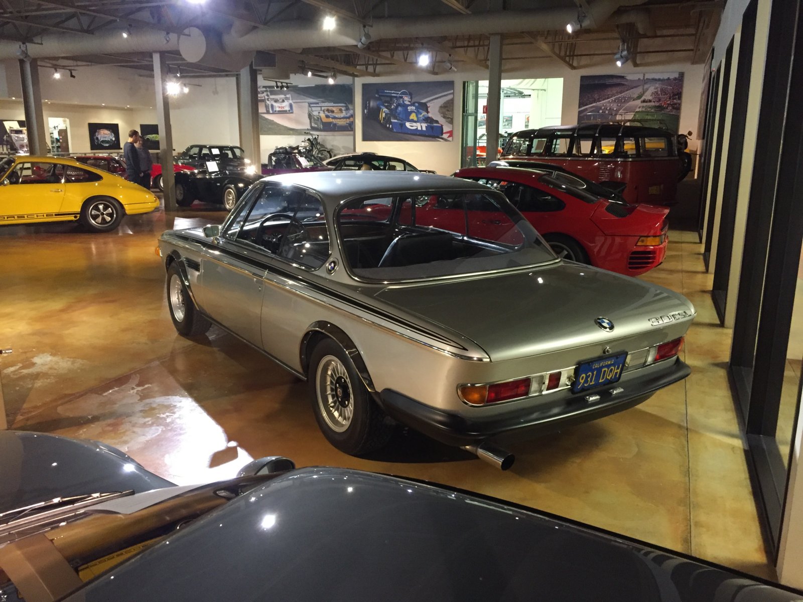

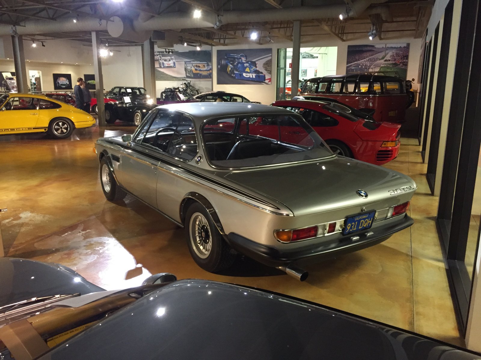

Although not perfect, it IS pretty stunning in person! Saw it about 3 weeks back during their monthly Cars & Coffee event. They are also doing an in-house resto.

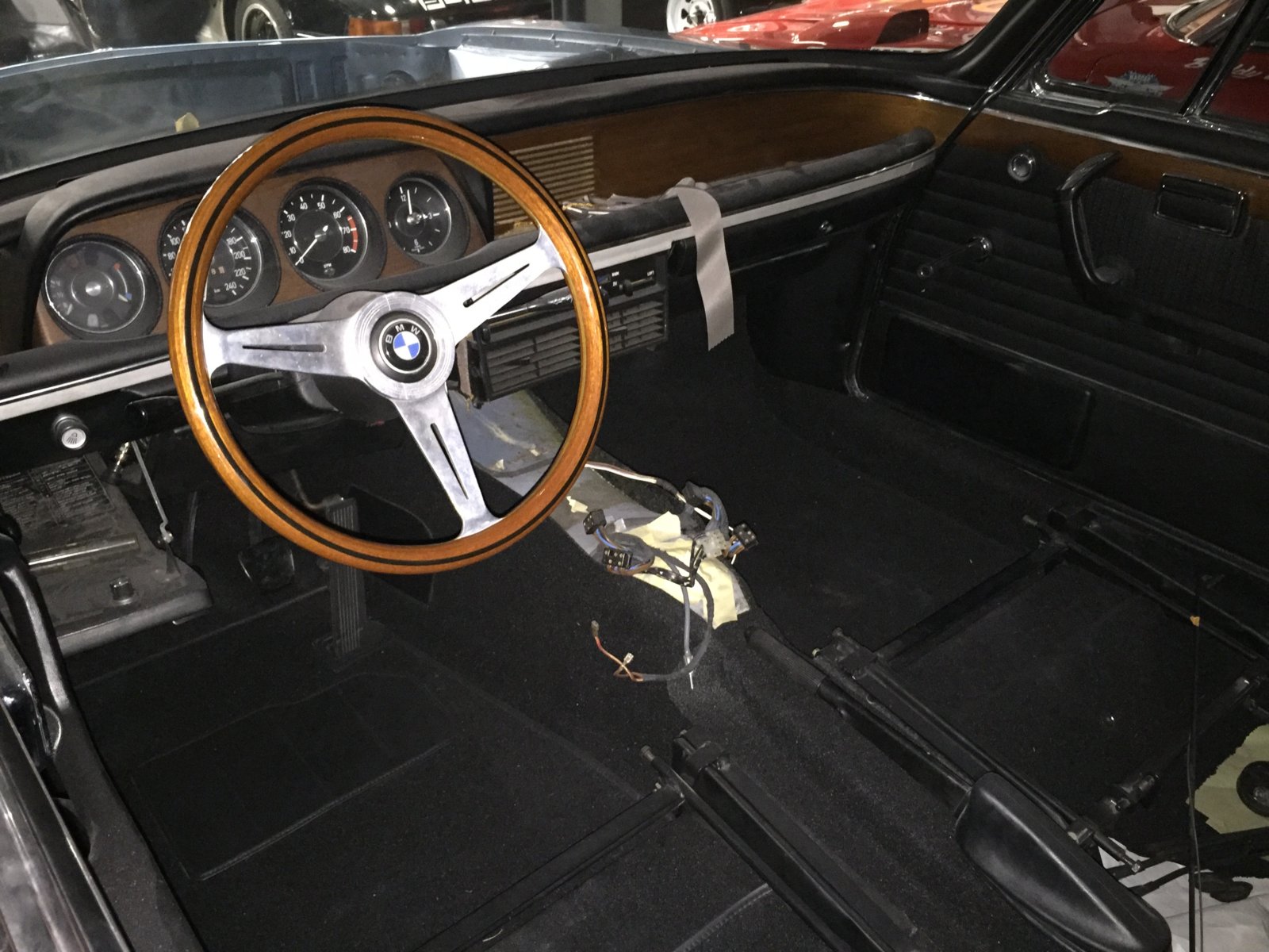

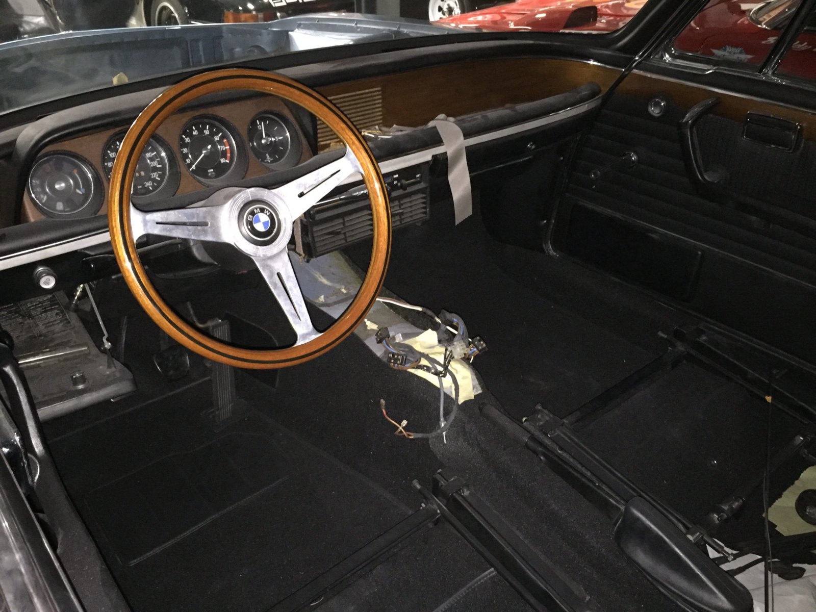

View attachment 48463 View attachment 48464
The pic with the Nardi wheel, is that before the in house resto took place? Looks like the correct black lightweight Csl carpet in there which is now replaced by the new blue carpet?
The second picture is a different e9 that is undergoing an in-house rest0.
