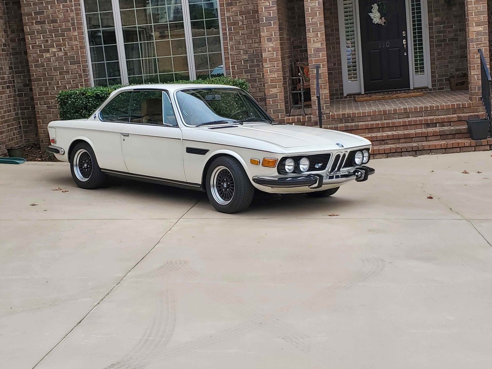

Pretty well. Finally getting back to some car work.
I just finished up installing the new bumper ends to go with the rechromed center, and shined up the car for a little photoshoot. Our community magazine is doing periodic features on the cars owned by folks in the community and they accepted my article. It should run in May. I did a joint thing with my buddy, so the article features two coupes. I probably should post this in the what have you done to your coupe thread!

Looks great Chris. Hope to can come to Big A sometime with it. I have plans for something in the fall. You will see it soon on the email blast from BMW Classics of Georgia.

Chris, Sounds like a great article for Dirk and the CCCA quarterly magazine.
Chris - I sent to you a copy of the article. It is something of a blend between an introduction to the coupe and an introduction to the owners (Tom Baruch's car is also featured), so it may need some tweaking for the CCCA. Check your email.
