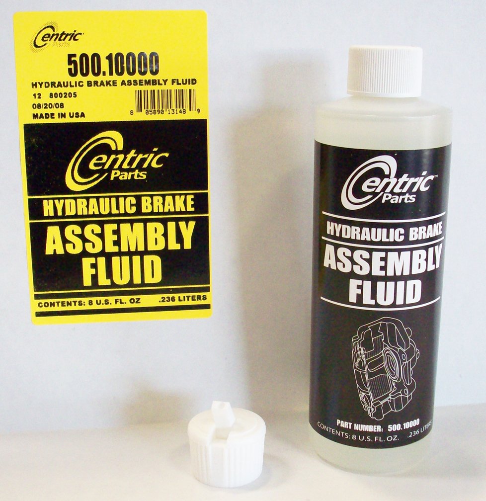

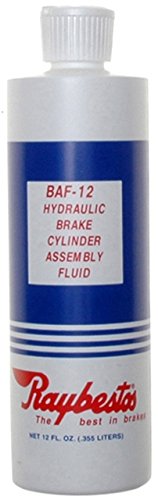

Curious whether those who perform their own hydraulic repairs, e.g., caliper rebuilding, use brake assembly lube fluid or paste? I have often wondered what effect, if any, the paste might have when commingled with brake fluid, prompting some reassemblies using brake fluid alone (without any issues). Paste seems more suitable for pad backings than caliper cylinder walls. :(
