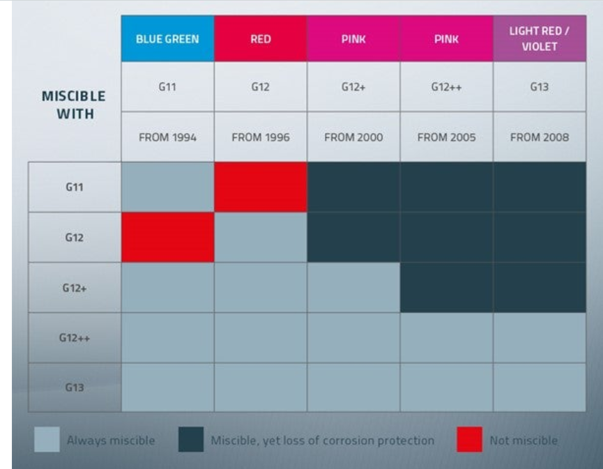

When you choose the coolant, if you have a copper or brass radiator with a cast-iron block, then you need a green or blue G11 coolant. On a more modern car with an aluminum radiator, orange, purple or red G12, and G12 + coolant.
G12 coolant vs G11, G12+, and G13​
The three types of coolant classes, G11, G12 and G13 differ in the types of additives there are used: organic or inorganic
Differences between G12 and G11 coolant​
The G11 coolant is an older coolant class. This one was used on cars manufactured before 1996 with a large volume of the cooling system. G11 is often blue or green. Its boiling point is 105 ° C (221 ° F) and it does not last more than 2 years or 31.000 – 50.000 miles.
G11 contains a small set of inorganic additives, phosphate, and nitrates, and was created using silicate, which covers the inner surface of the system with a protective layer, regardless of the presence of corrosion areas.
Although the G11 coolant protects already existing corrosion from damage, this coolant class has low stability, poor heat transfer, and short service life. After is worn out, the G11 coolant becomes abrasive and can damage the cooling system elements.
Unlike the G12 coolant, G11 is not suitable for cars that have aluminum radiators, because its additives cannot adequately protect this metal at high temperatures.

From producers perspective:
IAT (Inorganic Additive Technology) - old technology not suitable for aluminum but good for copper based (soldered) - should be exchanged every 2 years
OAT (Organic Acid Technology) - can dissolve solder, so it is not suitable for copper - 5 years lifetime
HOAT lub SiOAT - new version combining IAT (silicon) and OAT (organic acids) - pushing out IAT fluids
NMOAT - for industry machines. Typically universal and compatible with most of materials used in heating/cooling installations. 7 years of lifetime
