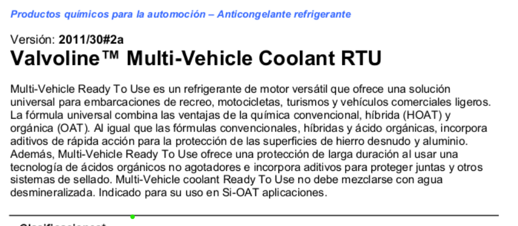

this valvoline is HOAT and can be used in Si-OAT aplications

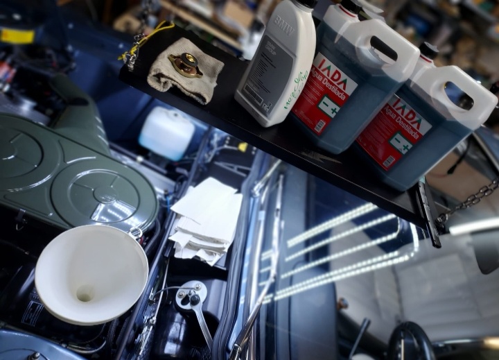

Done....
used bmw 87
mixed at 50% distilled water
;;;_______________________

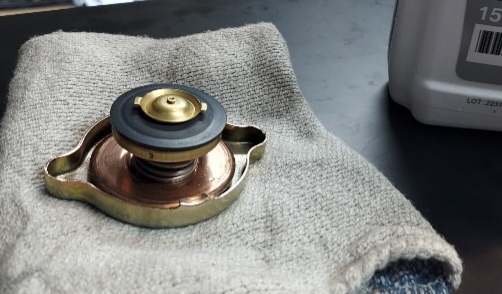

there are few colours for these caps, but as you have not posted a photo i can not tell by the colour
usually a number on it 1.0 BAR means the max pressure; that one is ok
if you take the cap loose with engine warm you are probably not familiar with combustion engines, or you father didnt trained you properly
that is one of the most dangerous things to do in a car, together with filling petrol at night armed with a ligther to aim well to the filling neck
if you did that with engine cold, then you might have a problem
in my experience, a good working engine will increase pressure up to 0,5 or 0,8 bar, and maintain while hot
after stoping engine pressure decreases slowly, and aproximately in an hour returns to zero
the coolant system works at pressure to benefit from higher boiling temps, excessive pressure may mean cyl head damage, low pressure might mean water pump failure
the cap is designed to deal with presure and keep it below 1BAR, if pressure goes higher than that the cap will handle it and throw away coolant
