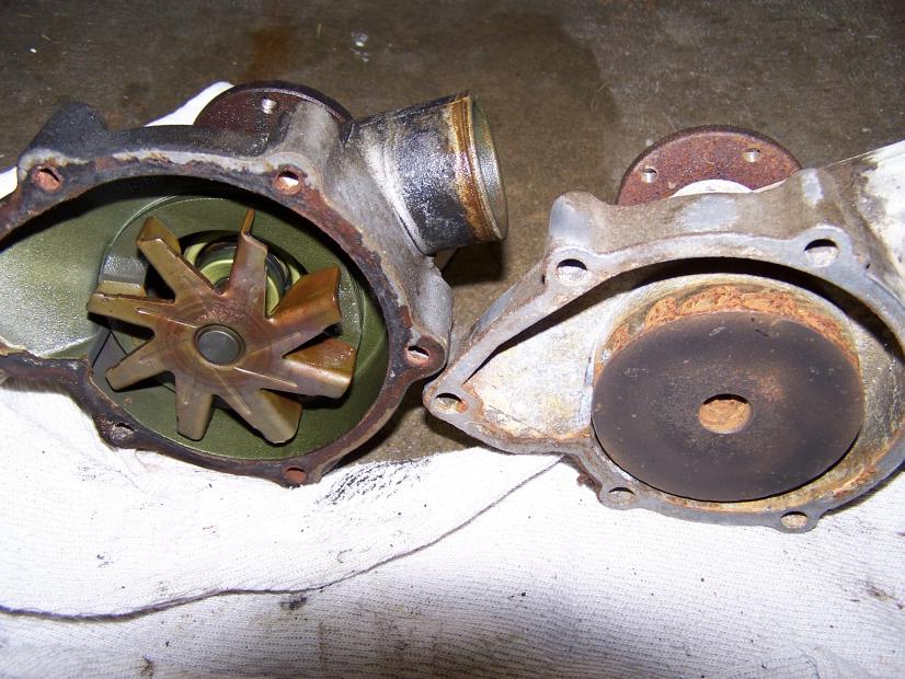

Tearing the front of the car apart due to numerous "weepers" Check out these pic's. I will make no further comment as I seek open minded opinions.

wow I've never seen an alternator fan style as a waterpump and that many holes drilled into a thermostat - one is enough.

I vote the non-alternator style waterpump as best, that alternator style looks sub-par and a lot less efficient. It does looks as if very good coolant was used, no corrosion at all. Bit nasty green but that's probably a good thing! :D

The "swiss cheese" thermostat is a bit of a hoot, lightened for full race! Might as well have run with no thermostat at all. This was in the car from the PO. I do not know what to say as to the water pump. Cheap aftermarket? Tough call as to which design will move more coolant.
