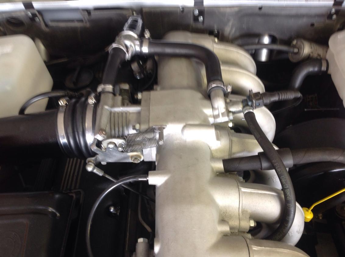

So the old girl spit her guts all over the floor last night, nothing major, seems to have been a rotten rubber hose, smaller dia one that goes from water pump to steel cooling tube under the inlet manifold.
While I was changing this over, I have noticed the Steel cooling tube (no8 on drawing) is knacked (lots of rust)

Its the steel tube that runs down the side of the block under the inlet manifold for those that didn't know what we've been talking about.

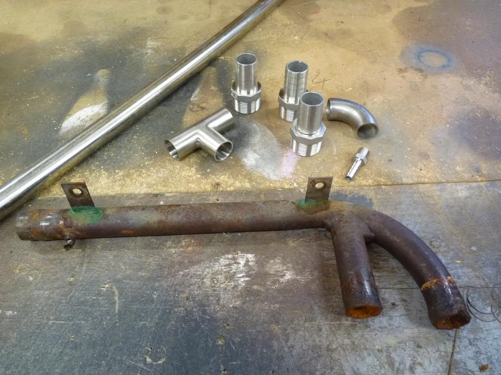

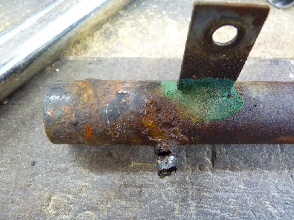

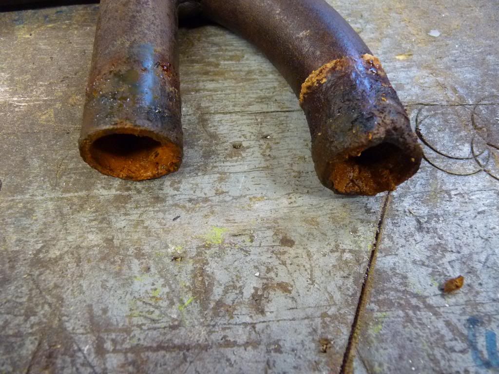

Pretty rusty, and as it turns out, not an original part, was probably home made here in NZ at some stage back in the 80's
http://i152.photobucket.com/albums/s198/kasbatts/P1050974_zps1f604daa.jpg
small tube to cold start just snapped of in my hand when i tried to take the rubber hose of it
http://i152.photobucket.com/albums/s198/kasbatts/P1050973_zps2f250886.jpg

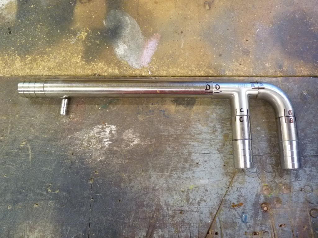

Thought I would make the new one in Stainless, heres the bits I started with
http://i152.photobucket.com/albums/s198/kasbatts/P1050972_zpsdf9f4916.jpg

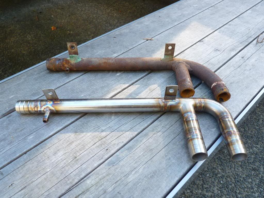

All cut and ready to get welded
http://i152.photobucket.com/albums/s198/kasbatts/P1050975_zpsb74ce385.jpg
Finished item after getting welded up today
http://i152.photobucket.com/albums/s198/kasbatts/P1050976_zps2e35b55d.jpg
Pretty happy with end result, and it cost me about the same as NLA replacement part (approx $105 USD + shipping)
