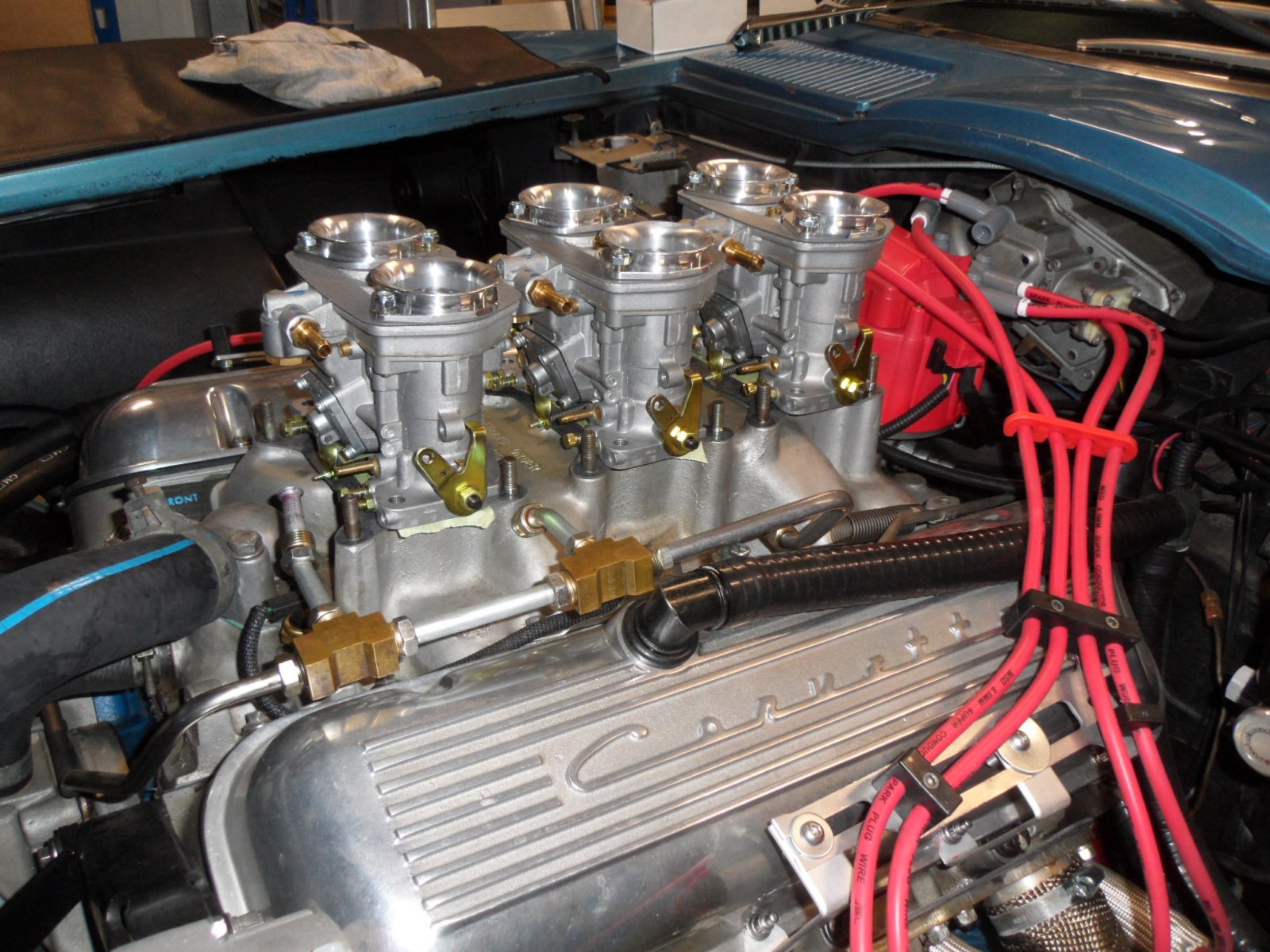

finaly succeeded to tune the tri-power Holley carbs. Have now one smooth acceleration. Only still on the rich side , so now trying smaller jets.
I do understand "at the time" many swapped that tripower for a 4 barrel. Now we have a AFR gauge, dyno etc... which make it more easy to found out what's happening in there..... PITA is one have to demount the carbs for jetting , i'm used to Webers were all can be done from above .....
Last dyno was perfect curve , 465 HP and 805 NM ( 594 ft lb) ... so more then enough to get me in trouble o_O :)
Fun pic what it "could" be with Weber IDF44's.... but they are to high , there is no room for adapter manifolds. One should butcher ( cut&weld) a tripower intake .... but those go $ 2k to 4k .... so not direct a option to have a fun experiment.
