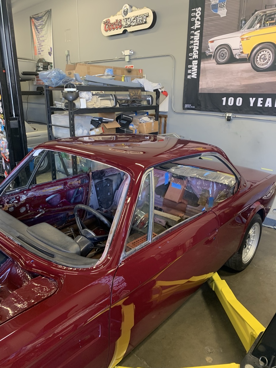

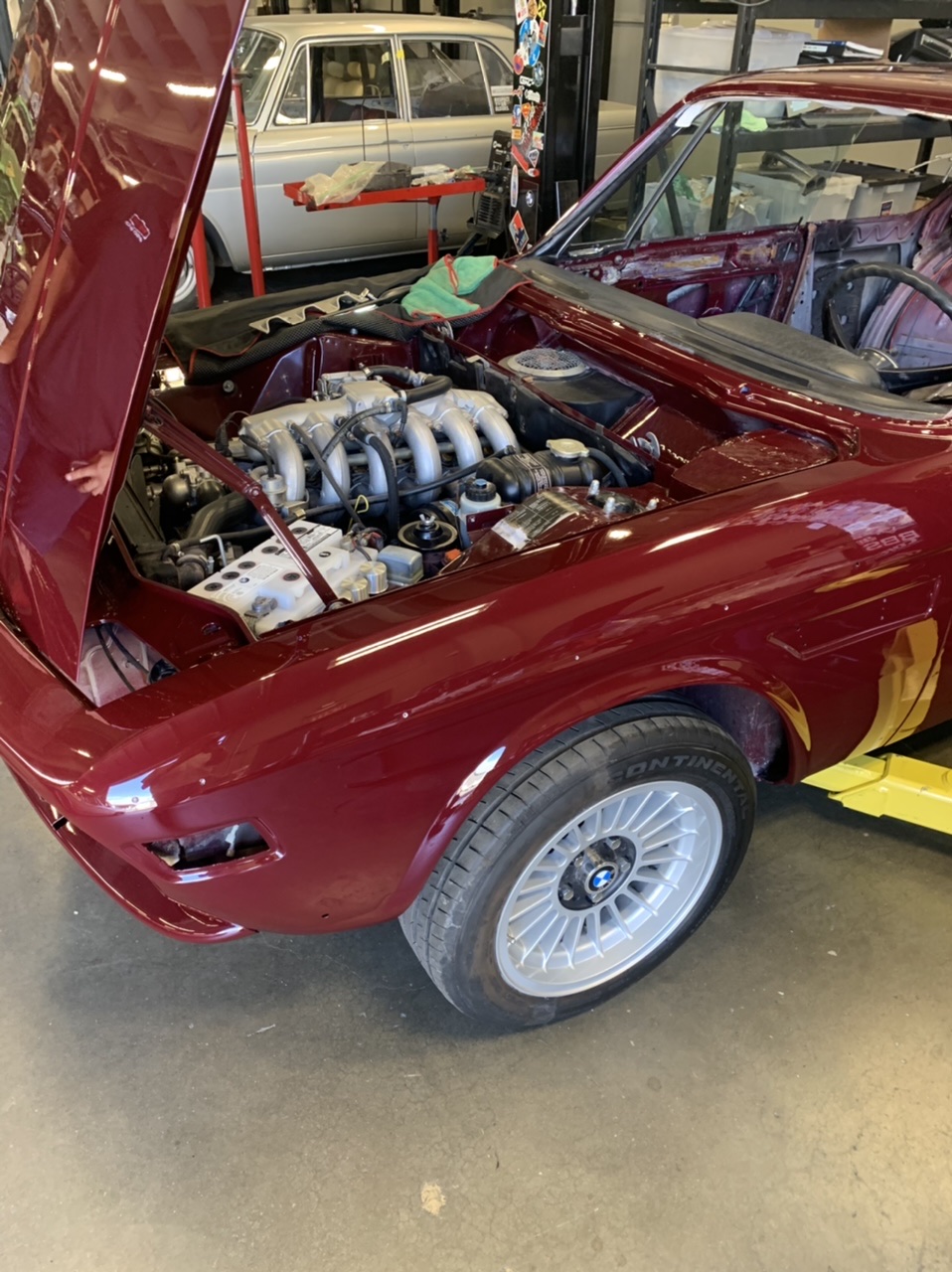

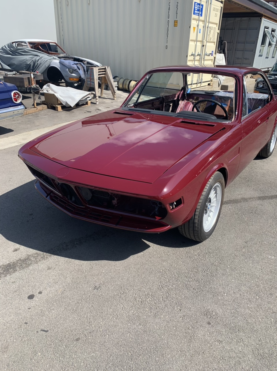

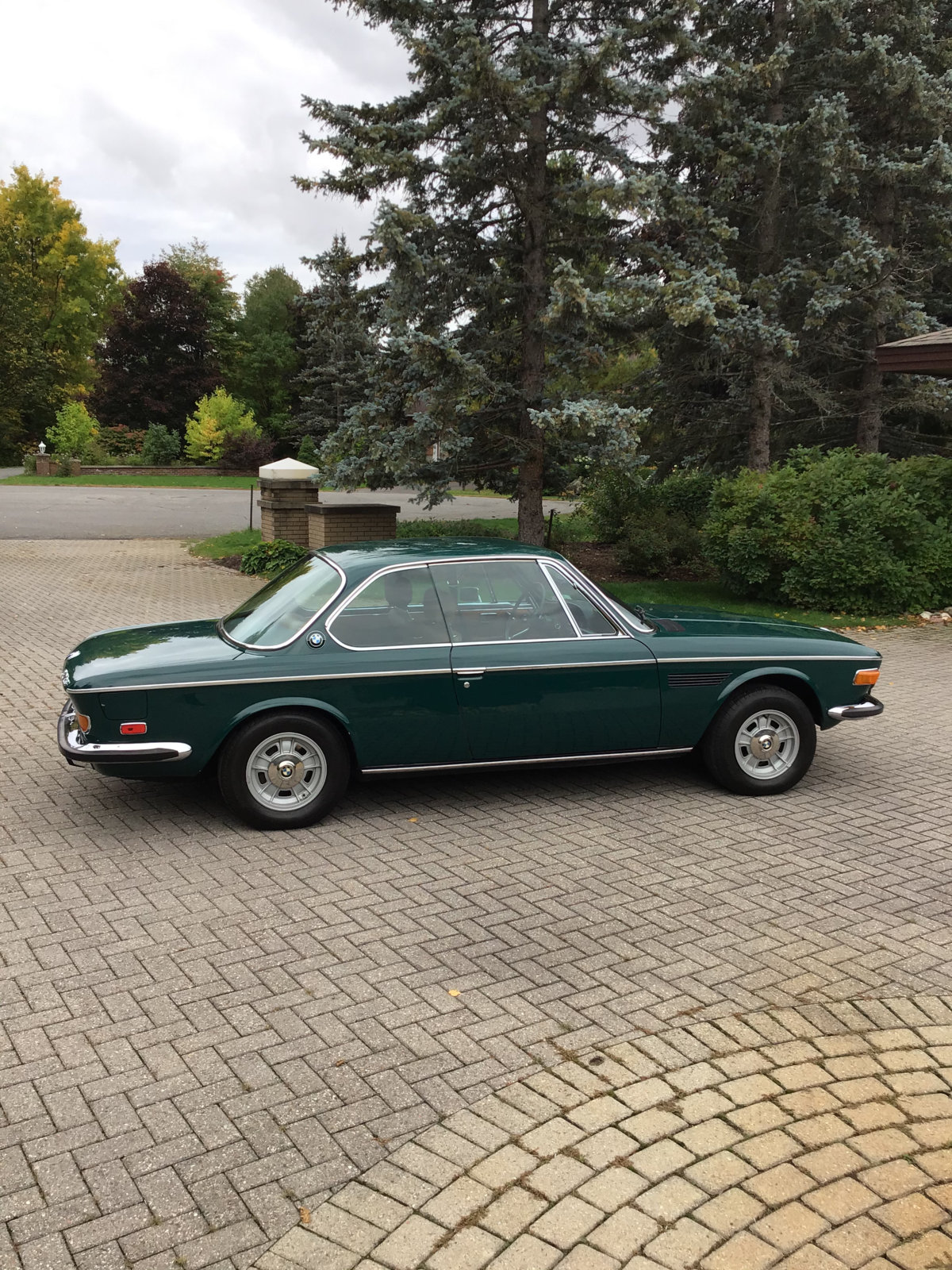

Coupe has been painted
Looks incredible Chris! Are you sure you still need to do a cut and buff? :)

I am going to remove the orange peel in the clear coat by color sanding, I’m not going for a factory orange peel look. After that polish and ceramic to protect it, it is good for five years.

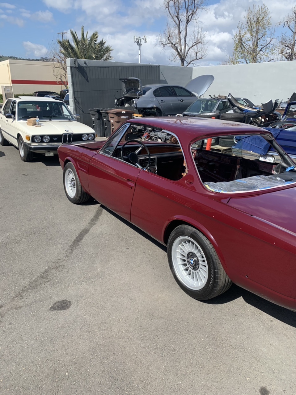

Curious about what it took in approximate time and money to get your car painted. - Did a search, but didn't see any write-ups on the process in recent posts.
I am doing this through a friend. I removed all trim, interior, etc in October and work started on small things which were the main issues for the repaint. It sat for periods of time until priming and blocking began several weeks ago. It was painted at a shop, not where it was prepped and returned on Saturday.
I hear putting on that belt line trim is a tough job. How long do you think it will be until your car is back on the road?

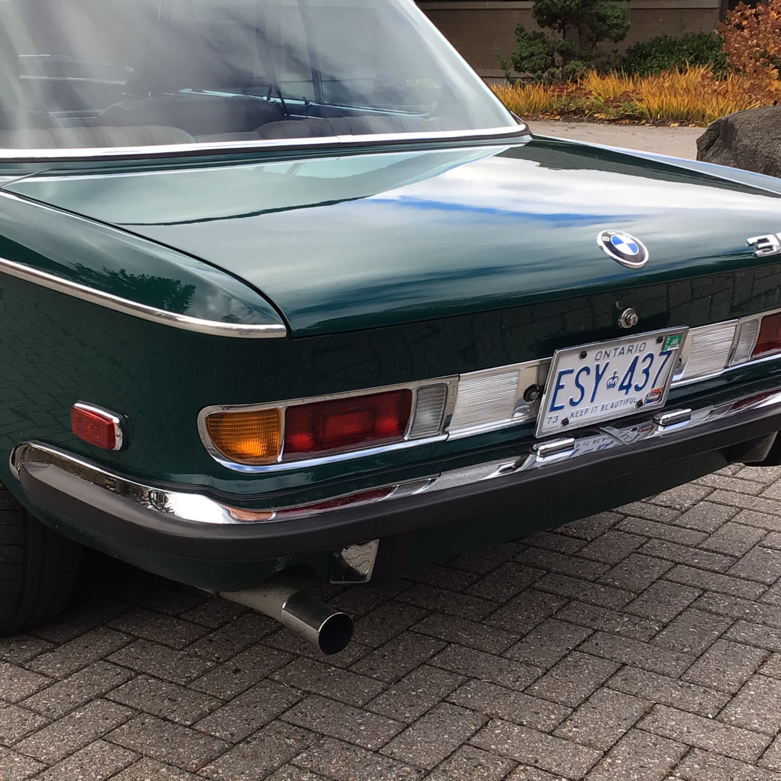

Does this imply that the paint needs to be redone every 5 years? This is my 1990 paint in 2021. Btw, your paint job looks awesome.

Chris, Putting it back on isn’t too hard, the rear quarters being a pain as you have reach past the wheel arches and twist the nut on without dropping it! I will wait two months to make sure paint has hardened.
Ted, I am fortunate to have Rey as a good friend.
John, My paint lasted 14 years and I am very careful with it but improper prep in a few areas caused premature lifting of the paint on the trunk and wheel arches.
