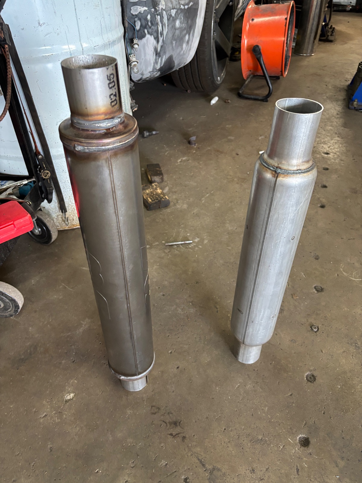

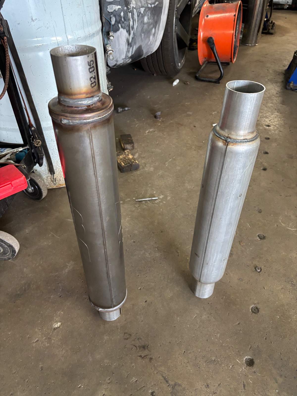

Hey folks, well it took a few years to come back and address my loud exhaust, but I finally found a solution I like. To recap, a few months ago, some of you may recall my tow truck fiasco incident whereby my E9 started to roll off the flatbed because a tie down cable came loose and my car bottomed out on my center resonator which prevented it from careening off the back of the flatbed onto Tom Baruch's driveaway. A pretty cheap crushed resonator as an "emergency brake" was a small price to pay for what could have been $$$ in the frame and body shop!
So I went in to my local custom muffler shop this morning to talk with them about ways to quiet my system but also replace the crushed center resonator with a new Magnaflow piece I just bought. I also wanted to show them Sven's larger rear can solution to see how that would fit and they said no problem to that too. But I'd have to come back with that part at a later time for that switch...

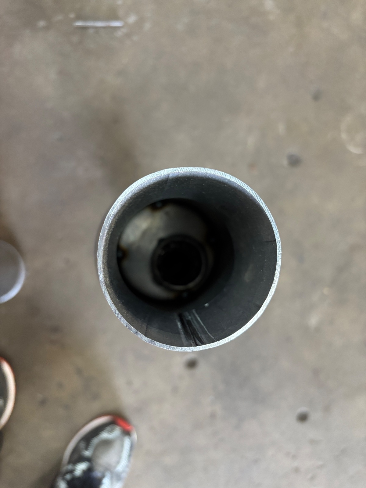

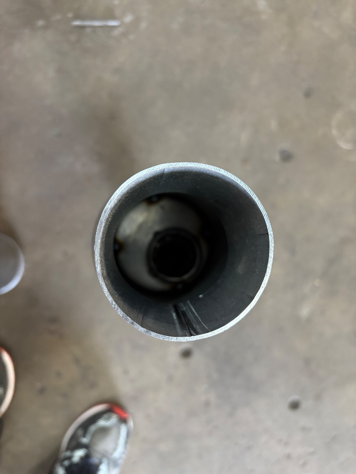

First things first, removing the center resonator to install my new one. They showed me the inside of the Magnaflow resonator which was quite literally a pipe with some perforations in it. The shop told me this is a big part of the noise reduction challenge was simply getting another resonator with more baffling. They had a piece in stock (made by AP Emissions Technology, part #4218113S) and it cost $50. When they showed me the inside of this replacement resonator (see second photo) it was clear there was more sound reduction tech inside including two chambers versus one on the Magnaflow unit. So I okayed the switch to the AP piece and they welded it it. Right away on startup I could tell my exhaust was finally quieter and even more refined sounding! A short test drive showed no difference in acceleration or backpressure issues, plus there was less "crackling" sound off throttle with my Magnaflow unit. The new resonator is 18" long versus the Magnaflow at 22" btw.
I'm going to live with this solution for some time and ponder if I need to go to the next step and adopt Sven's cool solution with the rear can.
But I'm super enthusiastic thus far and my hearing will probably last years longer as a result!
And if anyone needs a brand new Magnaflow center resonator (#10436) I'll be selling that for $75 plus shipping.
