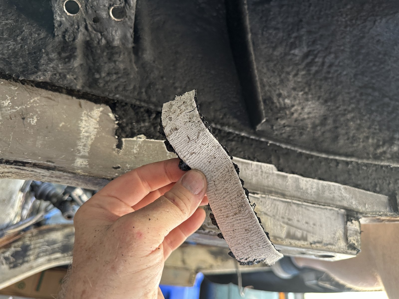

My City Pack (RHD) car had a grey rubber type stuff all underneath it. Car had never been touched before I got it - assuming was OEM.
Have some pics somewhere.
I thought ultralights had some kind of light bedliner that was c=same colour as the body and BATs had something similar but in black.
Happily stand to be corrected.

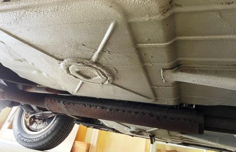

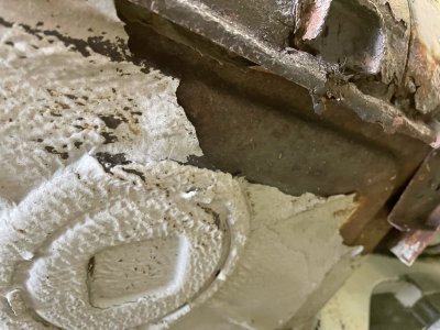

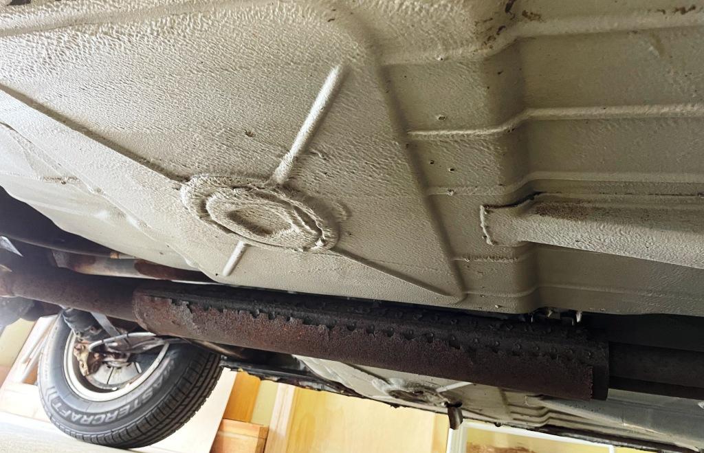

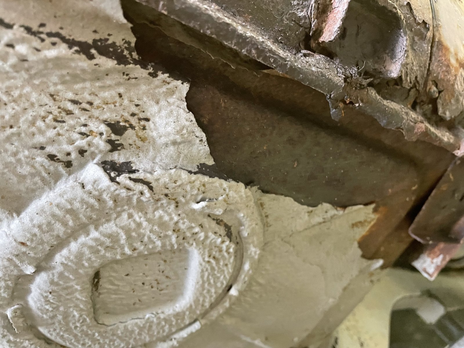

U.S. Market 1974 Coupe with 33k original miles. Patricia Mayer, the one owner car. This is the original stoneguard. On this example it is flat grey.

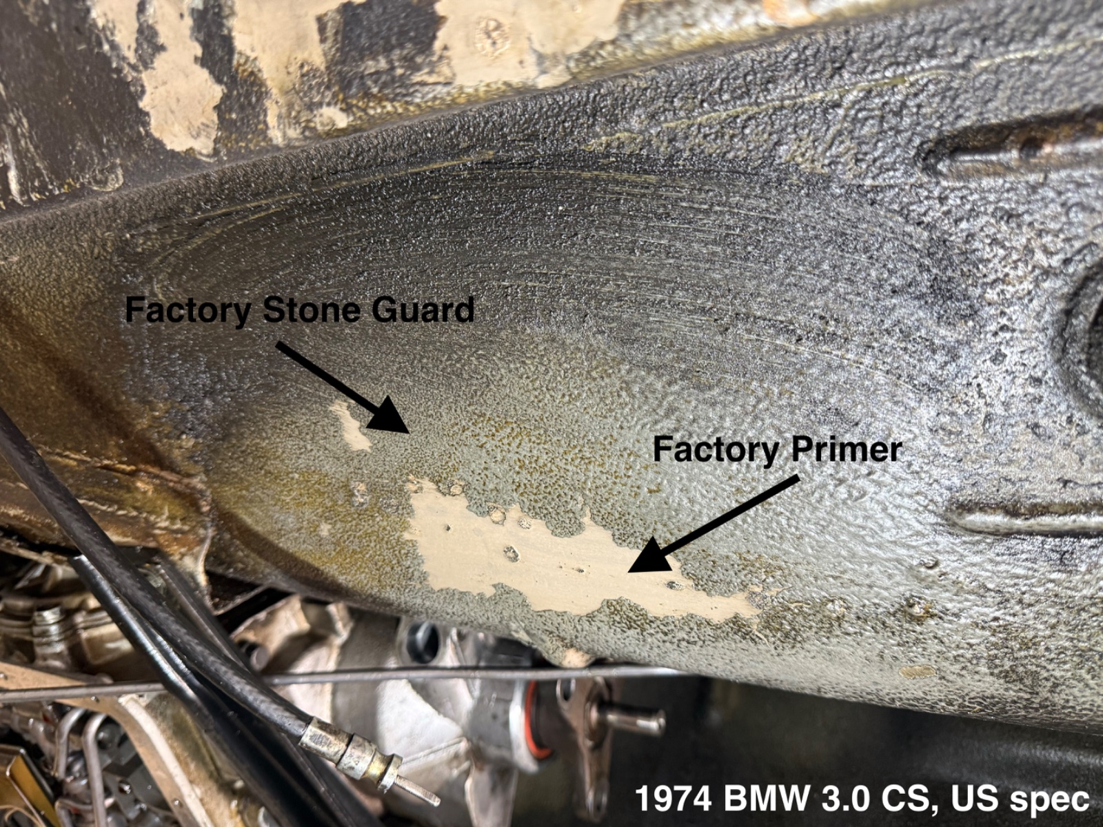

This came off my frame rails when I scraped it to bare metal - light grey rubbery stuff

I think we know for sure what was on US coupes, khaki primer and light grey undercoating. Just not sure if euro coupes got the same application.

My 4/70 2800 CS (2270237) had never been restored or repainted. It has black paint in the wheel wells and it was done before anything was installed on the car including the bumper brackets, any of the clips that hold the wiring harness on the inner fender, any of the grommets for the brake lines or even the subframe. No overspray on anything. The rest of the car (floors, etc) has the normal schutz color. 2270236 was done the same way from the photos I have received of that car.
