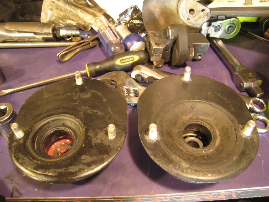

I'm pretty sure some of the newer M cars have offset plates for increased caster from the factory. I think that's an M plate on the left.
