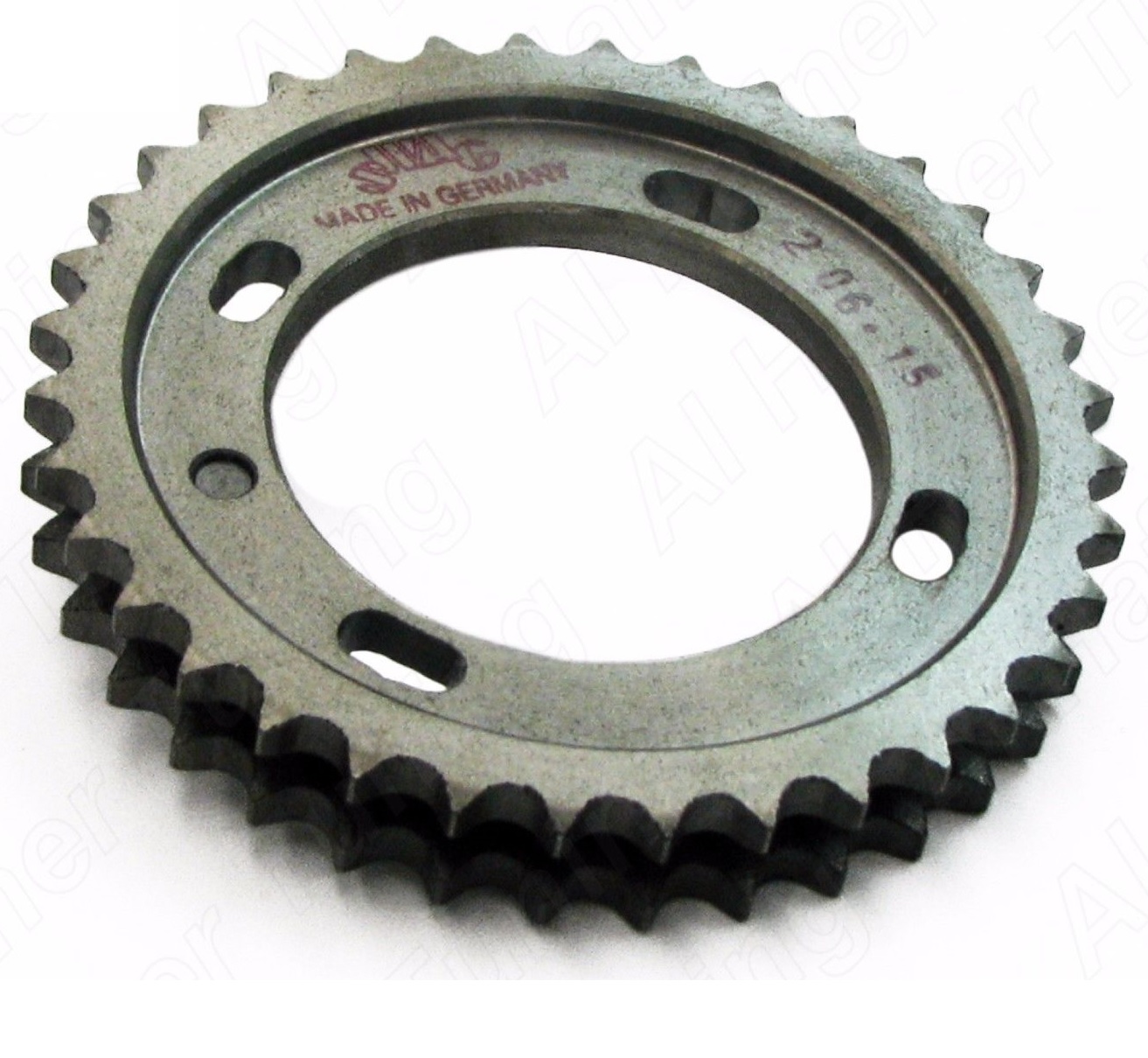

Hey Guys,
wanted to ask if any of you use or used in your M30 an adjustable camshaft sprocket?
Any thoughts are welcome;)

in the pic with with the drilled nut.... this is left hand tread if the markings on the wheel are correct ?
Depends on the cam and on how much the head was cut.
Race cams get slotted gears so you can set the cam timing.
https://www.lunatipower.com/Tech/Cams/HowToDegreeACam.aspx
Camshaft is as above 1257057.1, i don't know how it will finally be with head shaving; as for now it is nominal, but due pretty large aluminium oxydation on the cooling channel of cylinder number two (exhaust side), some welding is currently in process, so i think 0,2mm will be shaved at least.
I was thinking of that new adjustable cam sprocket more as alternative to new oem, as it is actually much cheaper than oem at W&N.
Link to slotted gear please.
Hey Guys,
Yes, I did that. I could set the static timing to what my after market cam was supposed to be at. You'll need a degree wheel and a dial indicator to perform the procedure. Lots of DIY on Youtube and others.
Changing the static timing you can gain or loose torque or HP.
You'll have to have a machinist slot the gear for you. I see Don asking but not sure anyone is making one currently.
Gary
I had my engine long blocked by the machine shop that did all of the machine work. I used a 284 cam and because of this and any past and present head machining and block decking, I did have them use a slotted cam gear. I never did ask them if they needed to use it, but it was there if needed. So to me, over kill never hurts. I bought the gear on one of the E24 forums many years ago and it was a production item not custom but I know many machine shops can do this with out a problem.
36 teeth
Each tooth is 10 degrees
I commonly see 1/2 tooth off on rebuilds
Always indexed clockwise.
Clockwise is good for high rpm but doggy off the line.
A slotted gear lets you correct cam to crank timing
We used one in my b35 and Don had a tool to indicate the start of valve lift on number 1 to set it, I have a Paul Burke N21 cam.
i need to check with Don, not sure that we put one in my car with the schrick 284 ... since the engine is not in the car, perhaps Brendan can put one in before we put the engine in the coupe
It’s a process-
You need to measure diameter of crank hub
Calculate circumference
Convert degrees to distance
Roll to tdc
And on and on.
With a mild cam and decent head and block it’s not a big deal.
Decked block, cut head, aggressive cam- you need slots and a dial indicator.
