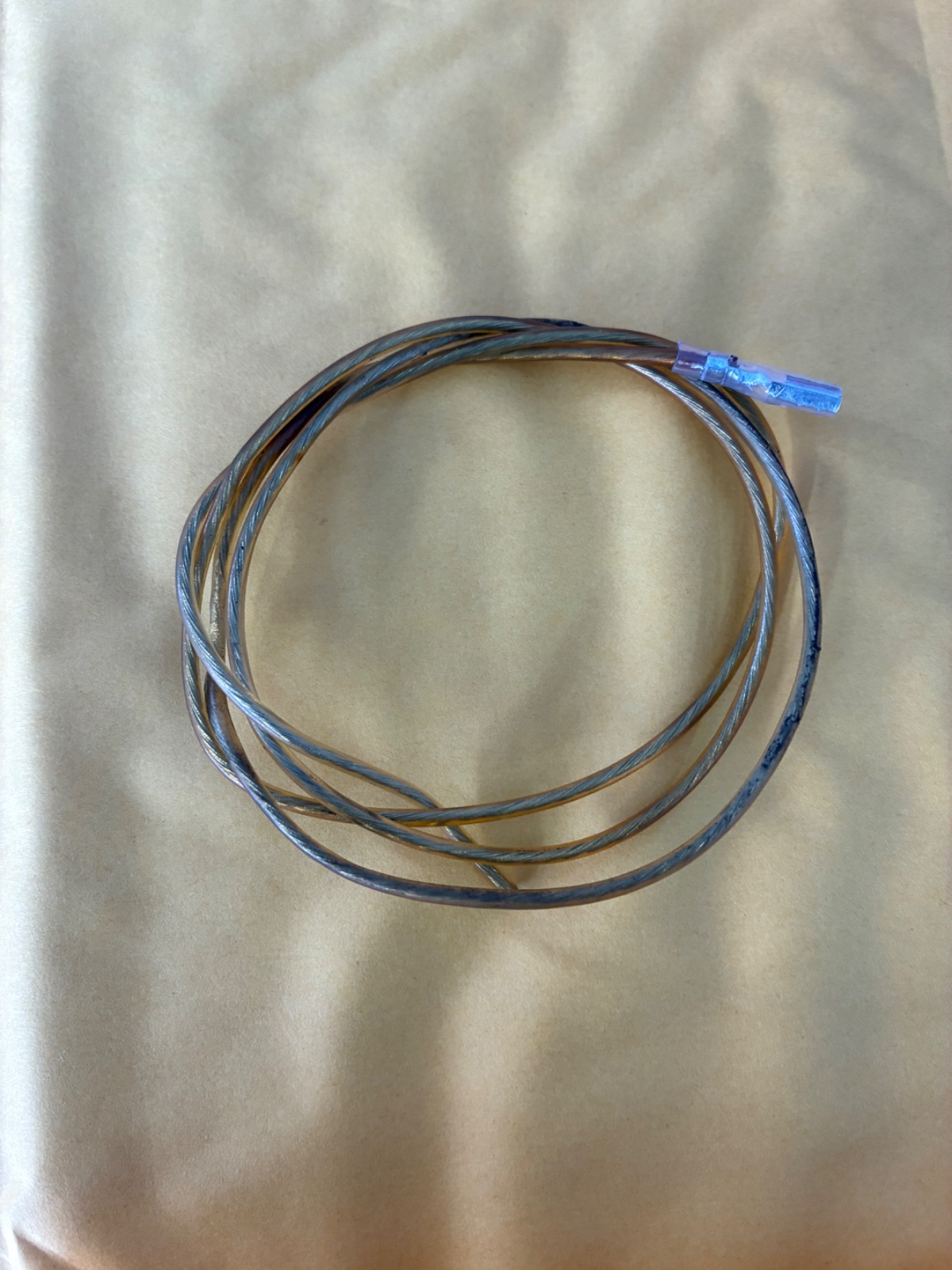

Dropping 3 volts with 0.9 ohms means a current of 3.3 Amps, which means the resistor is dissipating 9.8 watts, so I’d use a 20 watt resistor. Check Digikey or Mouser
You can still buy ballast resistors, the original was 0.9 ohms.

@HB Chris and @ScottAndrews Friends, what an amazing explanation — yes it is a BMW 3.0 CSi VIN 4341353 was manufactured on October 23rd, 1975 and delivered on December 1st, I’m learning so much from you all! That wire is completely burned, so I’ll have to replace it. Do you know where I can find a proper replacement? It really is transparent almost yellowish transparent. And another question: should it then be about one meter in length? Thanks!!!

I’m back in USA on 9th- I will check for a wire for you at Shop

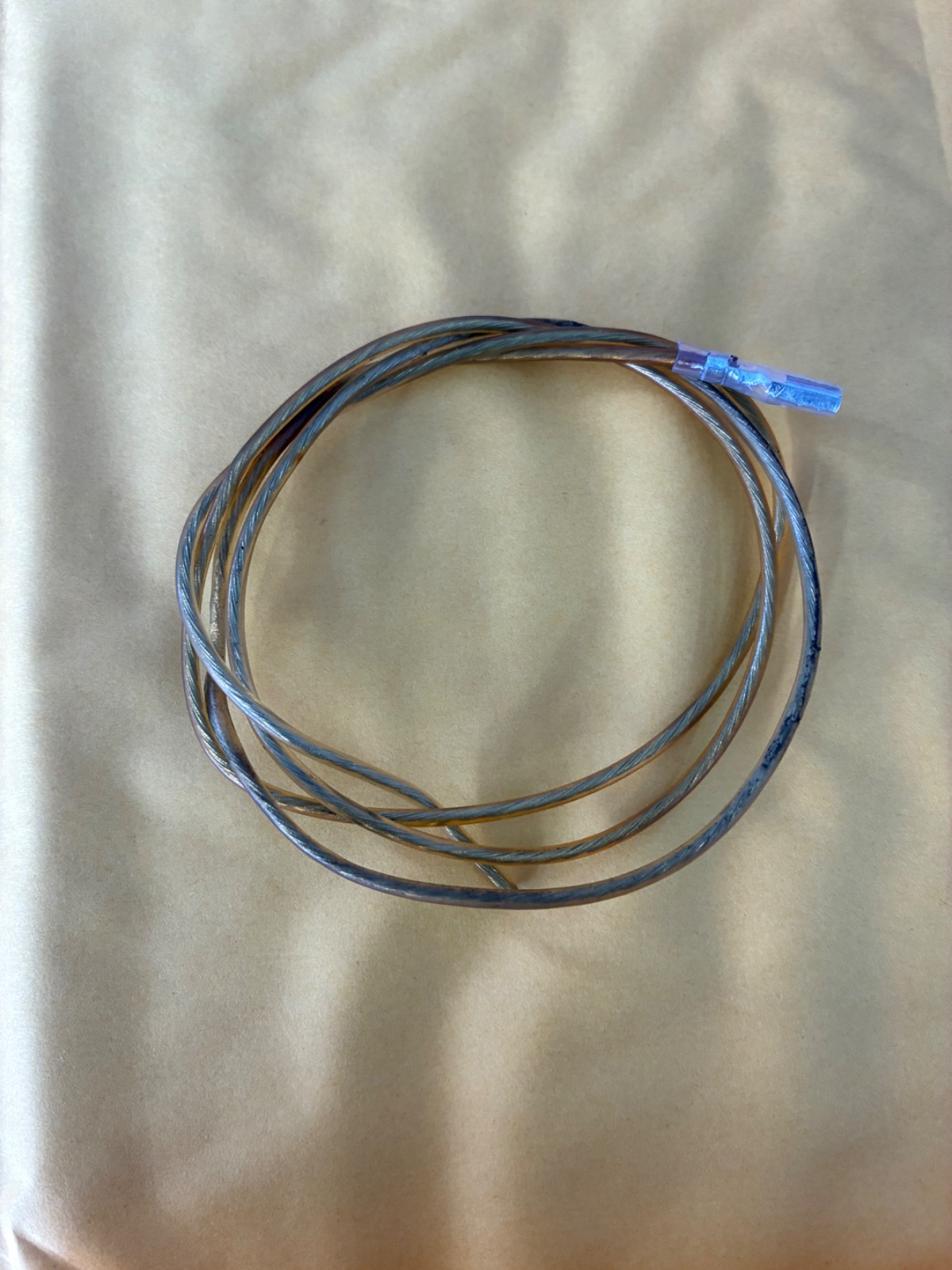

Shipping today
