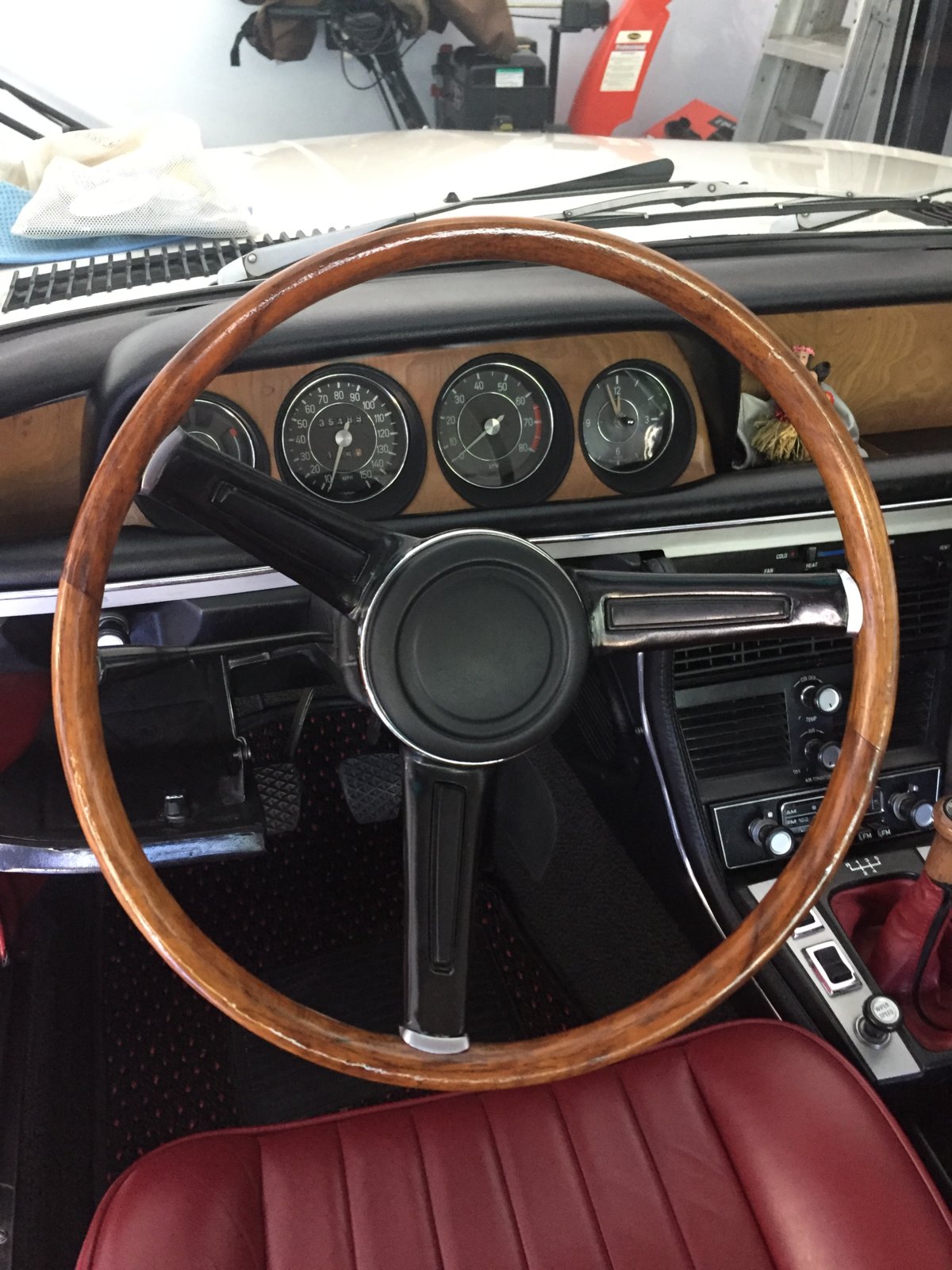

Im restoring 3 wood bus wheels now and find it difficult work. Or im too precise. Or I suck at it.
Indeed the veneer is thin. In some places I think it's less then 1mm thick. Like a kids fingernail thickness.
The veneer is cast over a textile and below that is a black solid material, likely a glue
Also one of the wheels actually has play between the steel ring and the wood. The wood is in one piece but it rotates (clockwise and back) over the ring, and also in forward (car) direction.
Poking inside the wood at the openings near the spokes with a steel wire reveals soft sticky glue. It should be strong, not sticky. Something went wrong there.
I'm getting a third wheel over the coming week that's even worse, split all over.
I never thought of Bela22, but it's a good idea.
I restored one wood bus wheel. After carefully removing all of the dried flaky varnish, I sprayed the wood with the product shown below. Also, filled hairline cracks and repainted the spokes.

I’m going to take a stab at my wood wheel this winter. I think that high gloss is appropriate for the bakelite finish on the wood wheel. What did you use to fill the cracks? I’m leaning towards job weld.
I choose to fill the cracks by first opening them up a bit, making a groove from the crack, and then filling the groove with a 2K epoxy. It sands flat quite evenly, as it has a hardness roughly the same as the (bakelite?) base material.

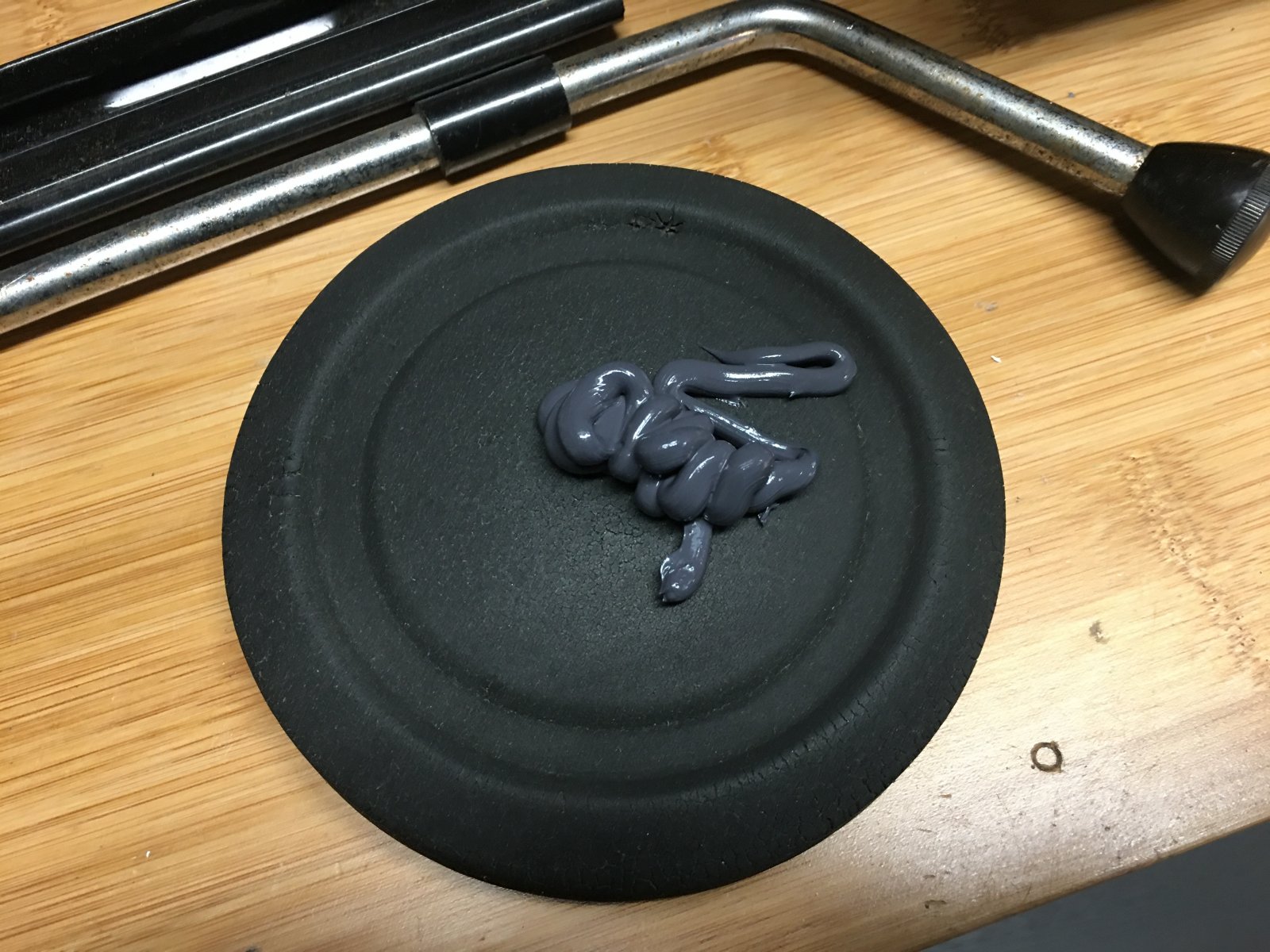

Partially restoring a beat up horn pad.
You can use paintable acrylic caulk to fill any cracks. Caulk shrinks when it dries, so apply multiple coats if you want the completely fill the problem areas. I only applied two coats in a few hours, and it could clearly use one more coat.
Apply liberally, spread around. Work into the cracks, then wipe the excess. Do not use silicone caulk. It isn’t paintable or stainable, and doesn’t really stick to rubber.
I use kiwi shoe dye to darken leather, be it seats, shoes, or steering wheels. I wouldn’t apply the dye to a wheel with nice original patina, but it works great for your e28 wheels, or even factory CS wheels that are beat up, but have no saveable patina. Don’t use it on white stitching. That is a steering wheel collector’s pet peeve. :D
The dye shouldn’t really work on rubber but it can help. You need to let it air dry on the surface. It doesn’t soak in like you see on leather. Vinyl paint is another good, if not better option.
It could be better. I wasn’t trying to fully restore the button. I just wanted to document the process before the wheel changed hands.
