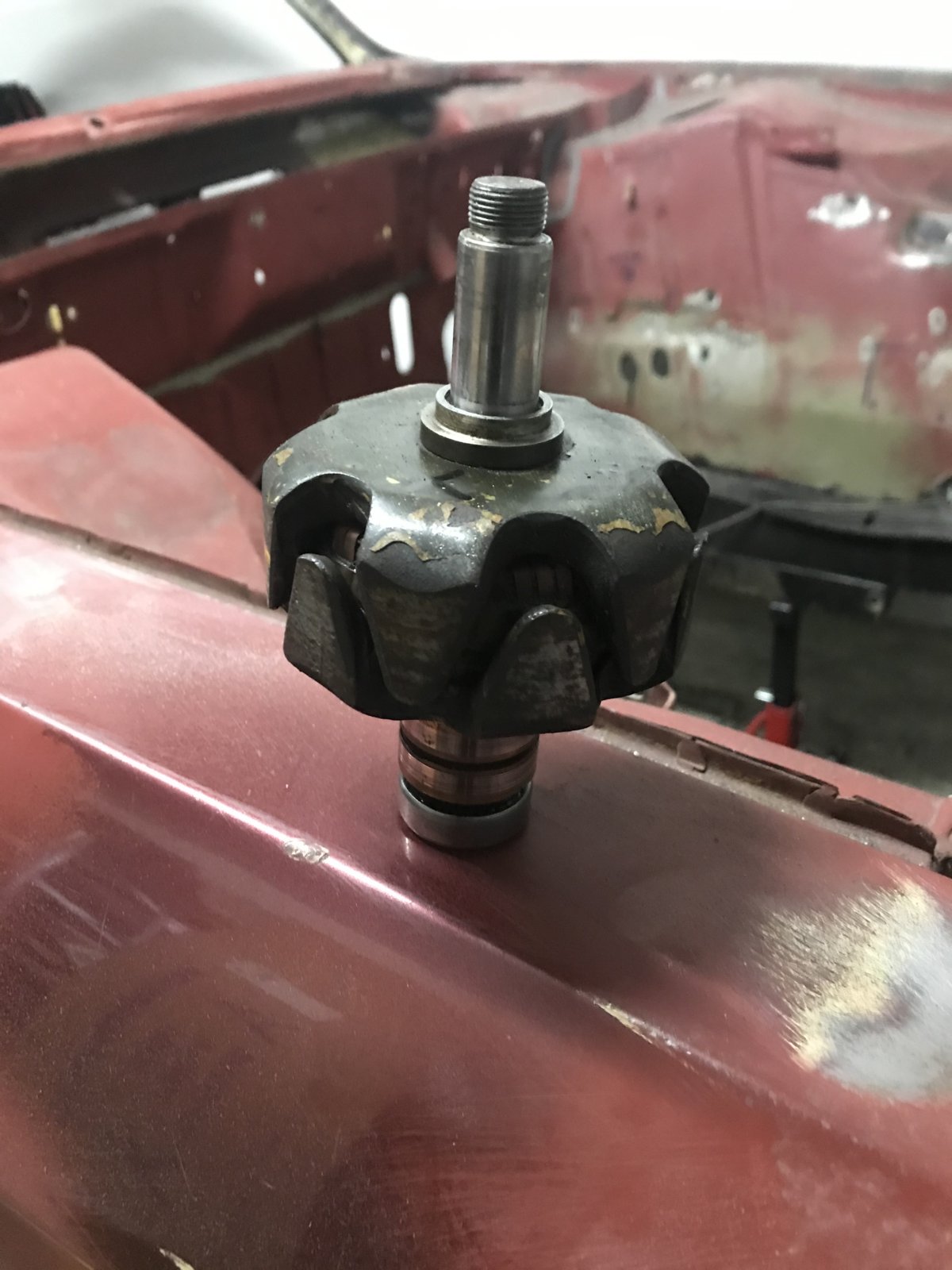

I kept everything 'original', I renewed the wires, put in a new Hella external voltage regulator and brought the dynamo to a specialized company to let it be checked on correct functioning. It appeared that the rotor had an internal short, we replaced the rotor with a rotor of a second (old) dynamo I had. Dynamo is now ok again, and after starting the car with everything new the dashboard light is also gone.. :rolleyes::p

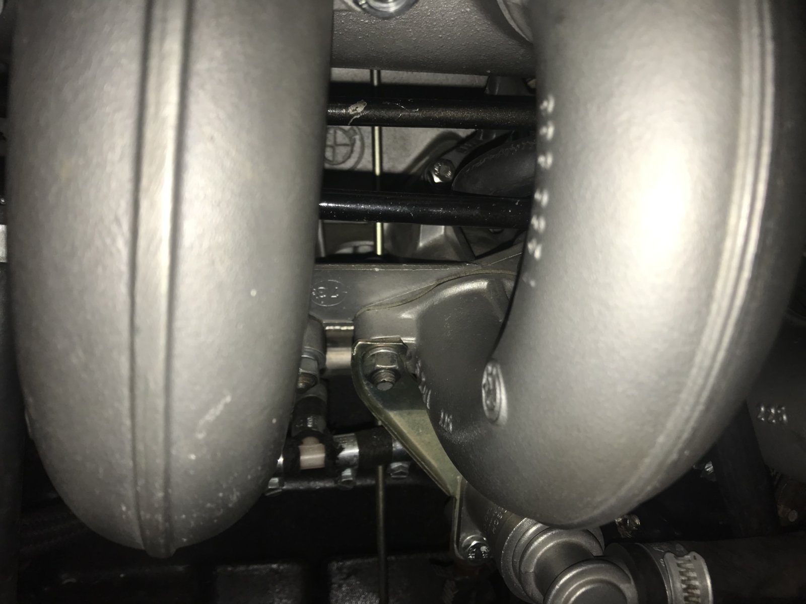

Finally I can comment here that I have found my issue, it is a little bit painful and shameful so to say....

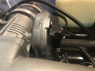

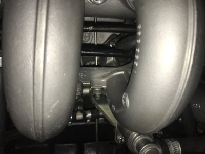

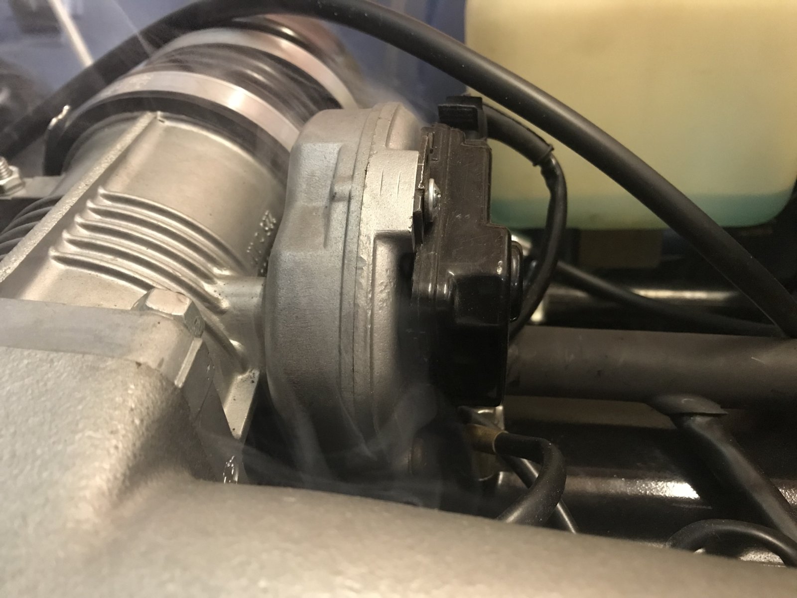

I bought myself the simplest AUTOOL smoker for leak checking and with this I found my problem, it appeared to be that I had a missing gasket on 1 of the air intake tubes, have actually no idea when that happened, but must have overlooked it... :oops:o_O In the picture of the tube I have placed the gasket already, it was the lower gasket from the intake tube were the bracket of the cold start air intake valve is attached to.
What I also found during the smoke test (10-15psi pressure) was that the throttle valve housing was leaking on both sides were the axis of the throttle valve goes through the housing. Need to see what to do with that, new bushes are not available to what I see on W&N and BMW Classic.
Looking back to what I have checked and done over time it was to my opinion the combination of this, an old coil, maybe the ignition pulse indicator and the failing alternator of course which gave a short to my voltage regulator and in the end a low voltage battery.
After the first kilometers test driving I could finally concluded that it is solved, quit a relief! :)
