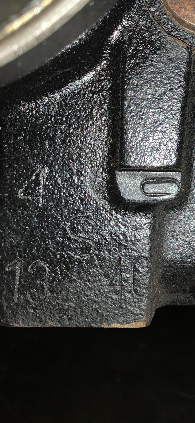

The 3.07 has a resevoir on it as seen from the driver’s side. You can quickly look for that first unless you want to check for an LSD.
That reservoir can be removed with an E9 style aluminum top vent piece. That will make it look like a proper E9 side loader. The only give away is the plugged reservoir return hole in the side.

John - isn't the return hole the same hole we think of as the fill hole?
Diff 13/40 so 3.07 LSD with his 265/5 dogleg. Maybe installed by Art W back in the day.
It’s 3,15 LS but not the way BMW did it (which didnt last very long). Done by my Swiss mechamic who did a lot of work for me. Engine was done in Germany by an ex-Alpina mechanic. A lot of upgrades and improvements make the car extremely tight and it handles like a modern car. The car was good when I got it but now it is exceptional. I had 11 of them at one stage byt have sold 3. (I also have >20 Jaguars from the 50s and 60s, and some of those will have to go as well. Too many to manage.
