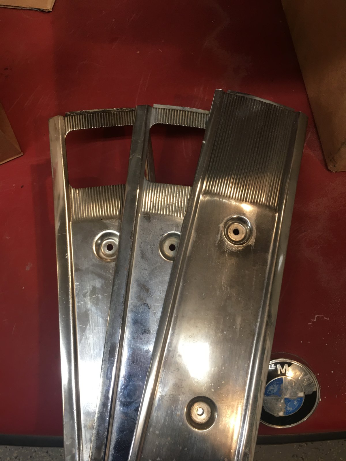

Hi David,
A while back I measured the weight difference between a chrome version and an aluminum version at about 400 grams - under a lb.
The tail panel part numbers appear to carry across all of the CS/CSI models, and the carb CSL. The injected CSL has no crossover indication, but no part number listed, and no annotations. Perhaps your theory about a CSL specific panel is correct. I just don’t see it being more than 50 grams lighter.
BTW - CSL’s did have thinner/lighter glass.
The chromed brass came on the early cars. @HB Chris knows the cutoff date. The chrome ones came with a fog cutout as well.
My chromed brass full weighs 627 grams
My chromed brass cutout weighs 641 grams (go figure)
The aluminum cutout weighs 244 grams
Aluminum, Chrome, Chrome:

Many thanks, Markos - an easy switch to make if cheaper to produce and 400 grams lighter and the tooling is straight forward.
Anyone with an unmolested City Pack CSL who can tell us if they have aluminum or chrome plated alloy?
If more than a few have chrome I will be happy to follow and save some money! Otherwise, if anyone has an aluminum frame without holes (or only holes in the very near centre - pthen lease let me know!)
