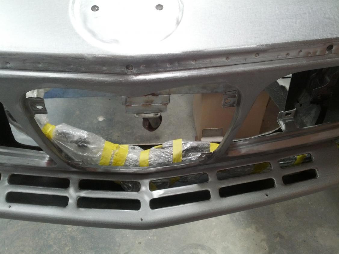

I stripped the body back to bare metal and was very pleased with what was , or was not underneath.
The body shell was beautiful, ZERO , YES ZERO RUST, a couple of bubbles in the left door, so I fitted new W+N alloy door skins L+R , there was a slight scrape on the Left quarter, and a small dent in the Right, otherwise nothing, I have applied epoxy etch primer, and shall begin the paint process.
