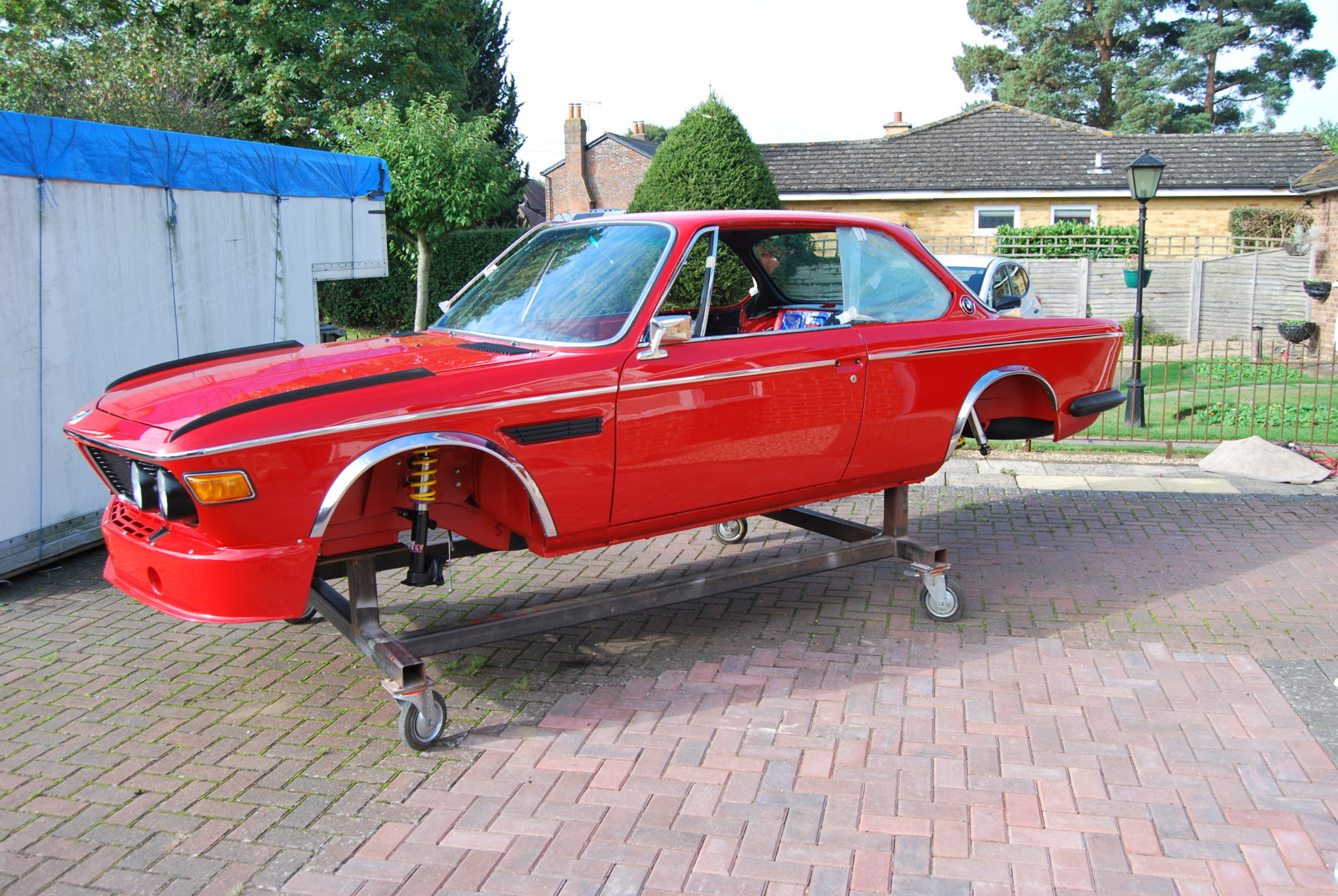

Finally got round to starting the CSL resto mid 2019. Now Sept 2020 and the car actually looks like a car again. Still plenty to do :)

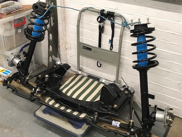

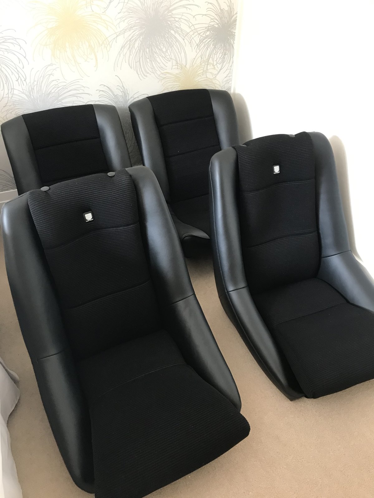

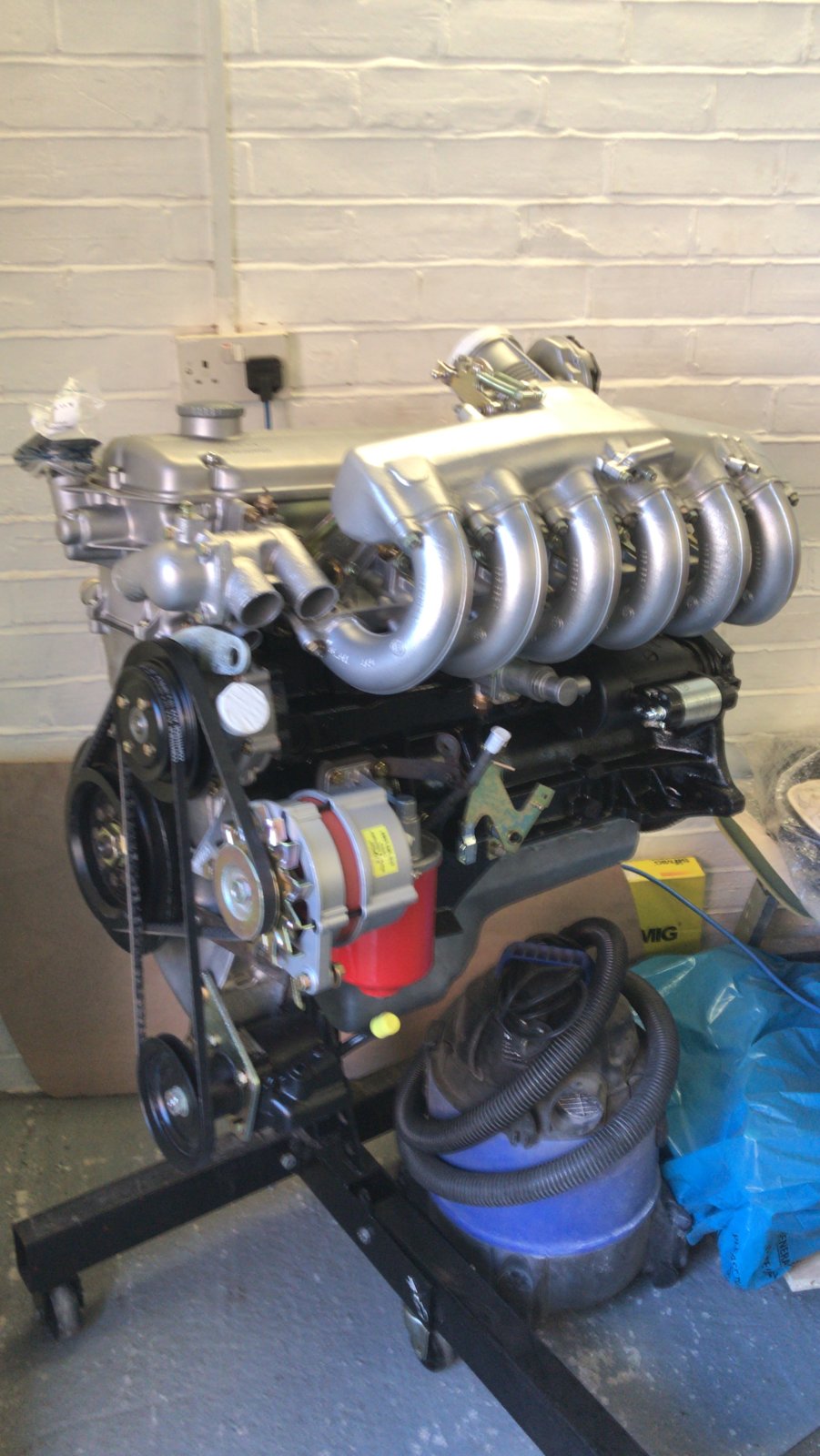

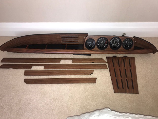

Hopefully trying to get it on the road in 2021. Engine rebuilt, Gearbox rebuilt (265/6 overdrive), rear diff rebuilt, seats re-upholstered, all wood refurbished. new wiring loom. the list goes on. Just got to choose what colour to paint the car, possibly verona red

I’m trying to fire the engine up on a jig but can’t get any voltage at the injectors when cranking the engine over.
i have 12V at pins 16 & 24 on the ECU plug with ignition on and main relay conneted. Earth on pin 11 from the ECU. I have connected cold start relay. TPS and injector trigger units have been refurbished. The only thing I haven’t connected is the fuel pump relay. Can anyone give me some pointers to solve this problem?. Could it be the ECU it’s self if so can it be tested
regards
