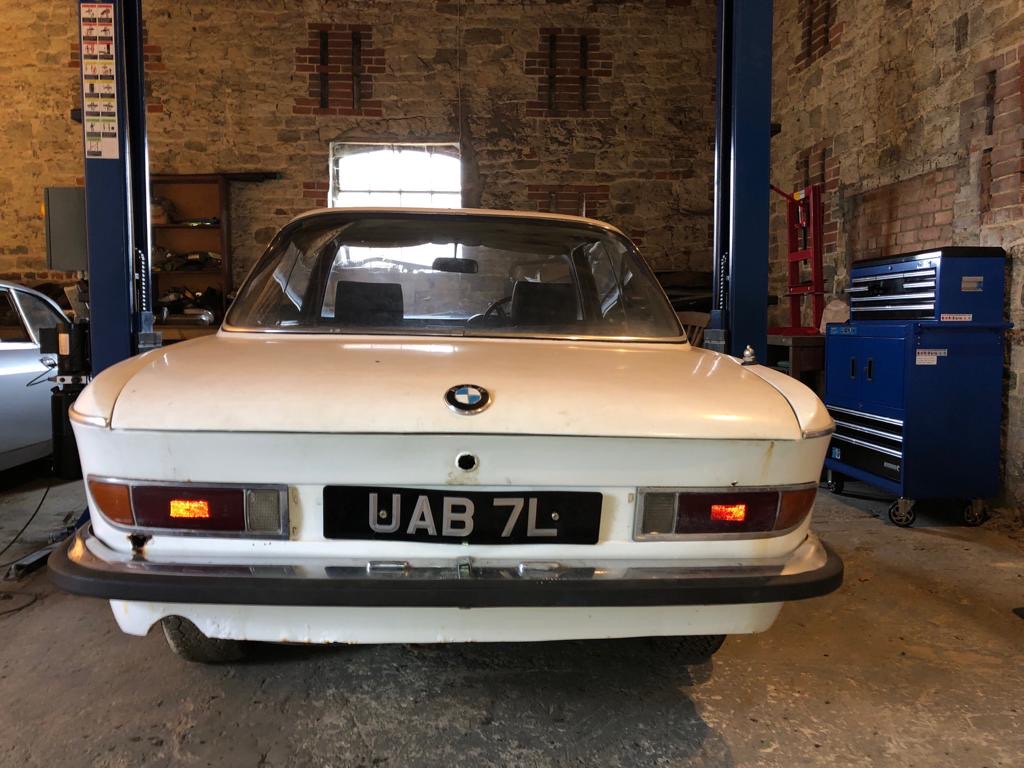

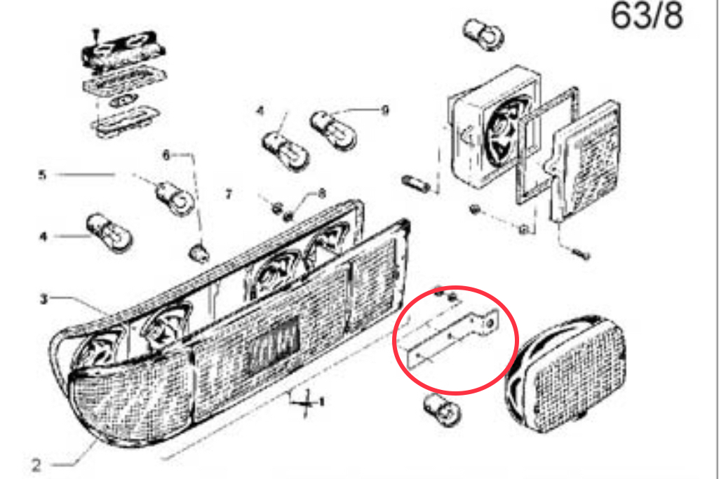

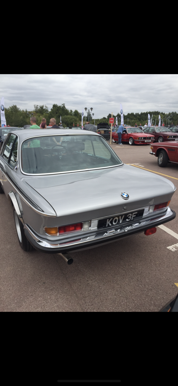

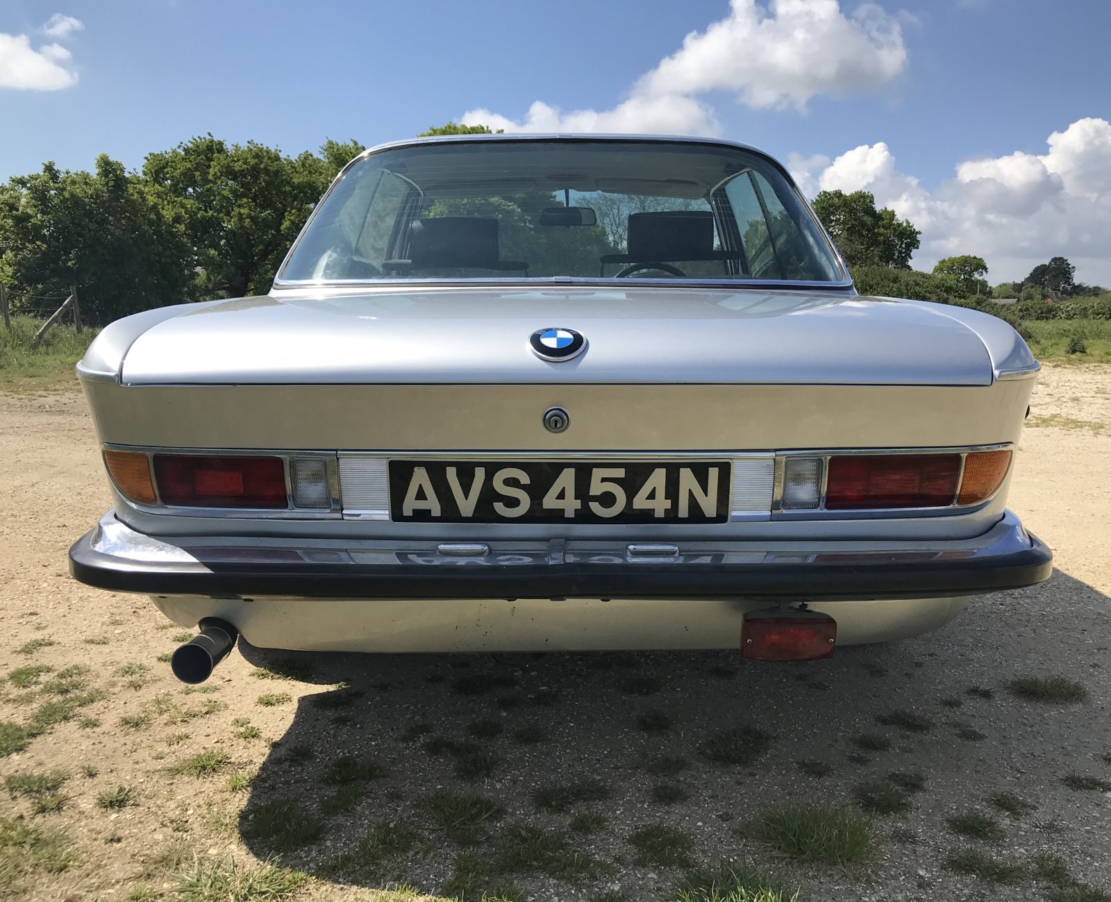

That what Marc assumes is correct. Early 2800‘s and oddly enough, UK Csls often didn’t have the rear inbuilt fog lights, the were attached below the bumper. There is also a particular metal extention that attaches the fog light to the rear valence.... attached pic of a RHD Csl shows the non fog light rear panel....

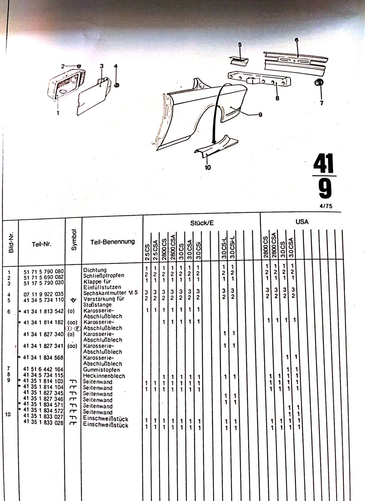

Orange Book:

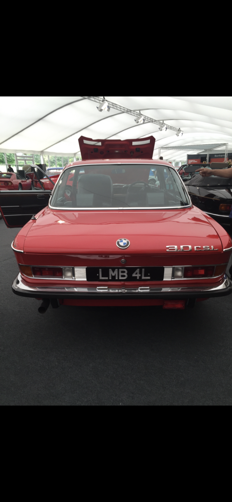

Here is another RHD CSL belongs to @daddywad.....
LHD CSL’s yes....The pic I posted above is from a RHD CSL without the integrated fog light, one of the last 20 RHD CSL‘s.

I think it would be fair to assume that none of the RHD CSL‘s had the integrated fog lights, quite possibly/ surely for the reason that Robert deduced.

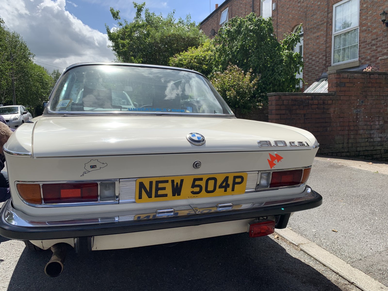

@Michael Kaye does also have the fog under the bumper, on the right side :)
But a quick search on google resulted in a RHD coupe with integrated fog light, but mostly under the bumper on the right side, and the rest without any fog light.
Maybe the one who has the integrated fog was modified at some point?

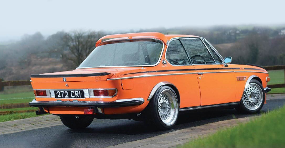

Michael's
Integrated RHD

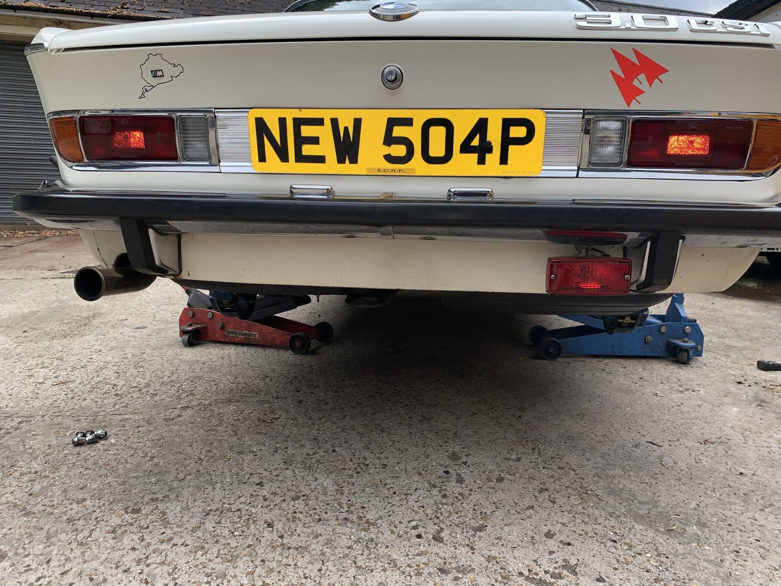

Mine (NEW 504P) has the fog light beneath the bumper on the RHD (I wasn't aware any cars had integrated fog lights - can someone post a clear pic for me?).
Notes : Mine is a 74' Facelift car so not sure that makes a difference (it does have a 5 slat black CSL grill from new!). The first car I tried to buy (WET L00K) seems not to have a rear fog light at all.
