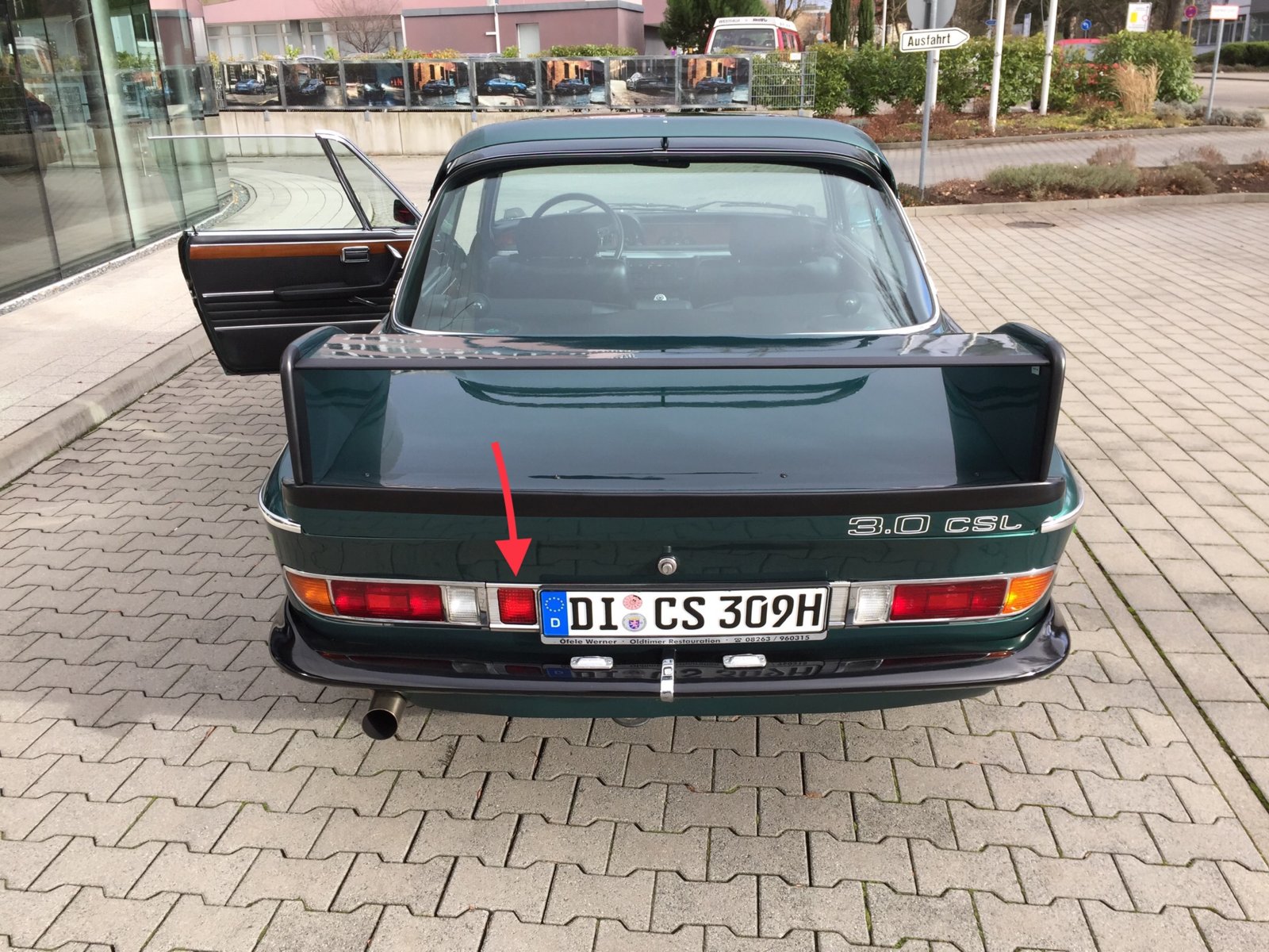

This is what it looks like on LHD cars. The missing integrated fog light on ‘most’ RHD cars is surely due to (as Robert pointed out) it needing to be on the right rear side in countries driving on the right side for which BMW didn’t make the appropriate rear panel

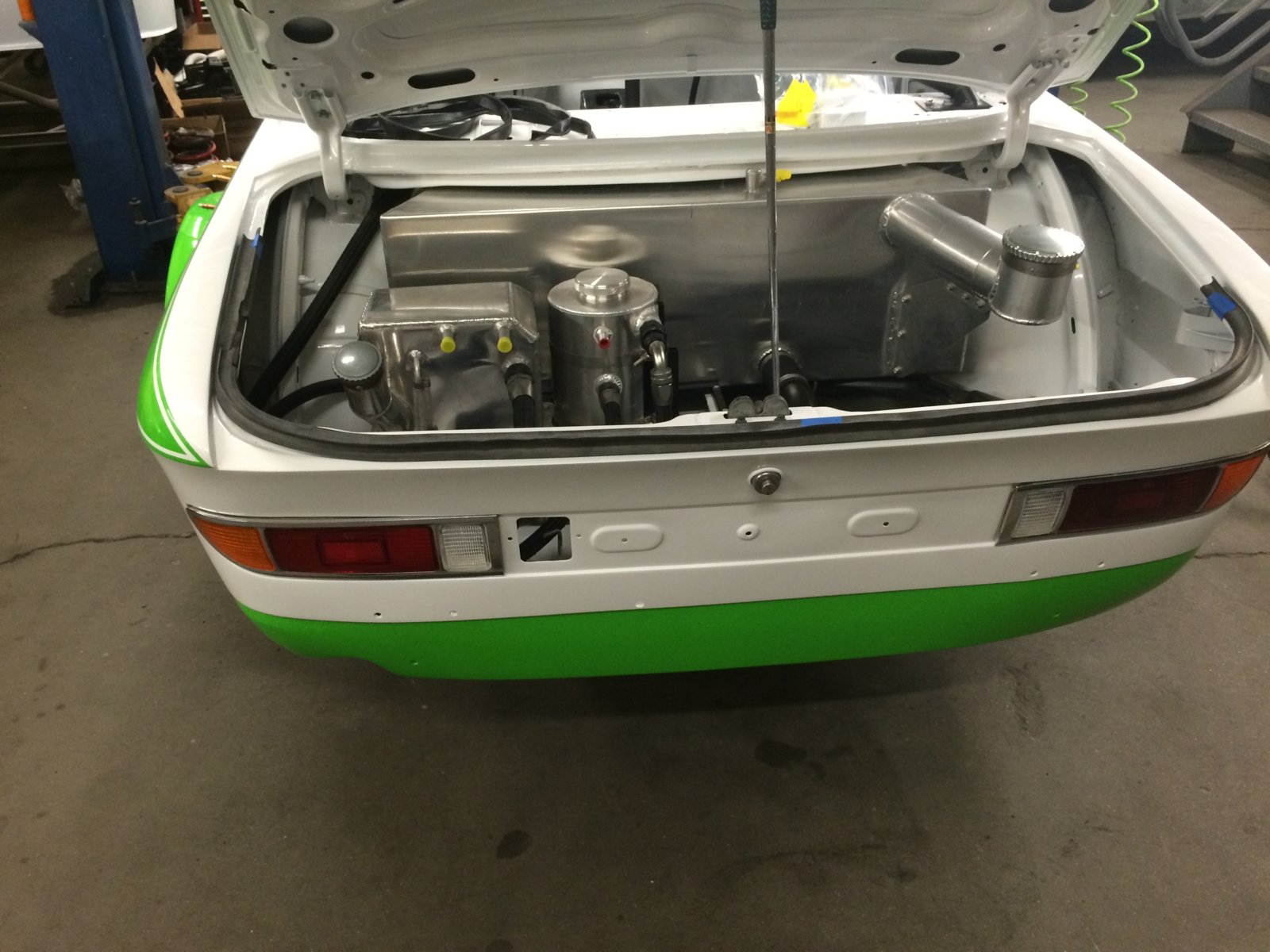

No doubt that the city pack cars got underriders. As seen in the NOS sheetmetal above and on your CSL, one can see that the CSL panels themselves don’t have underrider mounting holes. The holes are actually a good way to determine if a CSL was a city package or if the rear panel was replaced.

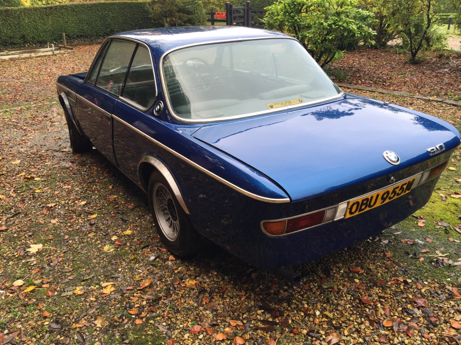

Another example would be this Martini CSL with rear underrider holes:

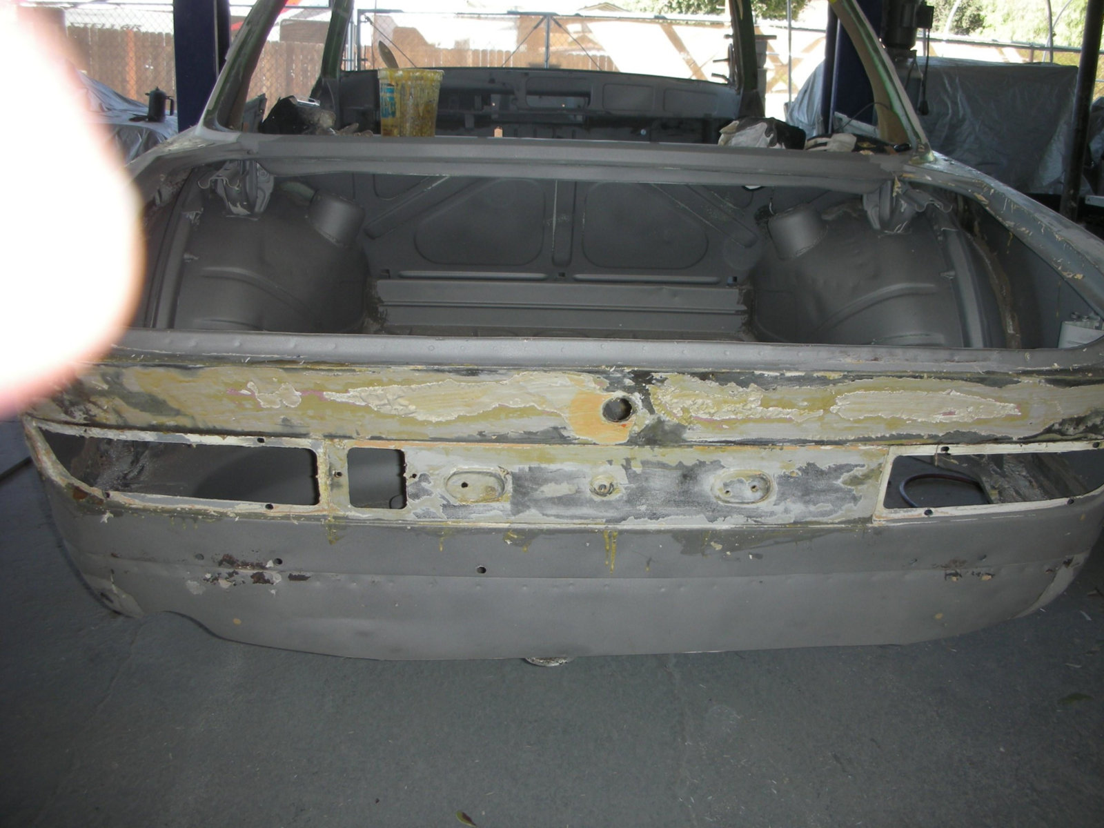

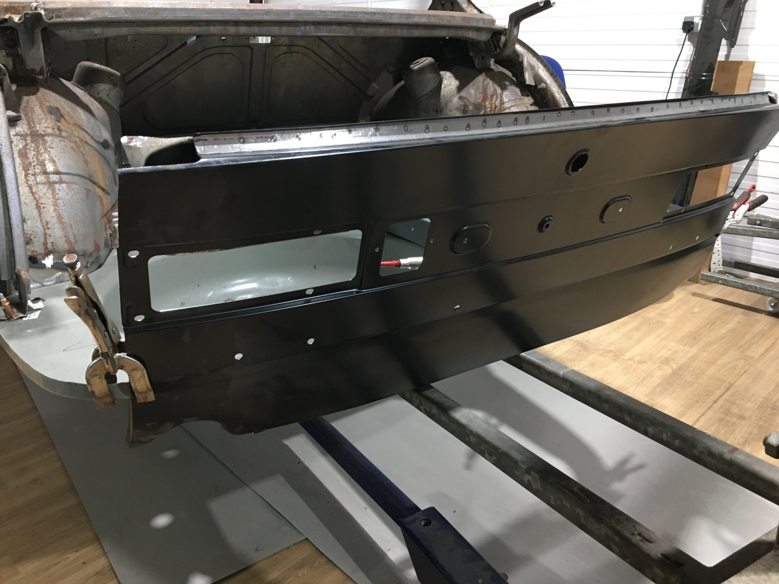

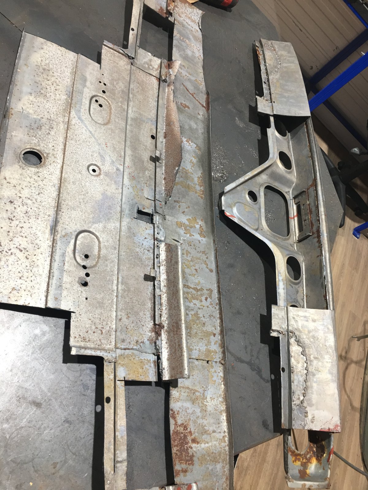

The car when I got it ( full of rust) did not have a rear fog light hole in the rear panel… but the new BMW section in has! – it has only come to light when trial fitting all the trim and that the rear alli cover between the rear lights did not have a hole in it, so I had to weld up the hole…

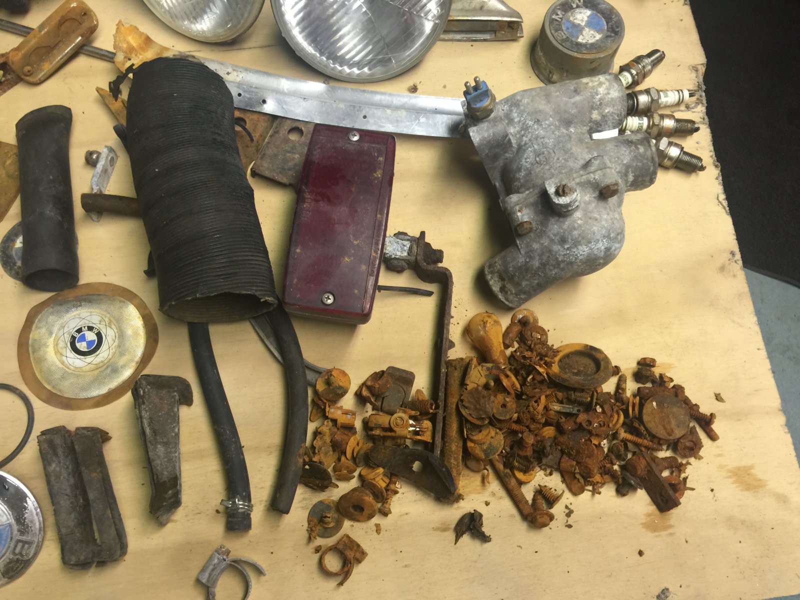

But in the bits, I got with the car came a loose fog light…. also, I have overriders for the rear bumper…
So, looking at all the reply’s – it seams that the RHD have a fog light under the RHS bumper hanging off a bracket and has over riders – but some UK city packs cars have the over riders taken off over the years …… to look faster!
Before resto

bits that came in a bucket with the car - i hope the fog light is the correct one!
the old rear with no fog light hole...
And the new BMW section with a fog light hole... so they must have made 500 special stampings for the rhd cars
Thanks again
Marc
Hi Marc,
the new rear panel is for LHD cars with the integrated fog light for the left side. BMW (obviously) used the early LHD 2800Cs rear panel without the fog light cut out as the fog light must be on the driver side.
And yes, the fog light you've shown with the bracket looks right.
